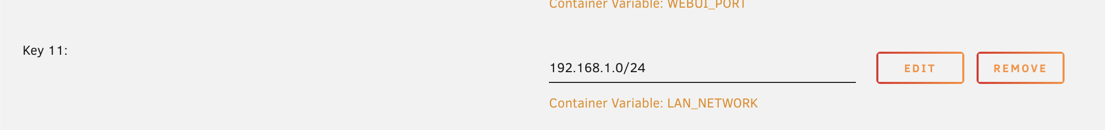

  1. Thank you, currently trying to get it fixed. So am I correct that in addition to the default 192.168.1.0/24, I need the LAN address for the network that my server is connected to (in order to access the unraid UI and the qbittorrent UI)? Or does 192.168.1.0/24 refer to the server's local network? Sorry, I'm relatively new at this.
  2. Is this the setting you are referring to (inside the qbittorrent docker settings)?
  3. I tried switching to wireguard and updated the wireguard conf file to a different endpoint (changed from the Netherlands default), but when I try to access the webUI, the connection times out (it timed out before I changed the default endpoint as well). Currently, I am not on the same network as my server, I am using wireguard hosted on my server to connect to the network my server is on and I can access the unraid webUI but not qbittorrent. Any idea why it might not be working? Thanks.
