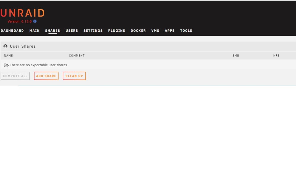

  1. I discovered an error with the disk today, and last week, disk16 and disk14 couldn't be mounted. I suspect that the error occurred after the disk went into sleep mode and then started up again. Could you please provide some suggestions? Attached is the SMART data for the disk. Thank you. tower01-smart-20240126-1551.zip

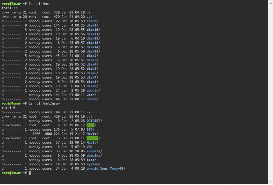

  2. thanks all,it is the permission problems. after changed it ,everything got right
  3. I run the command,and the pic is up there,anyway thanks.
  4. I also suspect it might be a file permission issue.Thanks,how to repair this?

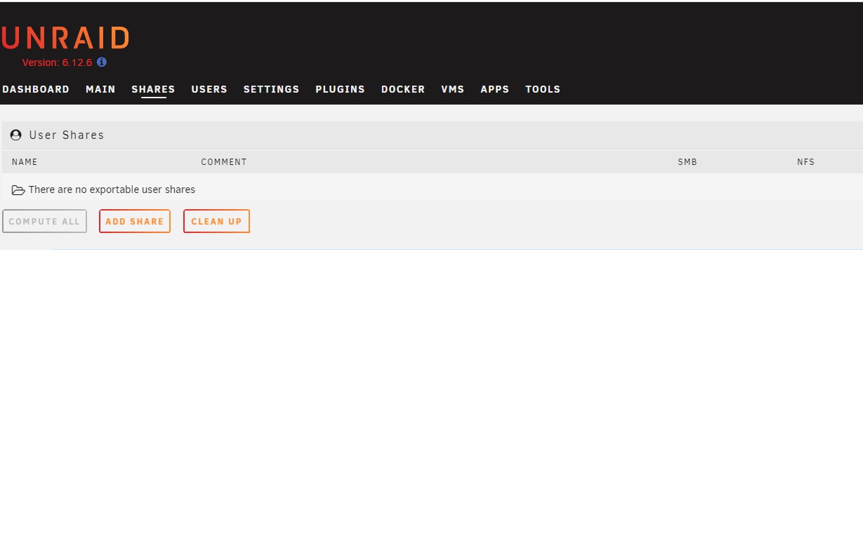

  5. it does not work by rebooting. I did not know what to do, I made a new USB disk, it did not work yet. Share User remained missing
  6. "My Unraid suddenly lost all user shares one day, and I found out that /mnt/user was not mounted. I already have a lot of data in my array. What should I do to make user shares reappear?" tower01-diagnostics-20240121-1633.zip
