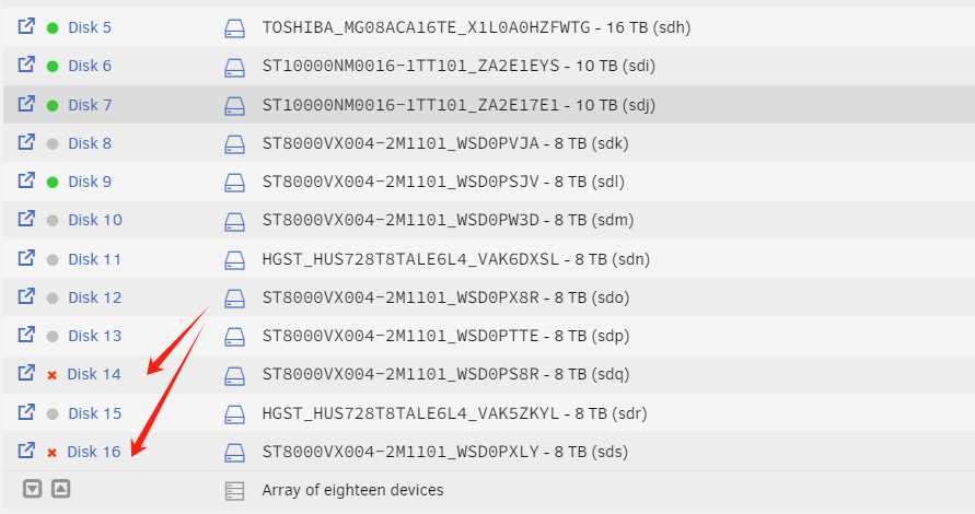

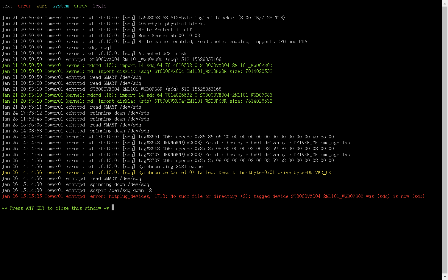

Device is disabled,Disk error occurred, the image is the disk log
I discovered an error with the disk today, and last week, disk16 and disk14 couldn't be mounted. I suspect that the error occurred after the disk went into sleep mode and then started up again. Could you please provide some suggestions? Attached is the SMART data for the disk. Thank you.

Start the array in normal (not maintenance mode) and post new diagnostics.
Diags are after rebooting so we can't see what happened, but the emulated disk is not mounting, check filesystem, run it without -n.
1 hour ago, JorgeB said:
Be sure to run it from the webUI not the command line, capture the output, and post it.
Unrelated, your appdata and system shares have files on the array.
