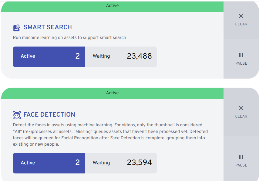

  6. There is running something on my Unraid now, and the sound of Fans is loudly. But the GPU still display nothing . I don't know its reason. eg. the jobs of Immich are running now.

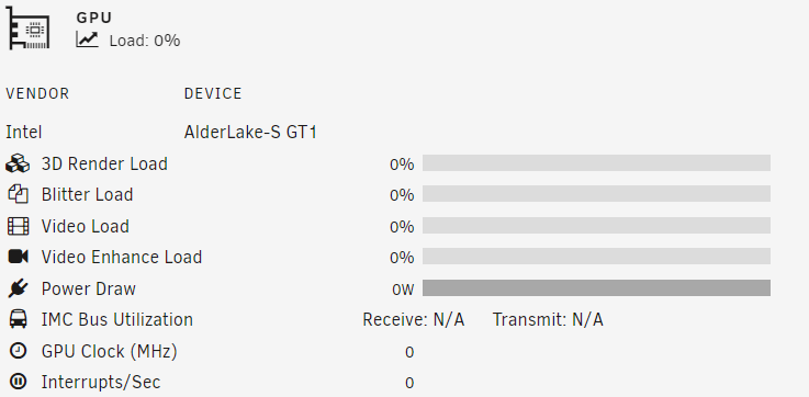

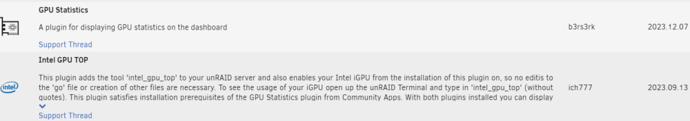

  7. 请大佬支持一下,Intel i5-13600T 已安装GPU statitcs插件,但是,无任何显示,请帮指导。感谢 目前已经开通核显,查询结果如下: 已先后顺序安装了Intel GPU TOP插件和GPU Statistics插件。 但是,GPU的信息一直是空白的,如下:
  8. Maybe your GPU status is normal. It's great that your GPU statistics plugin have already display some information. And the CPU of my unraid is same to you, also 13th Gen Intel® Core™ i5-13600T. But the GPU statistics plugin cannot display anything though I had tried my best. Would you like to help me find where is wrong? Thanks.
