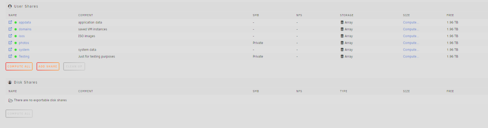

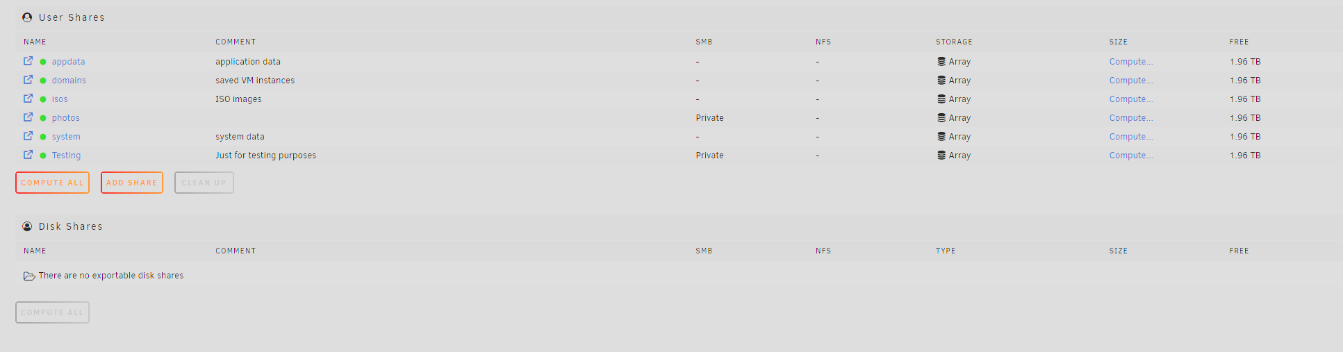

  2. That worked. I'm still wondering why it doesn't show under "Network" in Windows File Explorer after everything we've done, but hey, beggars can't be choosers, right? Frank, thank you so much for both, your help and patience. You got me to a workable spot with the server, THANKS! I have an unrelated question for you. During this whole process, I also consulted with a friend who has more experience than I do with servers in general. He created a "Testing" share. I will like to delete that share. How do I delete shares?

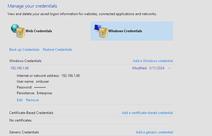

  4. The login I'm referring to, does not have a check box (see below):
  5. Did it already, as per your instructions, but no "handshake"
  6. Most of the directions suggested by the PDFs were previously done. Nonetheless, the major difference is that now I find a link to the server (not it's name, but IP address) under "This PC" on the extreme left column when I open Windows File Explorer. The "handshake" you mentioned is not happening as I need to manually sign into Unraid everytime, but it seems like we are making strides!!

  8. Ok, took care of the first item by switching "Export" to "No" for the appdata share. Correct? Regarding the second item. I do have Dynamix File Manager, but not really sure what you meant. Do you mean I don't need to have the File Explorer visibility? If so, how do I go about accessing server files from other devices in the network?
