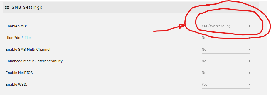

Are you using Active Directory on your network?  Assuming you're not, then go to Settings, SMB settings and set enable SMB to be Yes (Workgroup)
Yes, the enabling of SMB was done from Frank1940's original instructions, thanks though.
Just to be sure. This is the 'Enable' setting that @Squid was referring to---
Yes, it is set to Yes (Workgroup) as you originally instructed.

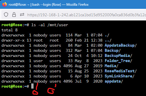

When you can use the GUI terminal to run the following command and see who the owner and group are for each directory:
I have marked the owner 'O'  and the group 'G' for you.  (The owner is not as important as the group...)  Note that each of the named directories is also the name of a Share.   The permission for each directory is in the string at the beginning of each line--  drwxrwxrwx
Look at the following:
The owner of "Administrator"   and the group of "Domain Users' is highly suggestive of an Microsoft's Active Directory configuration.  You can correct this situation by running

First of all, thanks for taking the time to help me with this. I ran the command as suggested above and the main difference I noticed was that where your script shows "total 8" mine says "total 0"
After that the lines do look similar with "nobody" in all of the owner spaces (with the exception of the one "root") and "users" on the group spaces (with the exception of the one "root"). Also different from your script I don't have any instances of "user" as owner.

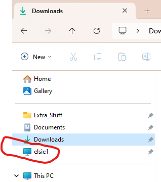

I did everything as per the description in the included thread. The one issue I still had was with including the server in the Neighborhood Network (following the "Unraid & Windows 10 SMB Setup" instructions) because the Windows File Explorer can't find it. Whenever I try to address the server using "// or \\" it does not recognize the address.
Is that using its name or its IP address?
It has been while trying to use the server's name, not the IP address. The IP address was good to allow me to setup and manage the server, but I haven't been able to make the server visible to my PC or my wife's Mac regardless of which one I use (IP address or server name). This has been the problem since the start. Now, from what I've gathered by Frank1940's reaction to the latest system log, we have corrected a bunch of other issues but the server visibility problem remains.

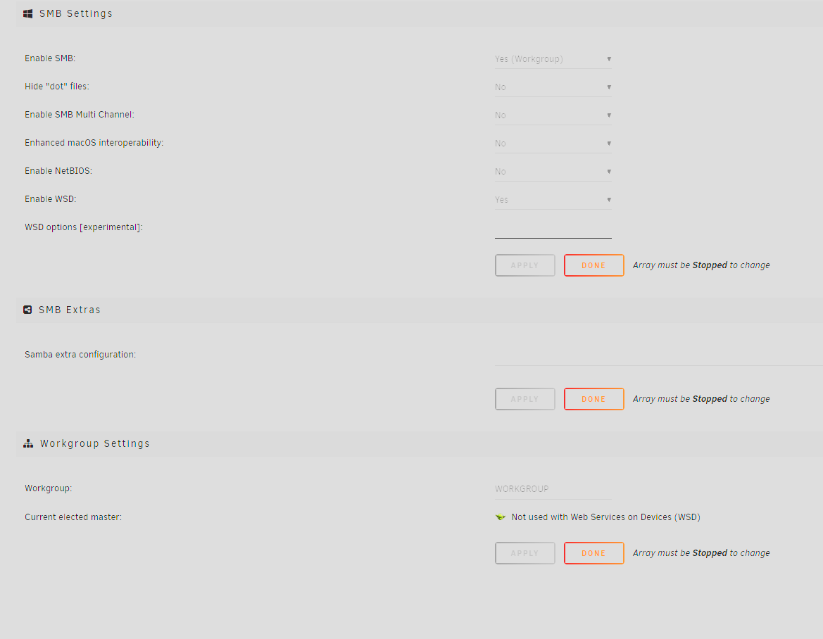

Perhaps you should post a screenshot of Settings->SMB?     I thought the values that are set there would be visible in the diagnostics but if they are I could not see them.

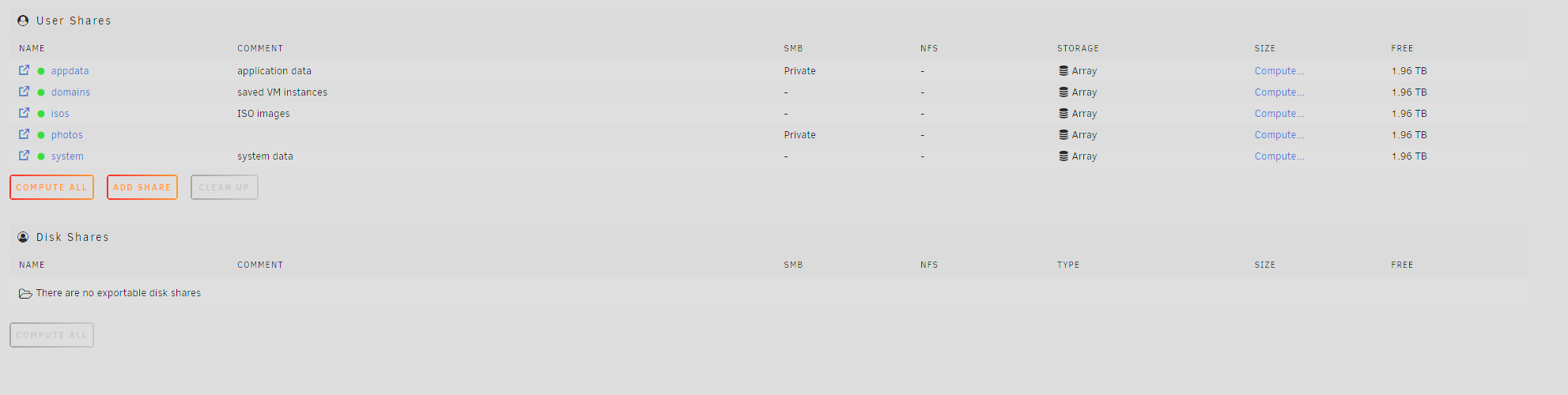

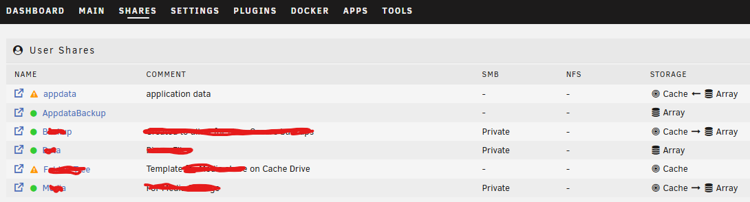

@LRBP, Also a screen shot of the SHARES tab. You can redact info as you feel necessary as shown below:

Here it goes:
