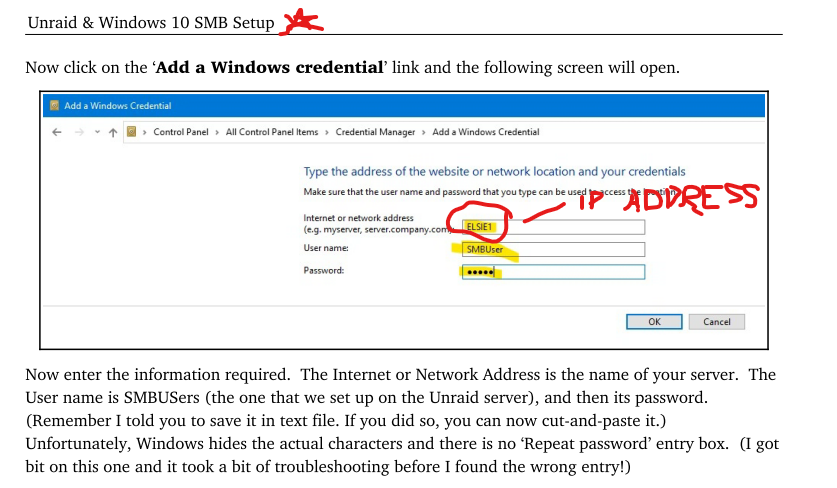

Let's work on this.   Below is a section of a page (pg14) in that PDF file.  Read and note that I marked that you should try the IP address for the server name.  It might require \\ in front of it.  (I am having a bit of difficulty here as there are millions of Windows clients worldwide that use Windows credential manager to log into servers.  Make sure that the passwords are identical on both the server and client.  You typing blind on the Windows side so try to use cut-and-paste.)
Make sure that you have only one Windows Credential that points to your server.  And remember that you have to reboot the Windows client every time you make a change to the SMB on Windows.
NOTE:  I also found this Windows command to close all connections to other computers (You can use it rather than rebooting):
net use * /delete
You run it from a Windows terminal which you can find by searching for "command prompt".    By the way, leave that terminal open.  The if you push the <UP-ARROW> key, the previous command will be reloaded and a push of the <ENTER> key will involve it.

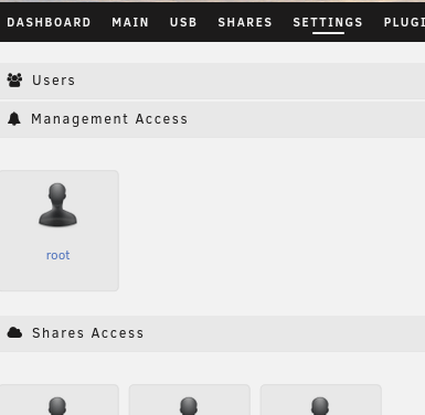

5 minutes ago, LRBP said:
No I mean "root" and then the password (as the original setup called for)
root is specifically not allowed to access SMB shares. The only place root is used is the GUI or SSH to manage the server. If you enter root when trying to connect to the shares it will lock you out.
Just now, LRBP said:
The login I'm referring to, does not have a check box (see below):
Frank was referring to the credential box that pops up when you connect to the share in windows.

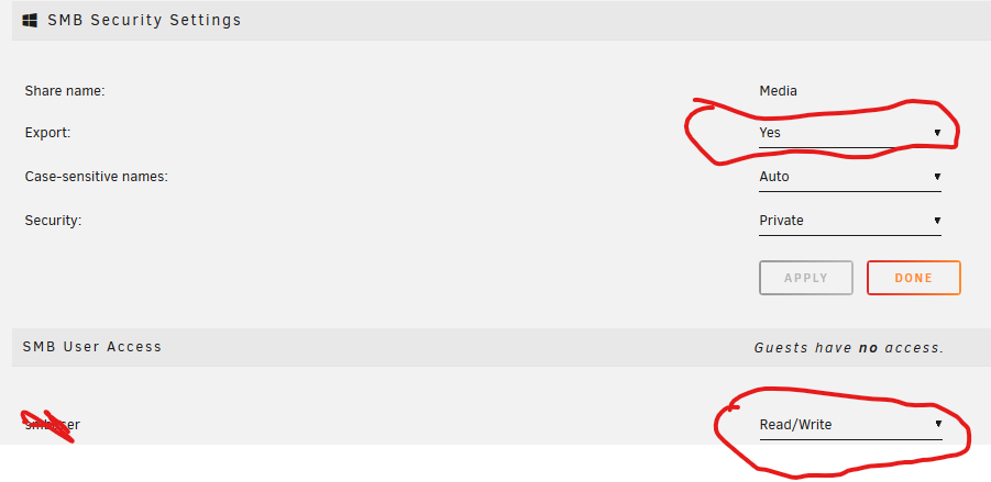

@LRBP, I look at your diagnostics and I didn't see any reason why things are not working as they should.
Only thing that I noticed is that you have two different users assigned to each of your two shares on this server as shown below:
(The Anonymizer does conceal the actual share names and Share Access user names!)    The point that I am trying to convoy is that you can only access one of these shares at a time as your Windows client computer will allow on one of these Share Access users to log into your server at a time.  So as soon as you login using one Share Access user to one share (say, T....g), attempting to access  the other share (In this case, p---s), you will get an error message.  There is no provision in Windows to logout of a server.  (Expect that command line command which I don't really consider a part of normal Windows...)
I am not saying that what you are doing is wrong.  In fact in real situations, you often want to do exactly that--- Restricting what Shares each client computer is allowed to access!  But in a testing situation,  it is very restrictive in what types of tests you can perform.  Just be aware of the situation as you test.
