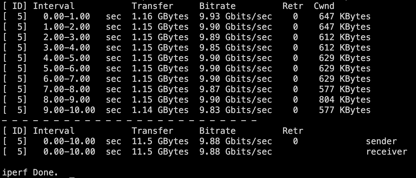

  6. Hey all, I recently built my UNRAID server and since all parity checks are done, I was planning on transferring my movies & tv shows from my old Synology DS1522+ to my UNRAID server. I added a 10GB NIC (XG-C100C) to my UNRAID and the Synology also have a 10 GBE add-in card, both have MTU set to 9000. But when I try to transfer files, the transfer starts at around 800-900 MB/s but then it drops down massively to somewhere around 80-90 MB/s in a couple of seconds. I am not using any cache drives for these transfers and I do know I won't be getting speeds anywhere close to 1 GB/s in unraid without a cache, but shouldn't I be getting a speed somewhere around 250 MB/s? ( Btw, I am using 5x 22TB Seagate Exos X22 drives on my Unraid, the synology uses 4x 18TB WD Red Pro drives in SHR-1 and using Krusader to transfer.) This is the speed when I start the transfer - This is 10 seconds later (using a different SS here, not the same transfer as above) - I did an iperf3 test bw the two, and this was the result - I also tried to do the transfer when connected to the 1 GB port of my synology, and that gave me a consistent 110 MB/s transfer speed. So I am wondering why a 10GB card will drop down to 80-90 MB/s? Attached diagnostics. Thank you! tars-diagnostics-20240310-0308.zip
  7. Ughh, finally figured out what it was. The other end was connected to the 1GB port on my switch instead of the 10GB port. Reconnected that and everything is working properly now. I feel so f'n stupid lol! Thanks everyone for helping me and I'm sorry for wasting your time.
