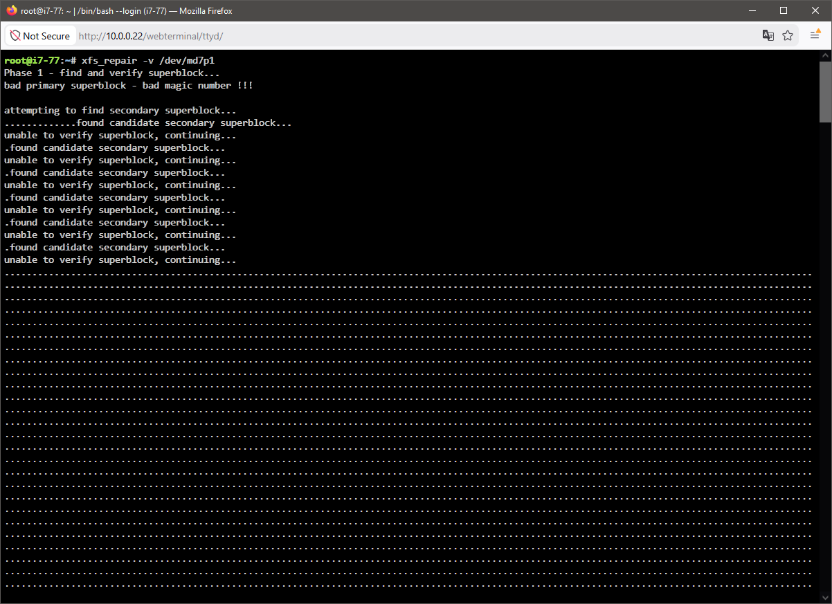

I stopped the xfs repair scan after running for 5 hours. Got some more help in Discord. Consensus is that I should not rely on the two 24tb parity drives to have data, I should use something like UFS Explorer to see if there is any data on the 16tb (which was able to go through xfs repair) and the 20tb (which is what I just stopped running xfs repair) Unless someone else has any other ideas, I ordered a new flash drive to install linux on and I'll try to run linux on a USB for the server to try XFS Explorer to see what if anything is recoverable from the drives. FWIW, I am adding a txt file with the output of the 16tb drive I just re-scanned. (the first time, the terminal process scrolled beyond the top of the window) Unraid-xfs repair disk 4 16tb 26'07-12.txt

Update, XFS repair is still running in terminal on disk 7, 2 hours later..., just scrolling ...............

Thanks for the help, I ran that command on disk 4 (16tb) late last night, drive was showing as auto, now shows as xfs This morning I am running it on drive 7 (20tb) and terminal is scrolling . periods for almost half an hour, pushed my commands off the top of the terminal screen. I got a screenshot of it starting, and will post diagnostics (made while it's still running) i7-77-diagnostics-20260712-1120.zip

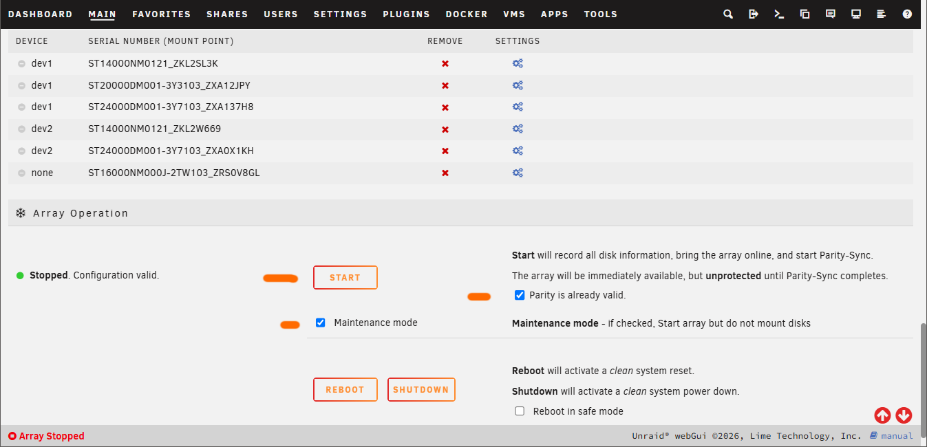

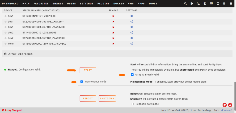

i7-77-diagnostics-20260711-0924.zip Diagnostics: After rebuilding OS flash drive with old backup from before I added larger (24tb) parity drives and made old parity drives data drives, then had a crash... -Then I made a new config and assigned the 24tb drives in what I think is the proper order as they were a week ago, and assigned two (16tb & 20tb) data drives in what I think was the proper slot order, (these were parity drives when I made my OS backup a long time ago).. -Then I started the array with 'Maintenance mode' and 'parity valid' checked... -Then stopped the array, took out the 16 & 20tb data drives from the 'slots', restarted array without maintenance mode, saved diagnostics attached above. EDIT, not the 5x 14tb drives were not moved physically or in Unraid setup since before I made my old backup Thanks in advance for looking at this. EDIT EDIT, I STOPPED the array after getting diagnostics so that Plex / other dockers and apps wouldn't write anything new to the array.
How to check if my (new-ish) parity drives are valid after OS crash
When I restart again with the 16tb & 20tb data drives unassigned to get diagnostics, I should NOT check the box for "maintenance mode"? (thanks in advance) Edit: restarted array without those two data drives, in 'normal' mode, and posted the diagnostics below.

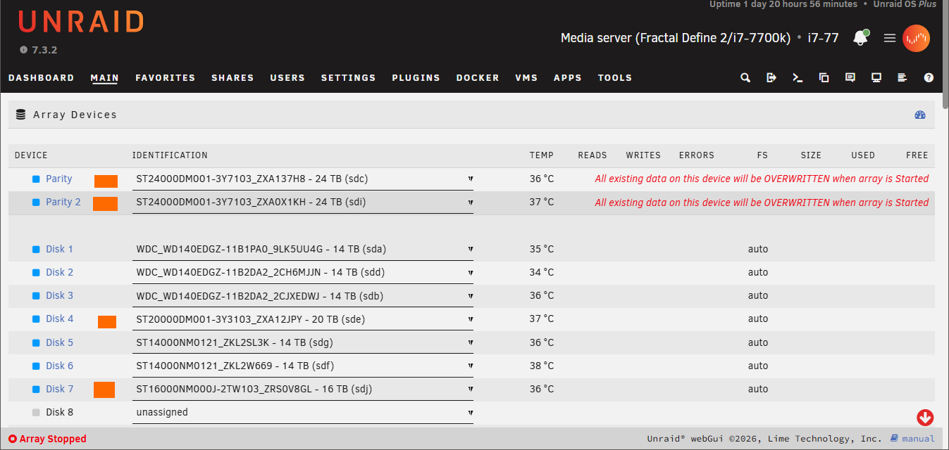

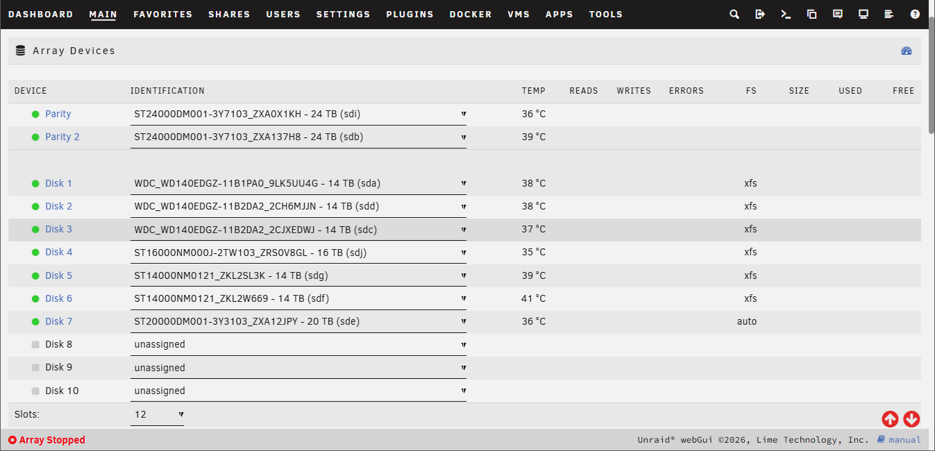

This is the layout I 'THINK" the system was before the crash. Screenshots are after the new config, with preserve data on all drives. I checked the boxes for "maintenance mode" and Parity is valid". So I should start and stop the array, then 'UNASSIGN" the two 'data' drives (16 & 20 that were wrongly put back as parity by the old backup OS) leaving the parity drives in place, then RESTART the array with those two drives out, and post diagnostics? (Sorry for delay in my posts)
ALSO, is there any way to add the two 24tb drives as parity, not knowing which was in slot 1 or 2, and start in safe mode to not screw stuff up, just to check if the order is correct?

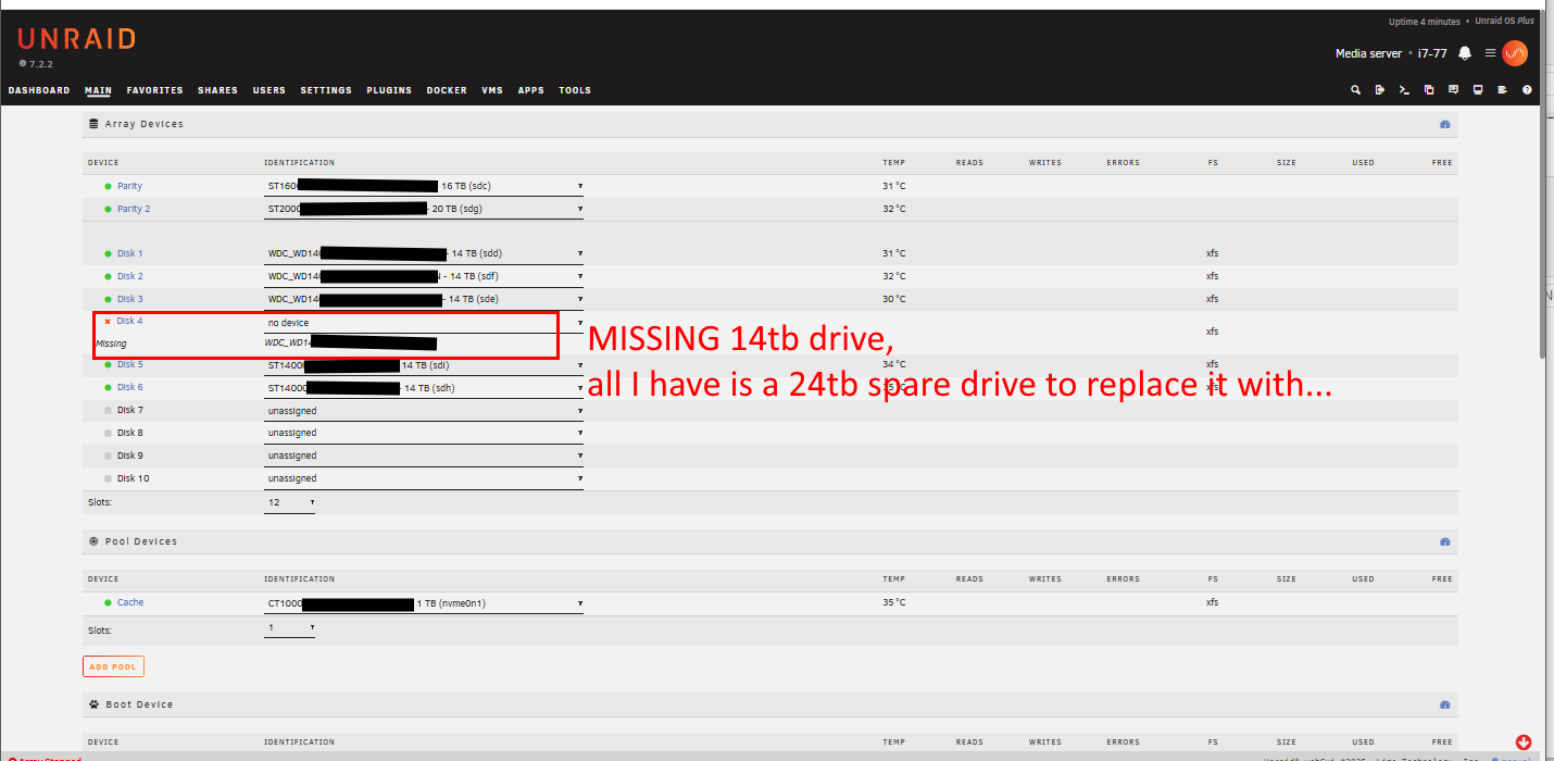

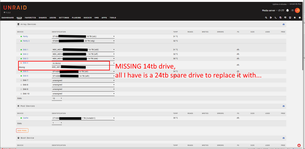

Not sure, but here's a thought... I originally had 8 drives, (16+20tb parity drives, 5 good 14tb drives,and a dead 14tb drive) I added two new drives. two 24tbs. 1st 24tb was added in same case location as the dead 14tb drive (slot 4 in Unraid) and 2nd 24tb was added as an extra drive with new data and power cables. When I would have added the two 24tb drives as parity, would Unraid likely show the slot 4 drive as the first of the two available unassigned drives, and the new addition (9th) as the lower of the two options in the dropdown list when I was adding them? I can check drive serial number and go off of that
