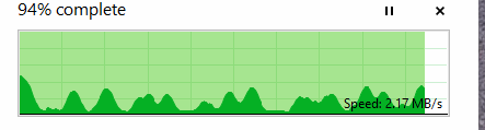

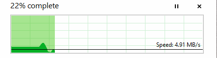

  3. I have a waft of shared drives that I occasionally need to copy something from my windows drive to a networked drive on my unraid server. Ussually it starts out great!! 100 MB/s.. Then it crashes and does this... One is copyiing a file from an unassigned drives file to a folder inside the origin folder: Drive to Drive, the other is from windows to an unassigned Drive: win to drive. Pausing one will get my speeds higher, but only temporarily. Back to 80-100 for about a min, then down to 4-5 and flatlines. Error Log just nets Jun 19 21:19:50 NJ-Server kernel: i915 0000:00:02.0: [drm] *ERROR* Unexpected DP dual mode adaptor ID 7f Anyone have any thoughts?
