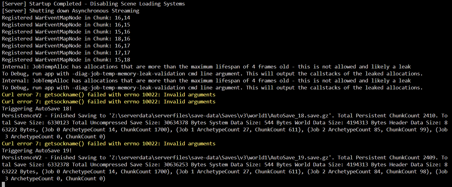

  4. I wasn't able to connect using either my LAN or WAN ips, I tried adding the server through Steam as well as manually in game. The only settings I changed were the steamcmd and game file locations. I was confused because everything seemed to be working. I ended up removing the container and reinstalling, steam still doesn't see it when I try to add it via game servers, but I can manually connect from within the game now. I'll call that a win, I guess maybe something weird happened on the first install. Thank you for working on these containers and supporting them.
  5. I've got an error with my V-Rising server, hopefully someone can help me out. The server appears to be running and is generating autosaves according to the logs but I'm unable to connect to it or even ping it. The error I'm seeing is "Curl error 7: getsockname() failed with errno 10022: Invalid arguments". I've got a couple of other game servers running but this one is the only one giving me trouble. Any ideas would be greatly appreciated.
