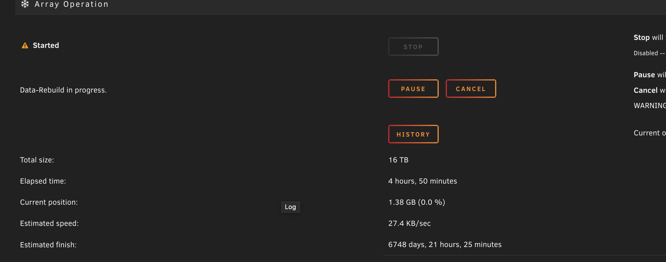

Thanks - tried that, docker still doesn't seem to want to start. I'm noticing my rebuild is running impossibly slow. At this point, estimated time of completion is going to be 12 years from now...lol. I still feel like things are really unhappy.

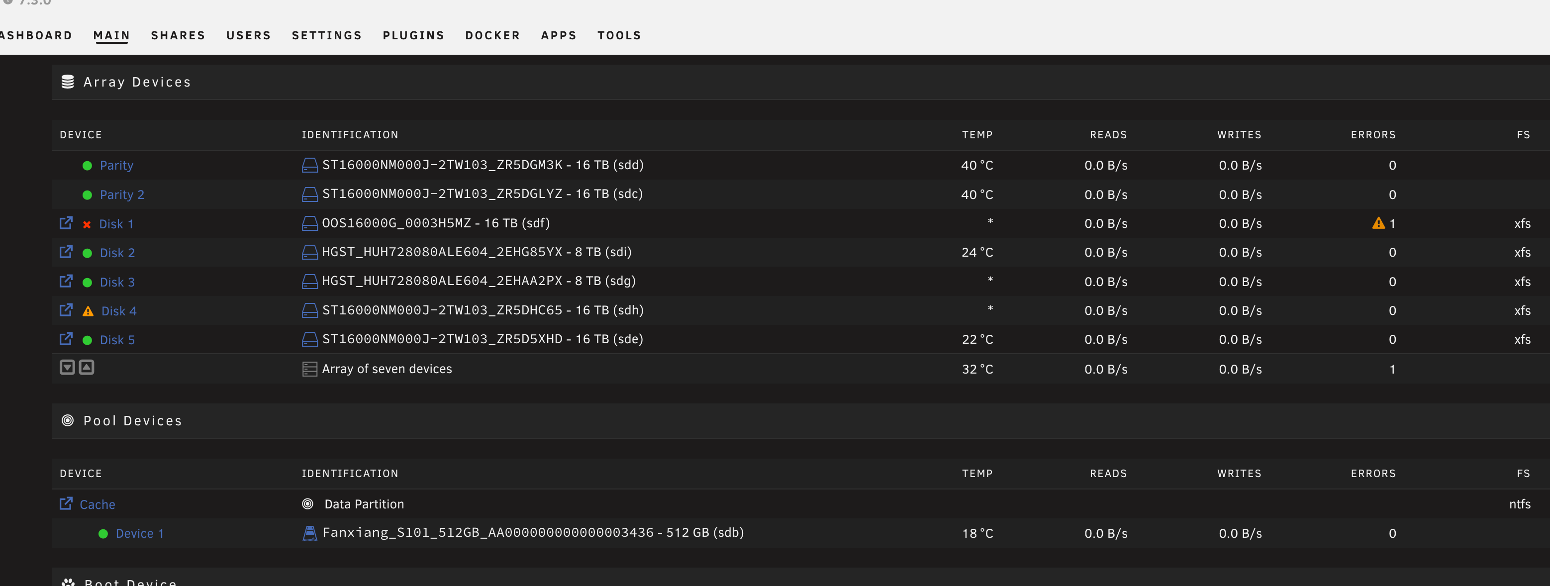

Following an OS upgrade, my system came back up with two drives disabled. I checked the SMART status and they both looked good, so I mounted in maintenance mode and tried running an xfs_repair on each from the UI and it said it fixed the corruption. Unfortunately, they were still in a disabled state. Per some info I found on the forums, I heard the correct way to handle this was to let them rebuild from parity by removing them in maintenance mode, starting, then stopping an re-adding in the same slots - so I attempted to do so. I still have one showing a read error, but it the rebuild has started. I don't know if there's anything else I need to do, but my docker service doesn't seem to want to start - so I've attached my diagnostics.zip to see if any of the wizards here might be able to help. tortuga-diagnostics-20260529-1704.zip

I tried running xfs_repair -L (via the Check button in the UI) and it seemed like it finished successfully. Unfortunately, the drive isn't coming back, and I'm reluctant to do anything with the parity drive (I have two). For context, I had an array of 16tb & 8tb drives - two 16TB parity drives, one SSD cache drive. I removed a dead 8TB, replaced with a 16TB, added it to the array, and let it rebuild for two days. This morning, I logged into my machine and found a bunch of missing files, so I started investigating and saw all the xfs corruption errors. That's when I attempted the repair after reading some forum threads. Diagnostic zip attached. tortuga-diagnostics-20250304-0749.zip
