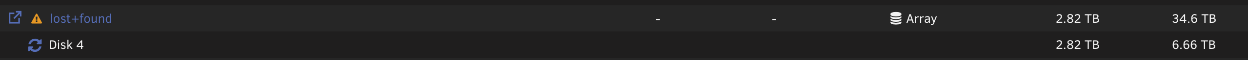

On the User Shares page, click Compute... on the lost+found share and post a screenshot of the result.
Sorry, I'm not clear here.  I can click "Compute All", which seems to churn for a very, very long time.  When I click on lost+found, I do indeed see many, many folders in there for which the location is "Disk 4".  Is there a way to recover these?
Edit:  Nevermind - Compute All is completed:

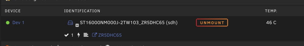

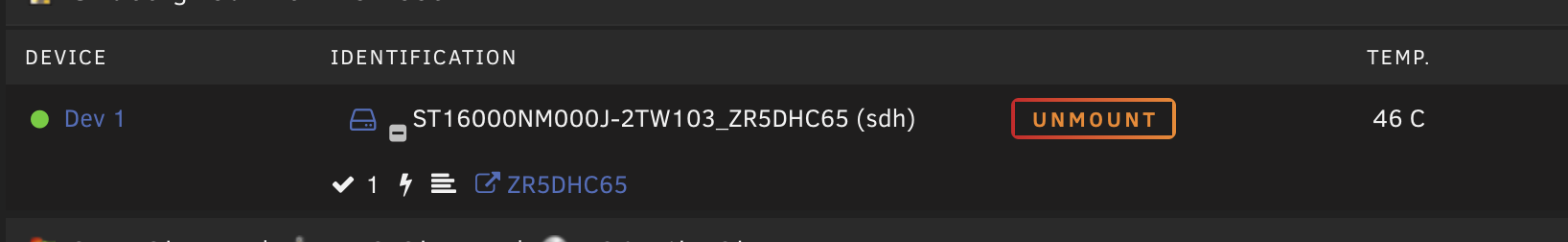

Unassign disk4 and see if Unassigned Devices thinks it may be mountable.
Unassigned devices seems to have mounted it.
