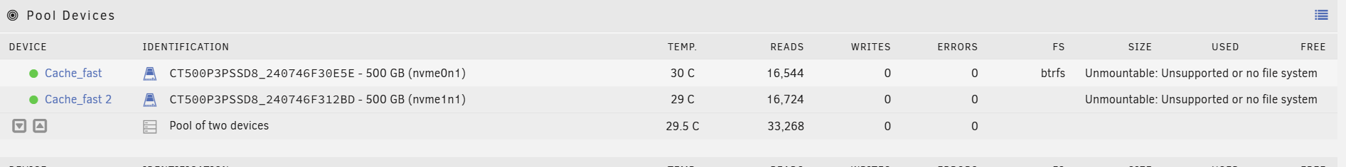

  1. Going to mark this as solved - I ended up re-creating the cache pool as zfs, as I'd intended to do that for awhile anyway. Have daily backups for the Home Assistant vm, so that was easy to redeploy. Docker containers were easy to bring back as well, since the config stuff is saved (on the flash storage, I think?) Did some more cleanup also, seemed like a good time. Scrub'd and ran SMART tests. I'll still run memtest86, I just haven't dragged a monitor down to the unRaid server - but I shall. Appreciate your assistance @JorgeB - not just with this particular incident, but many of the threads I've referenced for all sorts of questions I've had with unRaid end with you providing a solution. ...I do very much hope to avoid having to reference this forum for at least a few weeks
  2. Thought maybe it was going to last... Was still functioning around 04:00 03:00 and then by 06:00 the problem reappeared. New logs attached - I do see a ton of BTRFS errors begin right at 03:00 in the logs. 03:00 is the time the appdata backup runs. unraidy-diagnostics-20241210-0635.zip

  5. @JorgeB and sure enough it's happened again. Attached the log in case there's anything notably different than yesterday's case. Is there a reason why the redundancy of the 2nd drive isn't allowing for things to move ahead? Should I pull the 2nd ssd and use it elsewhere? Will plan to rebuild cache pool. adding: rebuilt cache pool, will report back (or mark as solved) in 24hrs or so, when it seems the issue is unlikely to repeat. unraidy-diagnostics-20241208-0721.zip
  6. So after looking at the logs, it seemed like running btrfs rescue zero-log /dev/nvme0n1p1 In the terminal was a good step to take, given some browsing on this forum. I then restarted the array, and things look okay. My only questions are: how might this have happenened, and should I be doing something to prevent it in the future?
  7. Good day yall, Noticed my home assistant instance not functioning this morning, so opened up the Unraid UI and found that my brfs cache pool was reporting "Unmountable: Unsupported or no file system". I have two Samsung nvme drives in a raid1 (see attached photo). I don't think I've made changes to the server recently, although perhaps I'm forgetting... If anyone has ideas on steps to try to fix I'd very much appreciate it. unraidy-diagnostics-20241207-1555.zip
