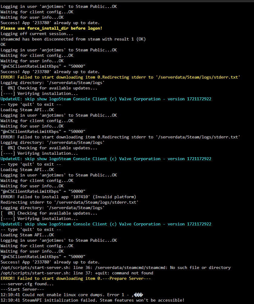

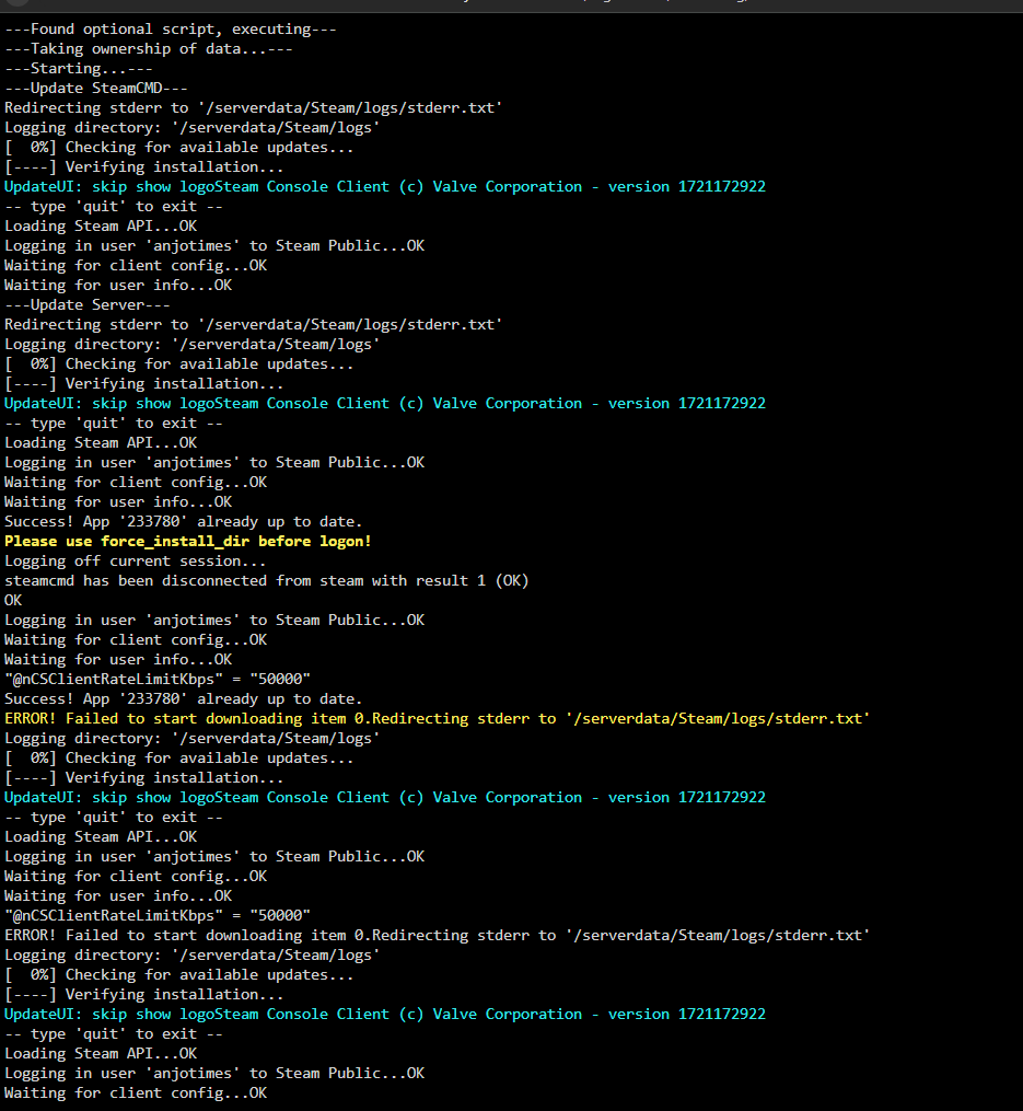

  1. I believe it's in the step of the right direction as after tweaking what you just sent to have +force_install_dir to be infront of login it just gives me a file not found updated user.sh sed -i "32i\\ \${STEAMCMD_DIR}/steamcmd.sh +force_install_dir \${SERVER_DIR} +login \${USERNAME} \${PASSWRD} +@nCSClientRateLimitKbps 50000 +app_update \${GAME_ID} +workshop_download_item 450814997 validate +quit " /opt/scripts/start-server.sh Results I can't tell what the issue is other then its failing to start the download item 0 which I can't figure out what that means. When I go to look for /serverdata/Steam/logs I can't find the actual logs

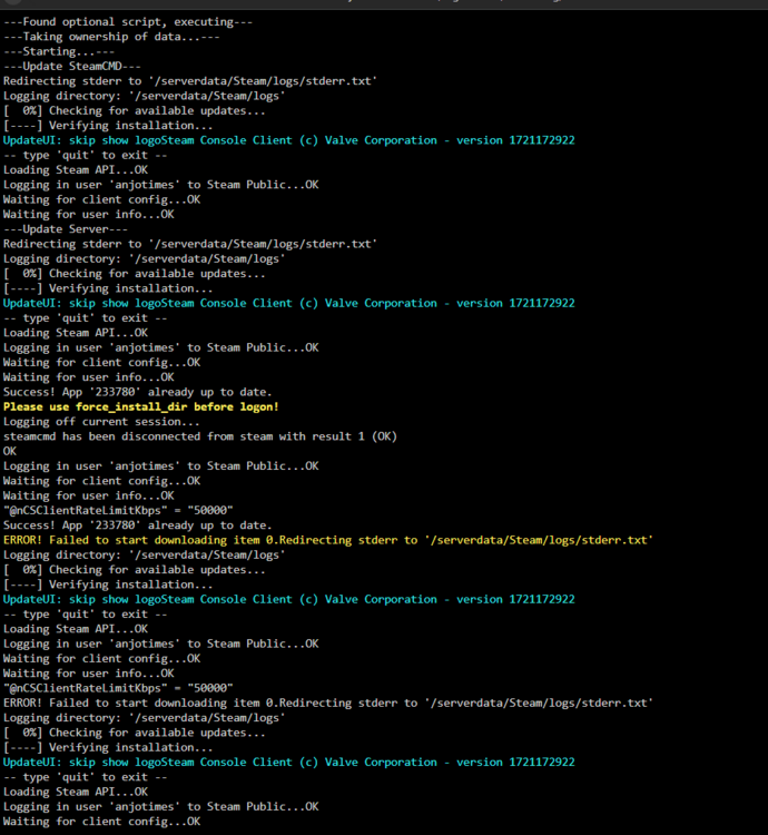

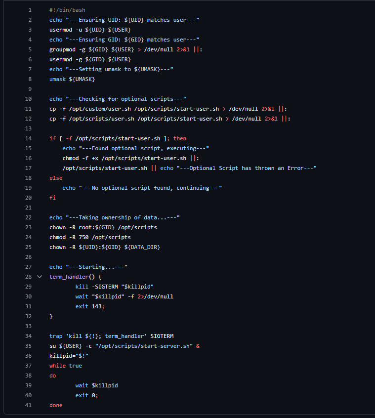

  3. Same thing Current user.sh su $USER ${STEAMCMD_DIR}/steamcmd.sh +login ${USERNAME} ${PASSWRD} +app_update ${GAME_ID} +workshop_download_item 450814997 validate +quit Should line 23-25 happen before the optional scripts check?

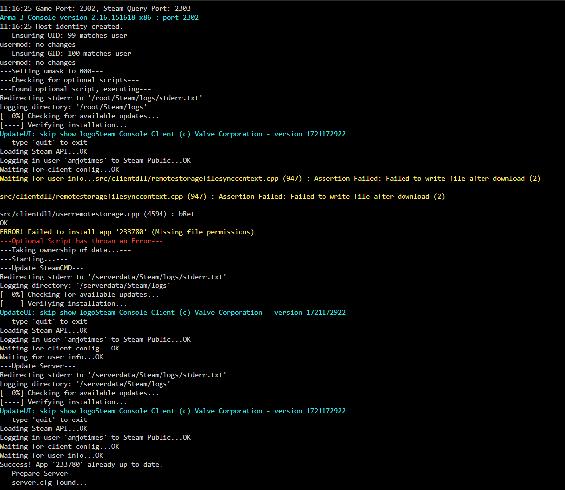

  4. The /steamcmd was just missing .sh But now I'm running into a missing file permissions error

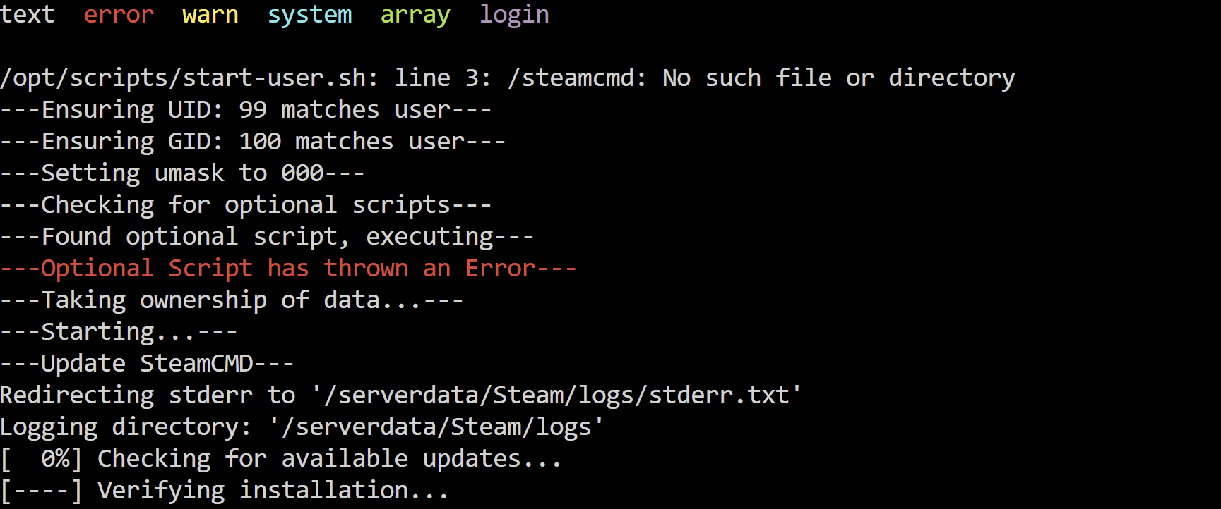

  6. Hey when I do this I'm getting a Optional Script has thrown an Error in my logs The script is #!/bin/bash su $USER ${STEAMCMD_DIR}/steamcmd +login ${USERNAME} ${PASSWRD} +@nCSClientRateLimitKbps 50000 +force_install_dir ${SERVER_DIR} +app_update ${GAME_ID} +workshop_download_item 450814997 validate +quit
