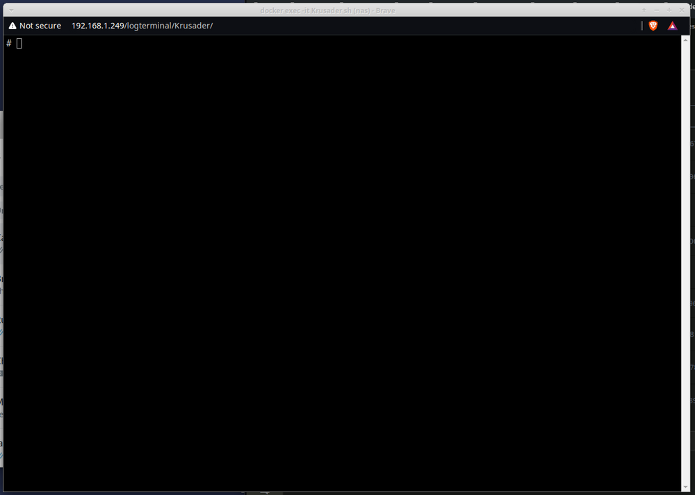

I brings up No VNC connect

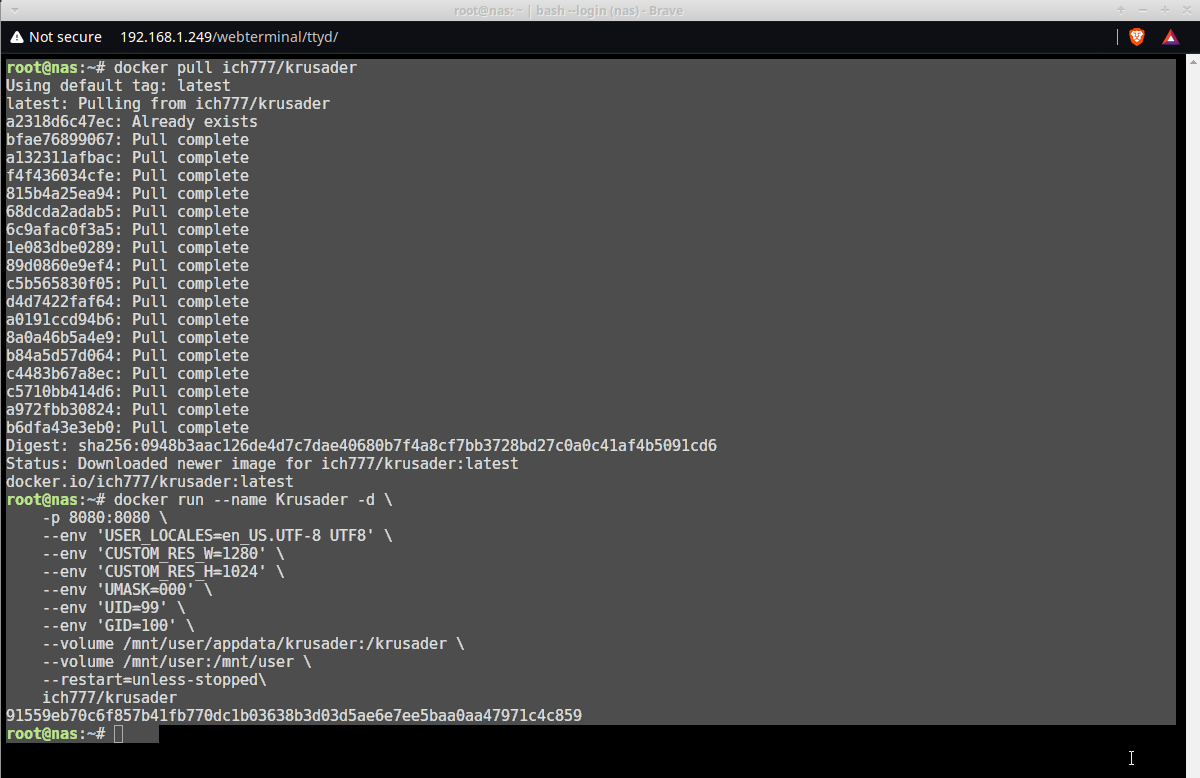

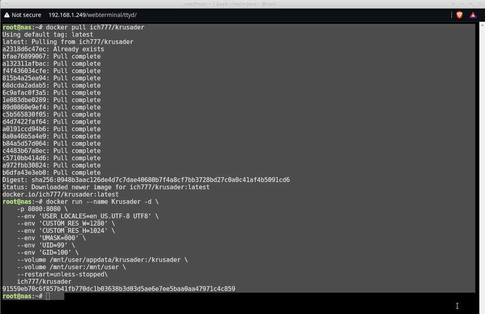

I removed the docker and reinstalled it. This is the result and still no WebUI. What am I doing wrong?

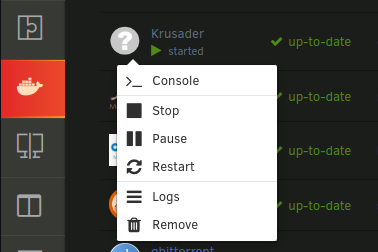

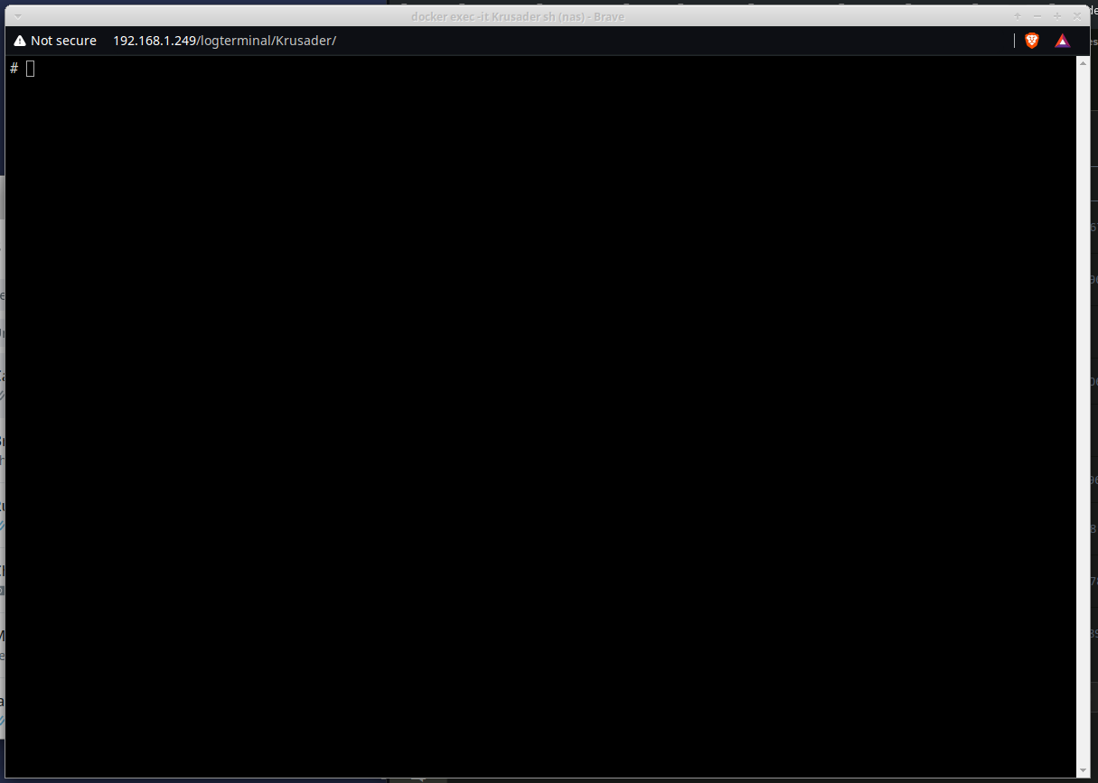

Hi, As a newbie I hope I am doing this in the correct place. I just pulled and installed ich777/krusader When I choose the icon (It does not have a name), adjacent to the name Krusader I can open a console and expected a split screen view. Instead I opened a page which flashed white and settled as a blank black page with #. I have always installed dockers from the CA page and this is my first attempt not using that page. I must have done something wrong or not done something. Would you please assist this old fella?

Removed the install using this page With the command: docker system prune -a --volumes The command without using --volumes did not remove the install docker system prune
Unraid 6.12.13: Pulled a docker and cannot find it!
Sorry, newbie, thought I was installing a docker which was no longer in the CA. From the web page I pulled the sparklyballs/krusader image expecting it to appear in the docker containers page. It did not and since then I find the image is 9 years old and there are newer ones. How can I at least find the docker and then remove it please?
