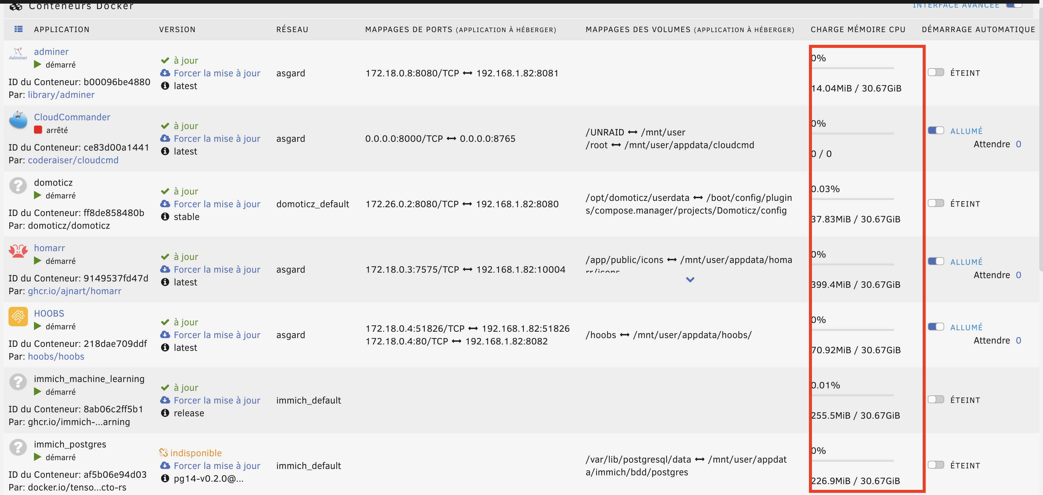

  4. Another similar question: I noticed that for my containers (logically in appdata), a reference was made to 30.67 Gb, which is the size of my system USB key. So I don't quite understand, aren't these containers stored on my key? Thank you for these clarifications, which will help me get organized for the years to come!

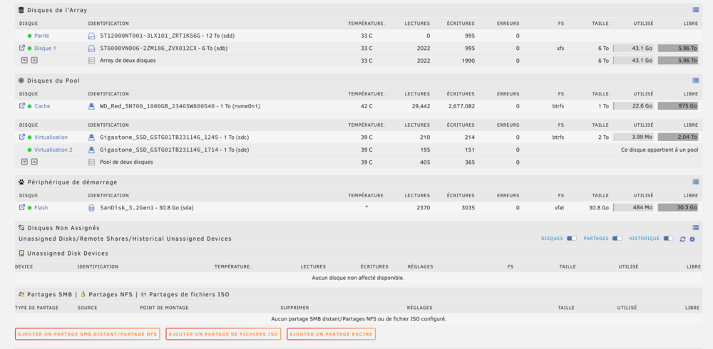

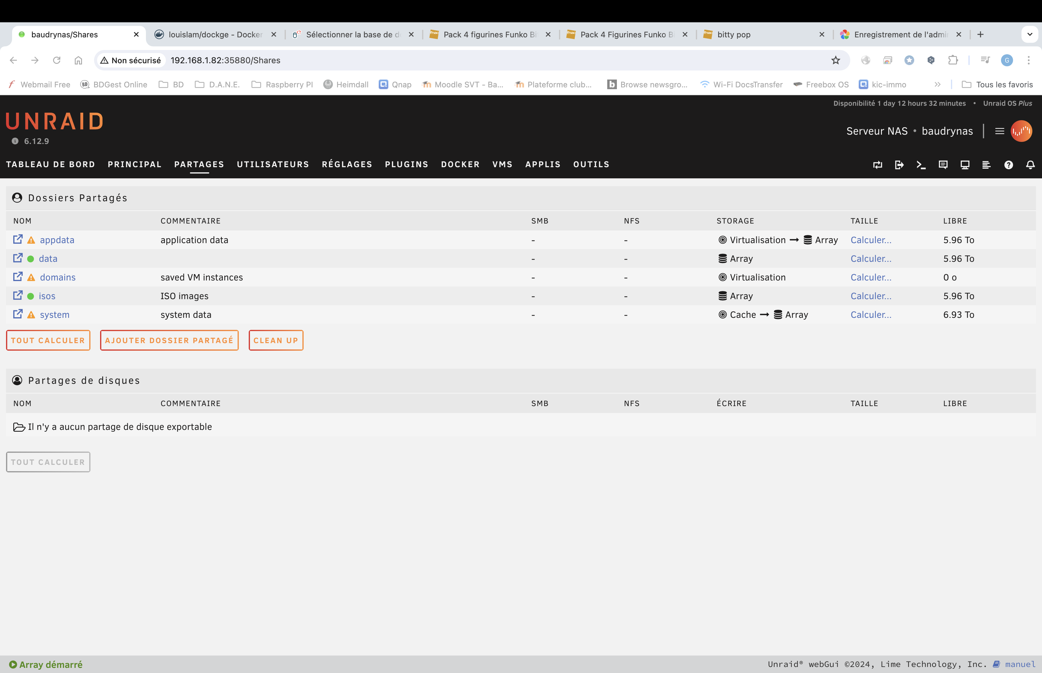

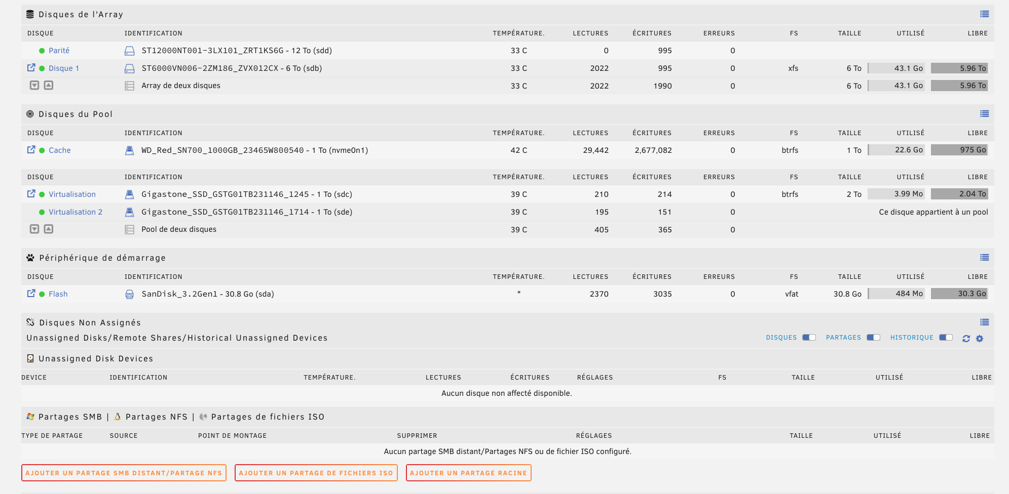

  5. Hello everyone, I have just started my server under Unraid and I would like to consult your expertise in order to start on the right foot on my config... I want to run docker and VMs on two SSD drives for speed and the rest on array, so here's my work so far: - Array: - Parity: 12TB disk - Storage: 6TB disk, but it will soon have little brothers. - Virtualization pool: - 1TB SSD disk - 1 TB SSD disk - Cache : - Nvme 1Tb SSD disk Thank you in advance for your advice, it would be better to change everything until I have stored my data on it. So let me clarify that I have hijacked my original folders as appdata on my pool for now. But they appear as unsecured. This means that they apparently don't fit into the parity. Please let me know if this is a problem for the future. I plan to install regular VM backups and docker afterwards anyway...
