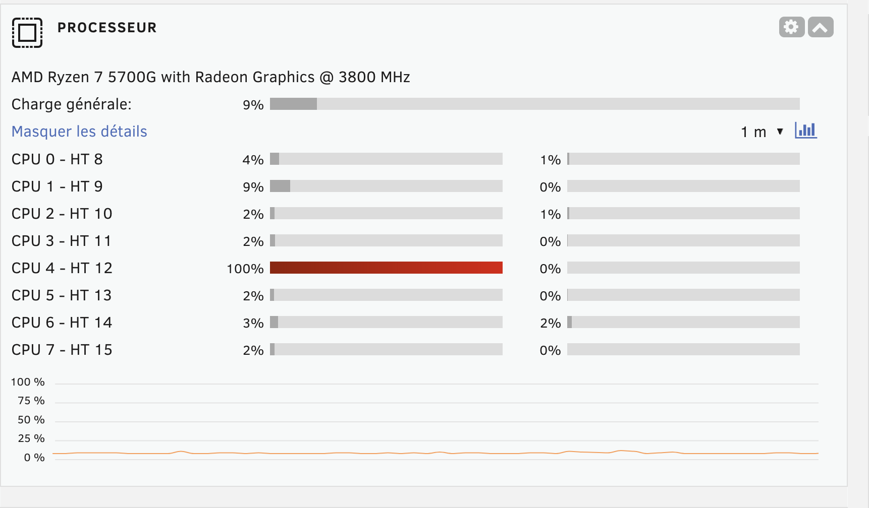

I'm writing to this forum because I've had a problem several times now with the parity check (which is programmed at the beginning of each month).
The docker services crash completely and one of my processor cores is blocked at 100%. I've had to reboot the whole server twice already because after a while, even the Unraid system crashes.
I'm in 7.0.1. And the problem was already present with 7.0.0.
Translated with DeepL.com (free version)
