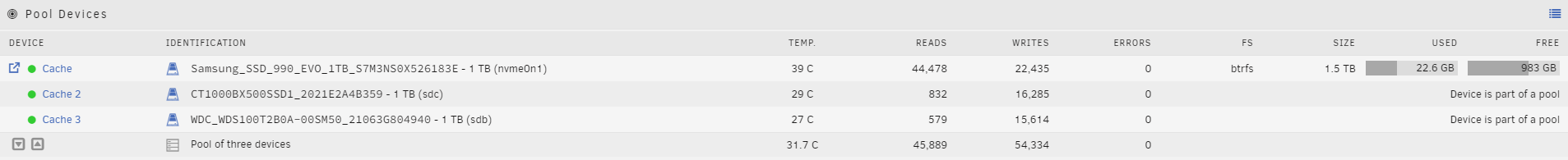

Added two drives to a cache before formatting, now I can't figure out how to format
Got it, thank you!
I do want them to be part of that pool, I guess I was confused because they are listed without filesystem or space info like my other drives.
I added two SSDs I pulled from other systems, but didn't format first. Now I can't seem to format them. I tried to remove them from the cache pool, but it won't let me lower the device count from 3, so I can't start the array.
