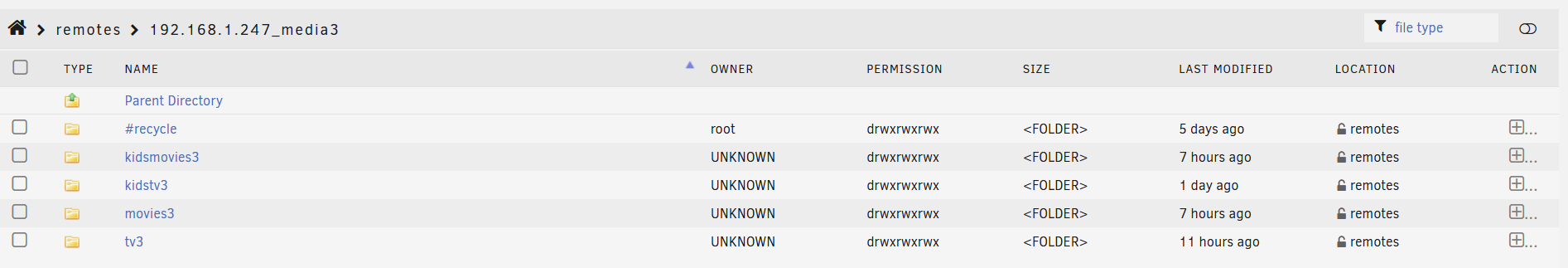

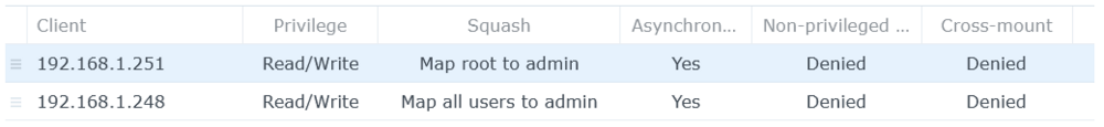

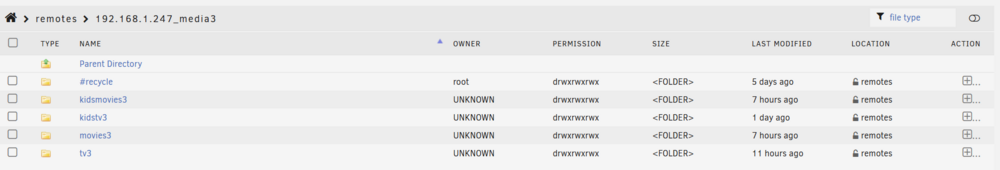

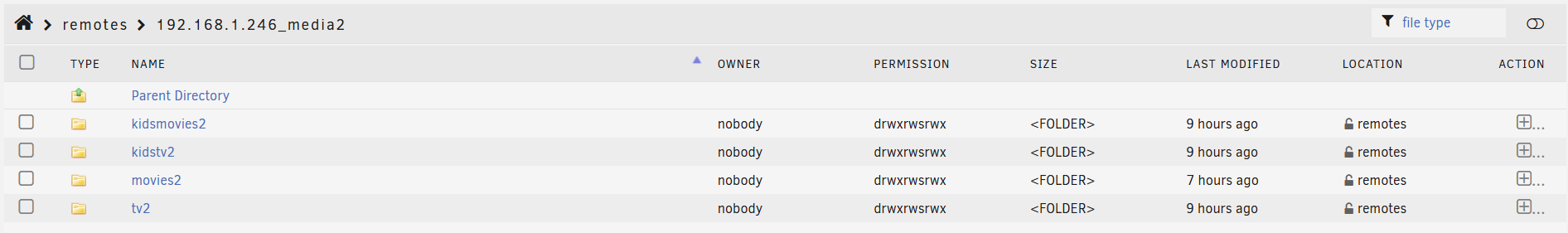

  1. Sorry should have been clearer - I am trying to get my arr apps to write to the NAS drives - specifically Radarr and Sonarr. media2 is now working since I changed the permissions - everything I download is moved to the correct folder. media3 has some folders that it works and others that it doesn't. Here are the permissions I have setup on media3 (Synology) - 192.168.1.251 is my OMV server, .48 is my Unraid

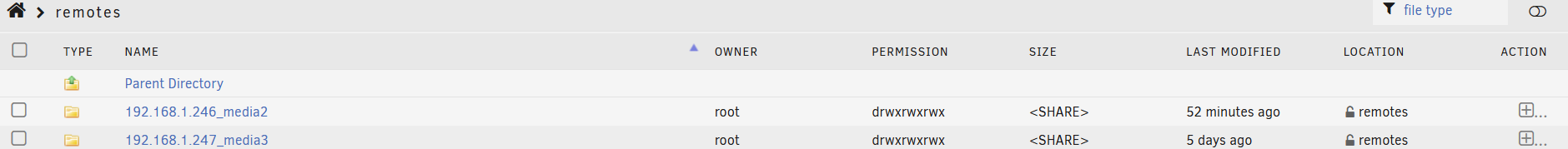

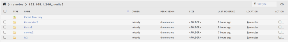

  2. Hi all, I am new to Unraid and have installed Unassigned Devices as I am using my Unraid server to host all my docker containers (Plex, Arrs etc.) and I have 3 NAS drives that I will be using to host my media. Netgear ReadyNAS 314 is media2 Synology DS218play is media3 I have setup NFS shares to both NAS drives and have setup root squashing on both. I was having trouble writing to media2 and its subfolders but was able to change the owner & permissions to get it working. I have tried to do the same thing for media3 but it will not change the owner nor the permissions. I am not sure what to try next to get this to work
