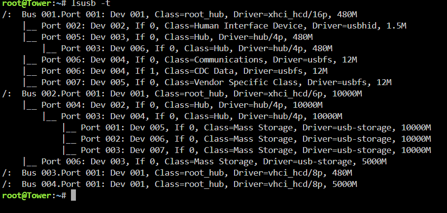

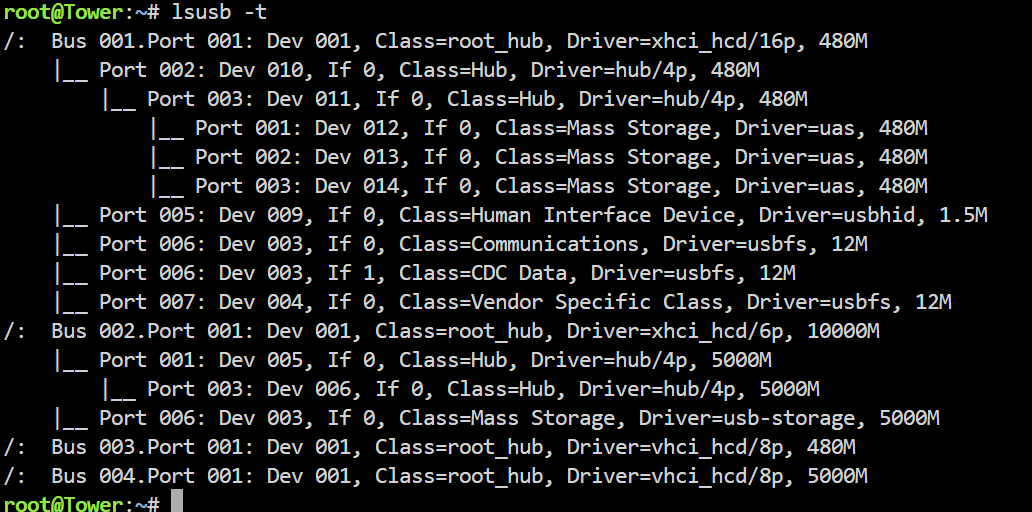

  1. But how could i tell unraid to change driver ? I did not found any option and i was surprised when everything was fine after reboot...

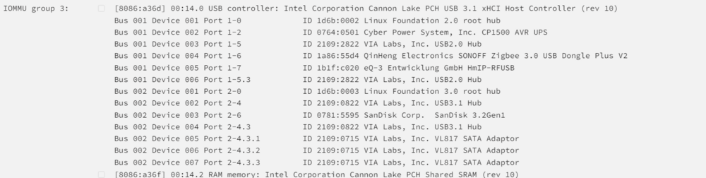

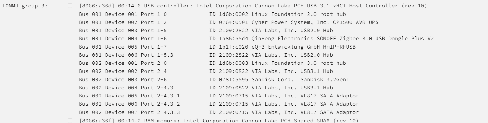

  2. Didnt test this (just have on, but need another for parity disk), but for @JorgeB explanation it should work because they will get different IDs No, no problems, no need for diagnostics. This is the first major problem I've had with Unraid. Is it possible to force Unraid to install a specific USB driver or delete other drivers except the regular? I mean, the only thing I changed was swapping one USB key for another.
  3. I tried your syslinux.cfg change. nothing happened except the 3 SCSI devices in System Devices were also gone. After that I was messing around a bit more and even tried plugging in a new Unraid stick, but I had the same issue where only some of the drives showed up. After switching back to my 'usual' stick, suddenly all the drives were there again. Now I'm too scared to reboot... IDs are the same (!), i switched USB-Plugs to 10G and everything is fine for now...

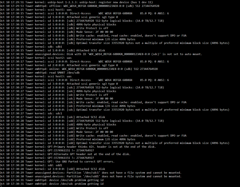

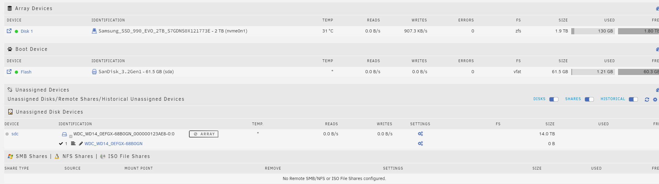

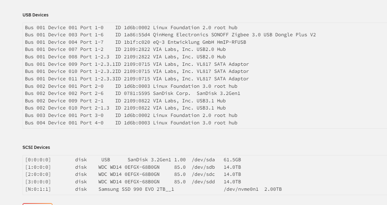

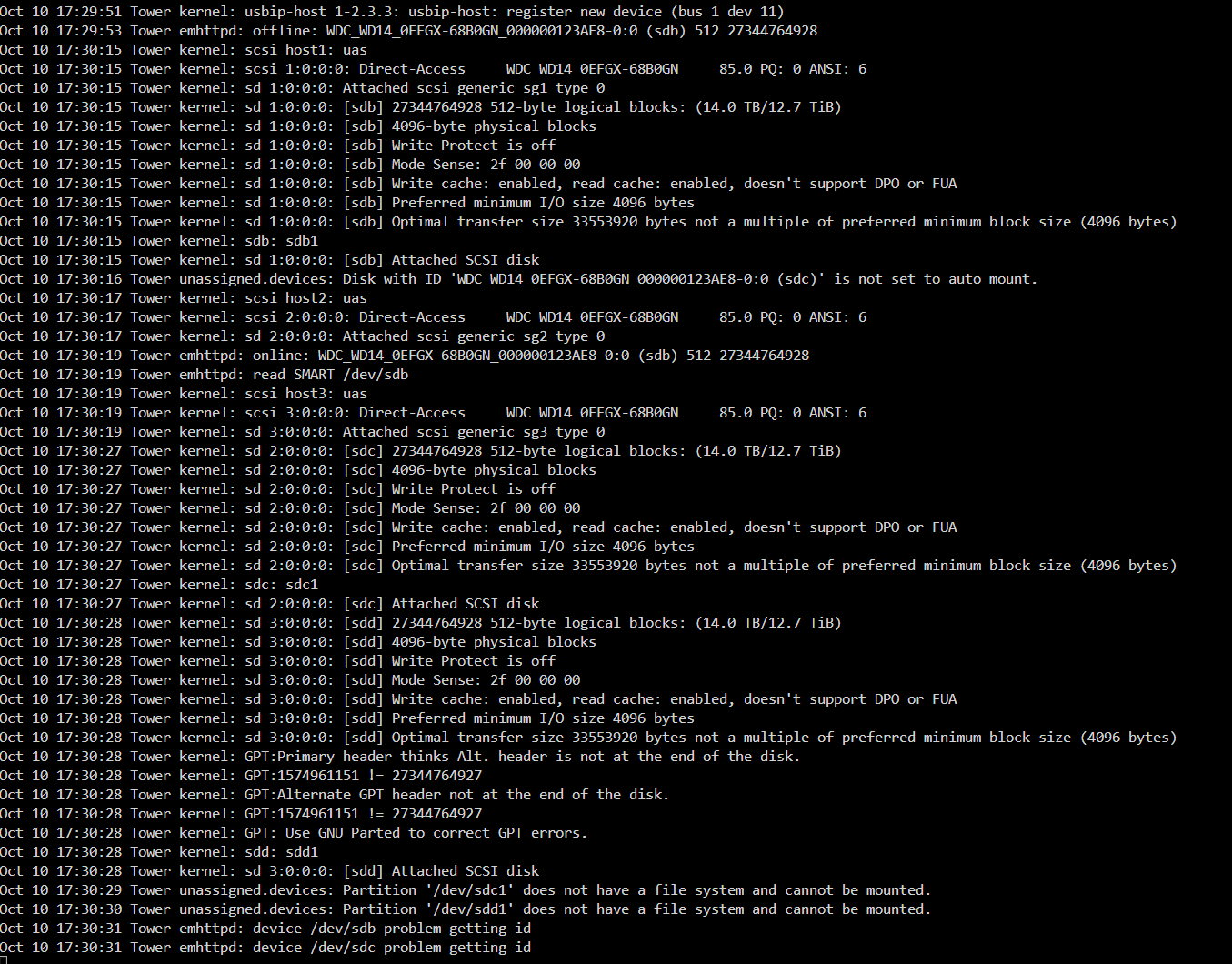

  4. Hi JorgeB, the same enclosure worked perfectly fine until i tried to add an cache device today. After first boot, just one device showed up. Is it possible to reset the IDs ? I didnt change unraid version. I`m on unraid 7 beta 3.
  5. Hello, my Unraid only recognizes 1 of my 3 USB hard drives (all in a multi-bay enclosure), and I can no longer build an array. System went well for many days, but after i tried to add an SSD cache not all HDDs were recognized anymore. Under "Tools" → "System Devices" → "SCSI," all devices are listed correctly. However, on the "Main" tab, only one of the 3 hard drives is recognized correctly. The others are not detectable. I have already tried a different USB port (currently using a slow USB 2.0 port because of this). Any ideas ?
