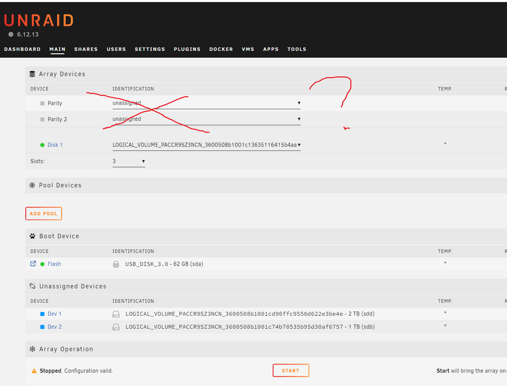

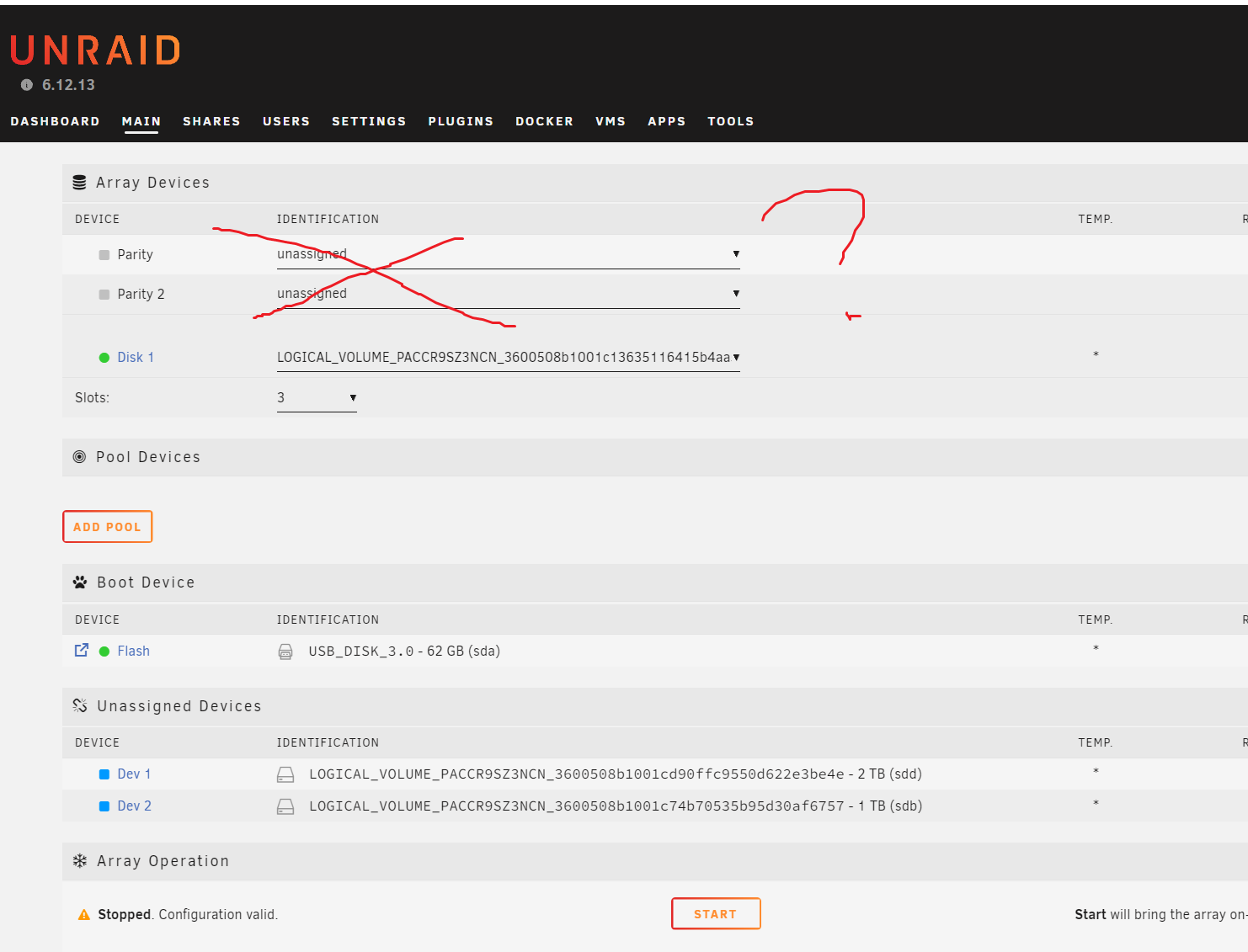

  2. And in principle, p410 does NOT officially support this. It's just a "hack" and it is not required to work correctly. I'm not particularly upset. The question is different. Can I disable the warning about the absence of Parity? (I don't need it, my RAID controller does this). As an array, I have a RAID10 300 GB mirror made of two SAS disks. I will throw the other 2 RAID10 mirrors on a remote computer via iSCSI. I would like to remove Parity so that the green light is on instead of the "triangle"
  3. In general, I think so, after rebooting, the p410 controller, although it sees that it is in HBA mode, "doesn't like" it. And it "breaks" or puts some of the disks into emergency mode. Conventionally, this problem can be solved by DISABLE the boot initialization of the p410. So that it does not load at all, but is seen as a "dumb" adapter in the system. There is no such option on the old HP Gen5 server, I cannot disable the PCIe devices. Therefore, I simply made 3 RAID10 mirrors again. Pros: the battery and 1 GB cache work, the disks work together (in UNRAID, all disks work on their own and the speed is not summed up). But there is a MINUS - I DO NOT KNOW whether the disk is out of order, because of the logical array. I need to go to the server room and look or reboot remotely and look. But I don't think it's a problem, it's not my main storage, it's mostly a trash heap

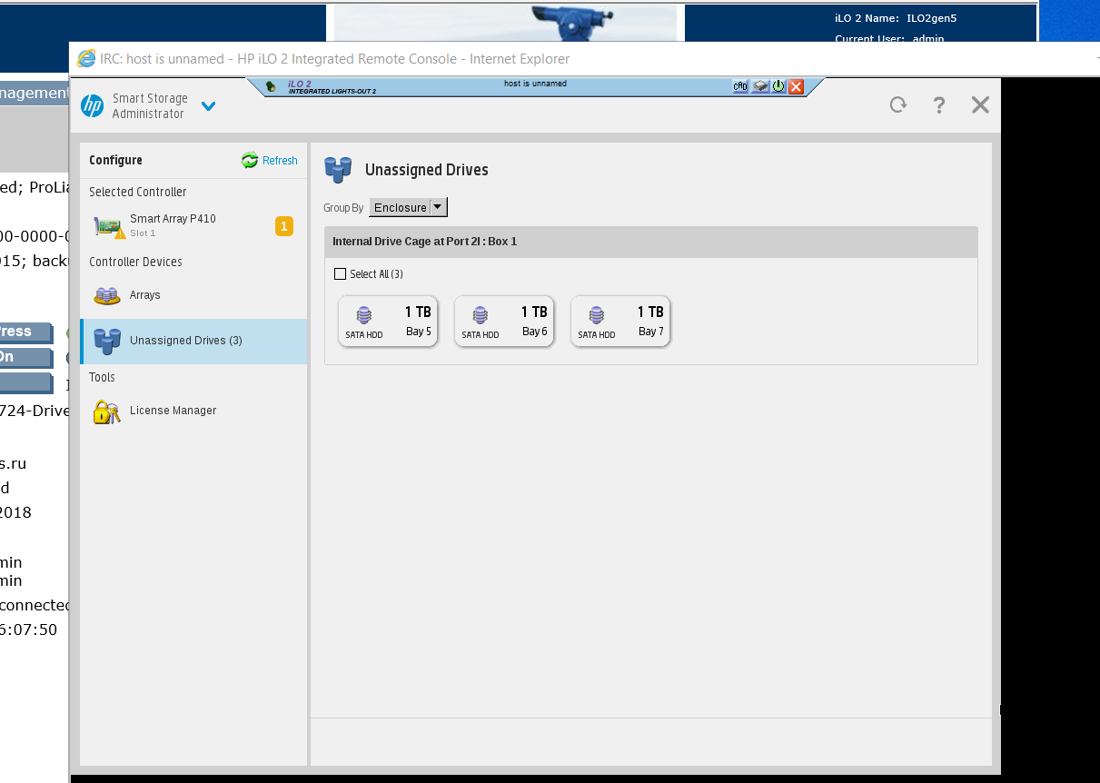

  5. I downloaded the proprietary utility HP Smart Array Assistant. But the problem starts EARLIER than the system loads. That is, the program itself "sees" only 3 disks (bed 6,7,8). In fact, it only sees beds 6,7,8. And my firmware is the latest. I don't know, I'll try to do a clean slate according to the guide

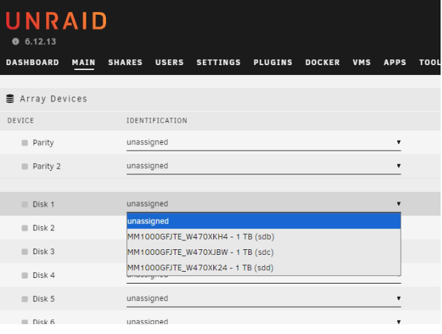

  10. Yes. Only 3 disk after reboot. Problem software (letter disk changes)

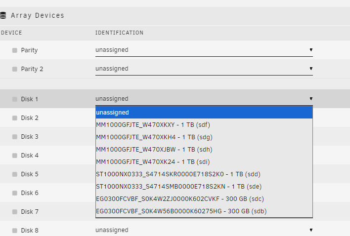

  13. Here I turned off the HBA and rebooted (the controller detected 8 raids RAID0) NAS UnRAID did not boot and gave an error "something there 30 seconds". I did a hard reset and deleted all RAIDs0 (8 pcs). Booted into the system and turned on the HBA. I see all the disks. I reboot - the disks disappear

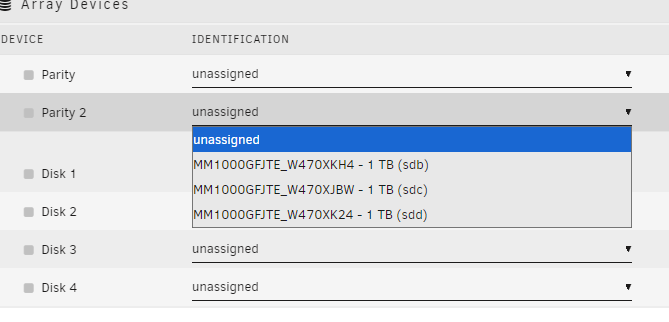

  14. I swapped the disks. The old installation had the same thing. Just rewrote Unraid to the flash drive. Just installed the plugin. Same behavior. Same disk letters. If I turn off HBA now, create an array. Unraid boot, then turn on HBA - I will see all 8 disks. Until reboot. I'll show you now
  15. No. I'm lying. After rebooting I see 3 other disks. So the error is "tied" to the disk beds and letters. Maybe install Unraid from scratch? Clean installation
