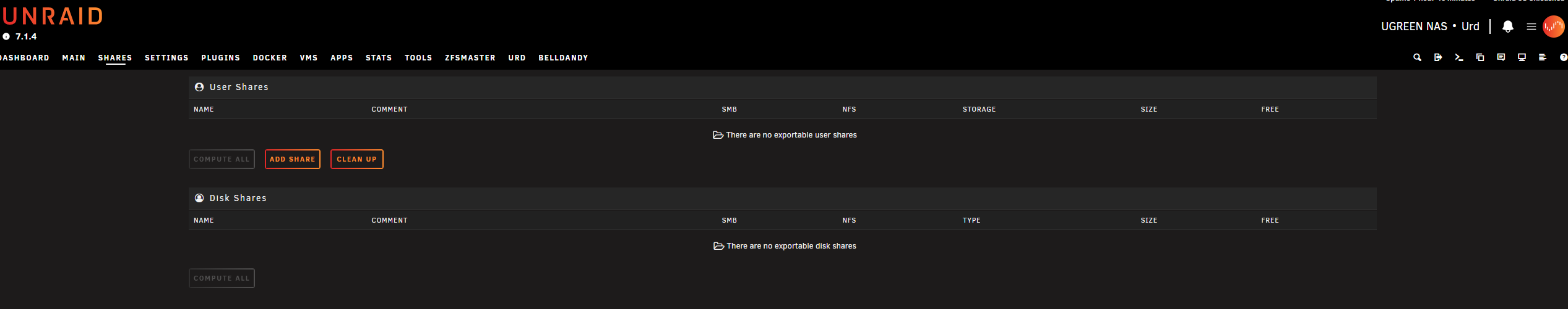

  5. Hi all, I'm running Unraid 7.1.4 and have encountered a recurring issue where my shares intermittently disappear. This, in turn, causes broader problems, such as breaking all Windows network shares and virtiofs mounts used within Unraid-hosted VMs, most notably my Proxmox Backup Server. The issue temporarily resolves if I reboot the NAS, but it typically reoccurs within minutes to a few hours. I've attached a screenshot showing the shares list completely empty, along with two sets of diagnostic logs: one captured during the issue, and another taken post-reboot when the shares were accessible again, for comparison. If anyone has any insight into what's causing this or how to fix it, I’d greatly appreciate it. Ironically, the problem only began after I upgraded from a trial licence to an Unleashed licence. Thanks in advance. pre-reboot - urd-diagnostics-20250701-1117.zip post-reboot - urd-diagnostics-20250701-1134.zip
