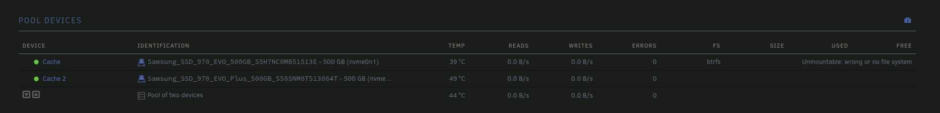

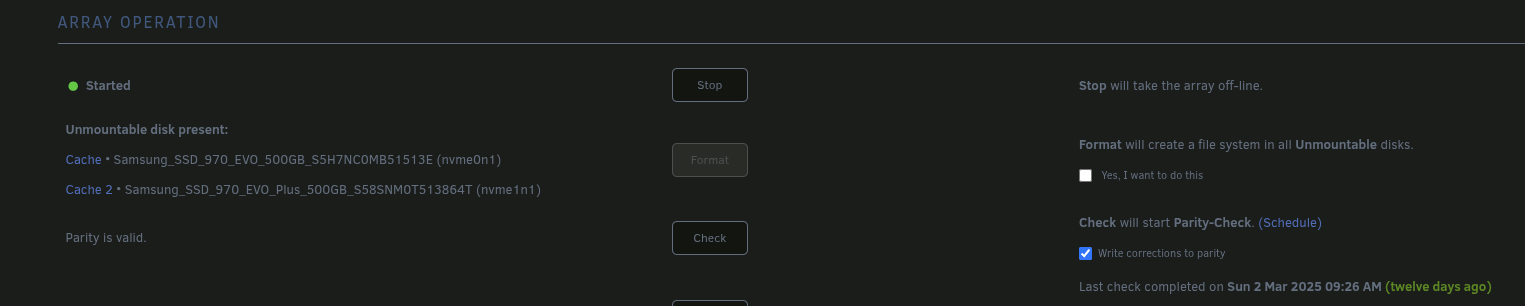

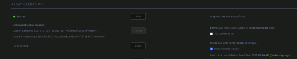

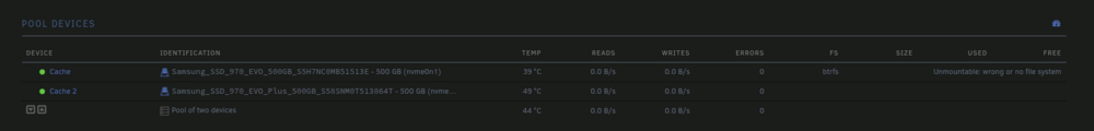

  7. Good news, with the addition of "p1" I did not get an error. With array started, under "USER SHARES" I'm able to see "appdata, domains, and isos" shares that were set to use cache. All three are showing as empty of files. I did adjust them to use Array now. The two images are showing the change since the command worked. The physical drives are now showing as unmountable and is now asking if I want to format them.
