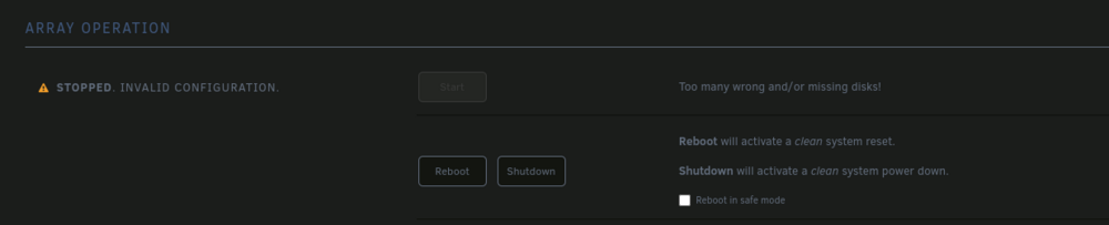

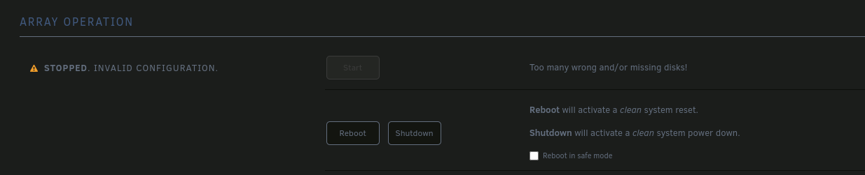

I was swapping out the 2 current Parity drives for 2 larger drives. My plan was to replace the 2 Parity drives at the same time and then let the Parity rebuild. Once that was done I would swap the 2 smallest drives I have with the former Parity drives. With the old Parity drives sitting on my desk and the new ones in, I was able to boot up fine. Under Array Devices I change the Parity drives to the new ones. The other 8 drives were green, so I hit start array. Right after the array started up and both Parity drives were starting to rebuild, I noticed that Disk 7 had a red "X". I checked Disk 7 to see the issue was "UDMA CRC error count" and stopped the array. I shutdown the server. Then unplugged and reseated the cable from both the drive and motherboard. When I restarted Unraid, this time the drive was flat out missing from the Disk 7. At this point I panicked and tried putting to former Parity drives back in. Only to have Unraid think that they are "New" drives. While Disk 7 showing again with the "UDMA CRC error count" appearing again and also showing as a new drive. Array Operation is stating "Stopped. Invalid configuration. Too many wrong and/or missing disks!"
At this point, is there a way to get Unraid to recognize the former Parity drives so I can recover?

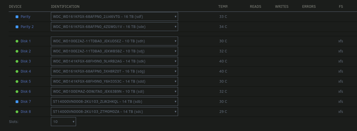

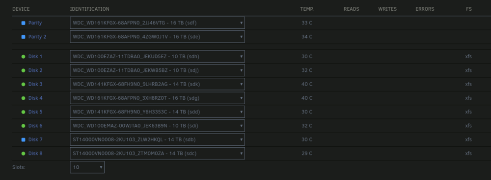

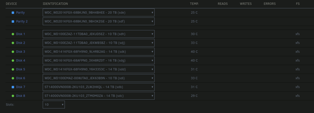

The remaining issues is that both Party disks and Disk 7 are being detected as new disks and I am unable to start up the array at all.Screenshotfrom2024-12-0814-14-15.thumb.png.96bb208226aca724a9f0495f7fdf19be.png
This image is the New Parity disks.
This image is the old Parity disks.
