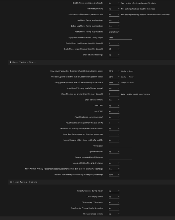

  1. So then how come if I turn off plugin filters then everything moves fine? Only when I enable filters then it doesn't work.
  2. I have the hard-links in the same user share (/mnt/user/data/media & /mnt/user/data/torrents) and didn't have this issue on 7.0.1 which I believe has those same changes from LT
  3. Usually the files get moved and the hardlinks are preserved. If you check the logs after the move it says "(Preserving Hardlinks)" This used to work with both unraid move and Rsync. Now my files only move with Rsync.
  4. The files are not in use, but yes they do have hardlinks. It was working before I updated to 7.1.4, when I was on 7.0.1. Are you saying files with hardlinks can't be moved?
  5. When using the "move" tool nothing moves but when I use "rsync" tool the files moves. Can you please take a look?ca.mover.tuning-debug-20251021-0831.zip
  6. ca.mover.tuning-debug-20250913-2338.zip Look at the latest attempt, I flipped it back to "move" for that one.
  7. Move used to work for me but now that I'm on 7.1.4 I have the same issue. Says it will move ~600+GB but nothing moved, had to switch back to rsync... Rsync isn't preferred to me because I get errors like this: Moving "/mnt/cache/./data/media/movies/The Piano Teacher (2001) {tmdb-1791}/The Piano Teacher (2001) {tmdb-1791} [Bluray-1080p][Opus 5.1][x265]-LSt.mkv" "/mnt/cache/./data/torrents/cross-seeds/Aither/The.Piano.Teacher.2001.French.Criterion.1080p.BluRay.10bit.x265.Opus.5.1-LSt.mkv" "/mnt/cache/./data/torrents/radarr/The.Piano.Teacher.2001.French.Criterion.1080p.BluRay.10bit.x265.Opus.5.1-LSt.mkv" to /mnt/user0/ (preserving hardlinks) rsync: [receiver] stat "/mnt/user0/data/torrents/radarr/.The.Piano.Teacher.2001.French.Criterion.1080p.BluRay.10bit.x265.Opus.5.1-LSt.mkv.4Q6RIn" failed: No such file or directory (2) rsync: [receiver] rename "/mnt/user0/data/torrents/radarr/.The.Piano.Teacher.2001.French.Criterion.1080p.BluRay.10bit.x265.Opus.5.1-LSt.mkv.4Q6RIn" -> "data/torrents/radarr/The.Piano.Teacher.2001.French.Criterion.1080p.BluRay.10bit.x265.Opus.5.1-LSt.mkv": No such file or directory (2) rsync error: some files/attrs were not transferred (see previous errors) (code 23) at main.c(1338) [sender=3.4.1] Deleting empty folder: /mnt/cache/data/media/movies/The Piano Teacher (2001) {tmdb-1791}" The reason I get No such file or directory (2) is because the move failed (for that file) and the file is still on cache, so when it checks the array for it, it's not there. After 2 or 3 runs, it will eventually move successfully.
  8. Is there any easy way to run the old mover manually? I want to force move everything off the cache.
  9. But it does exist: (see atttached screenshot) I had this happen to about 5 files and it broke the hardlink. The log shows a period in front of the name not sure why: .The.Bikeriders. but it should be: The.Bikeriders. Also in the error it shows .zruUMe at the end of the filename, not sure why
  10. Running the mover like normal when I noticed this error: rsync error: some files/attrs were not transferred (see previous errors) (code 23) at main.c(1338) [sender=3.4.1] log: https://pastebin.com/TAjcQdGx Any idea why I got this error?
  11. I changed it to 30% and it's moving now, but says only 29 GB. Should be moving a lot more to get down to 30%

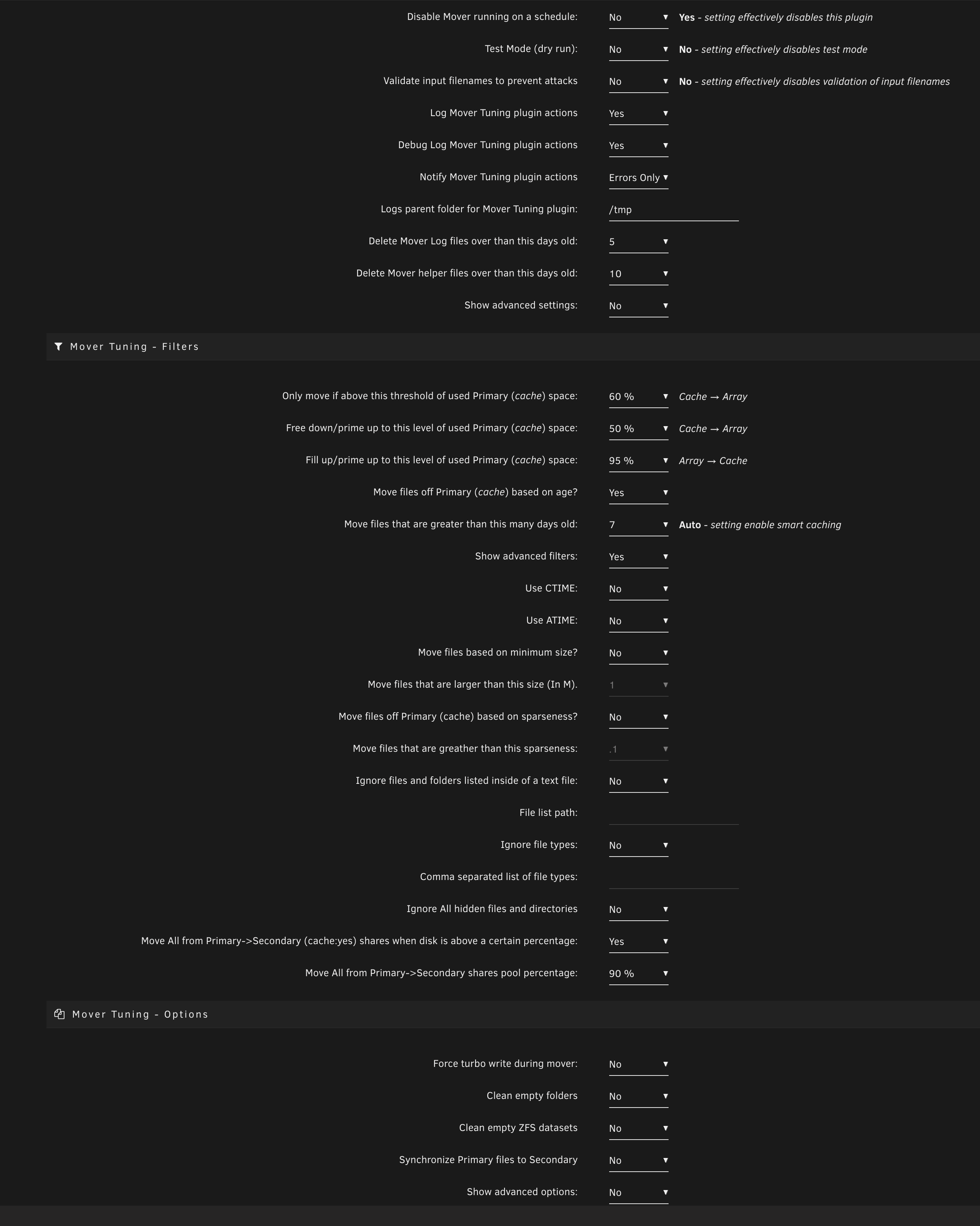

  12. I did change it to 7 days and still nothing, the logs I posted above are for 7 days.
  13. Here are all the logs I could gather from a new run, changed move files greater than to = 7 days Summary_2025-04-10T093216.txtMover_tuning_2025-04-10T093216.logMover_action_2025-04-10T093216.txtFiltered_files_2025-04-10T093216.txtDebug_Mover_tuning_2025-04-10T093216.log
  14. Filtered_files_2025-04-09T163520.list Here is the file list, this one is not empty. Please let me know what else I can provide for more insight Thanks!
