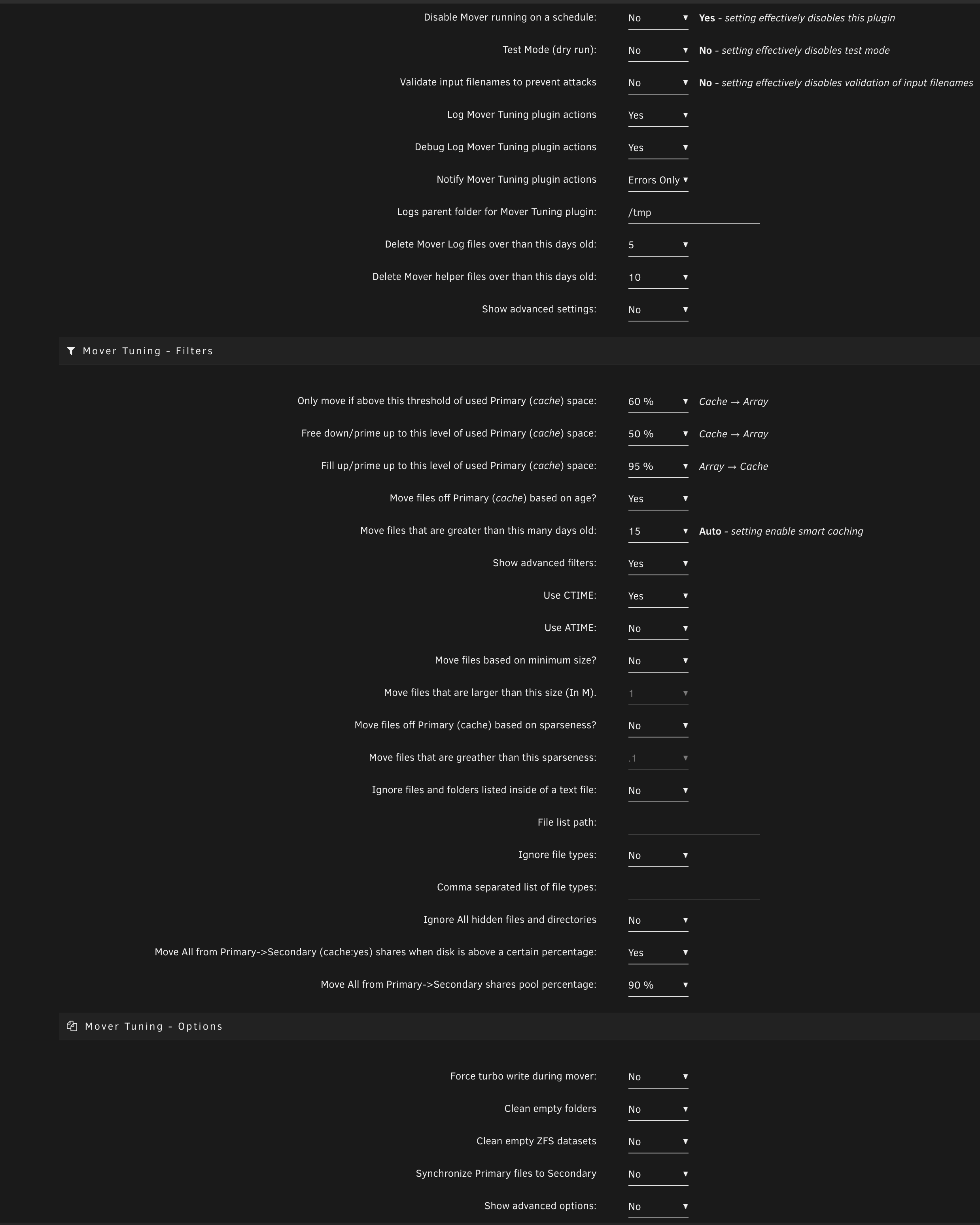

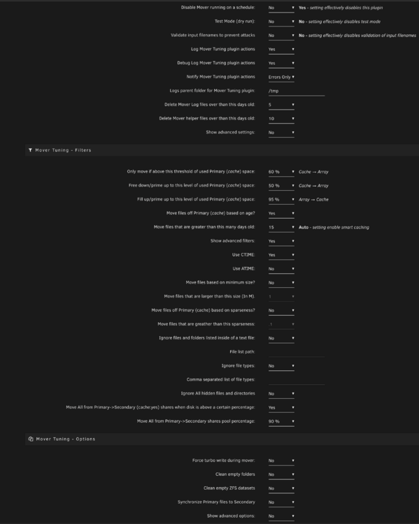

I'm running the mover but nothing is moving even though conditions are met and after looking at the attached logs they are empty? The log gets generated after running but doesn't show anything inside. What next steps can I take to troubleshoot? Thanks! Debug_Mover_tuning_2025-04-09T163520.log Summary_2025-04-09T163520.txt log.txt
