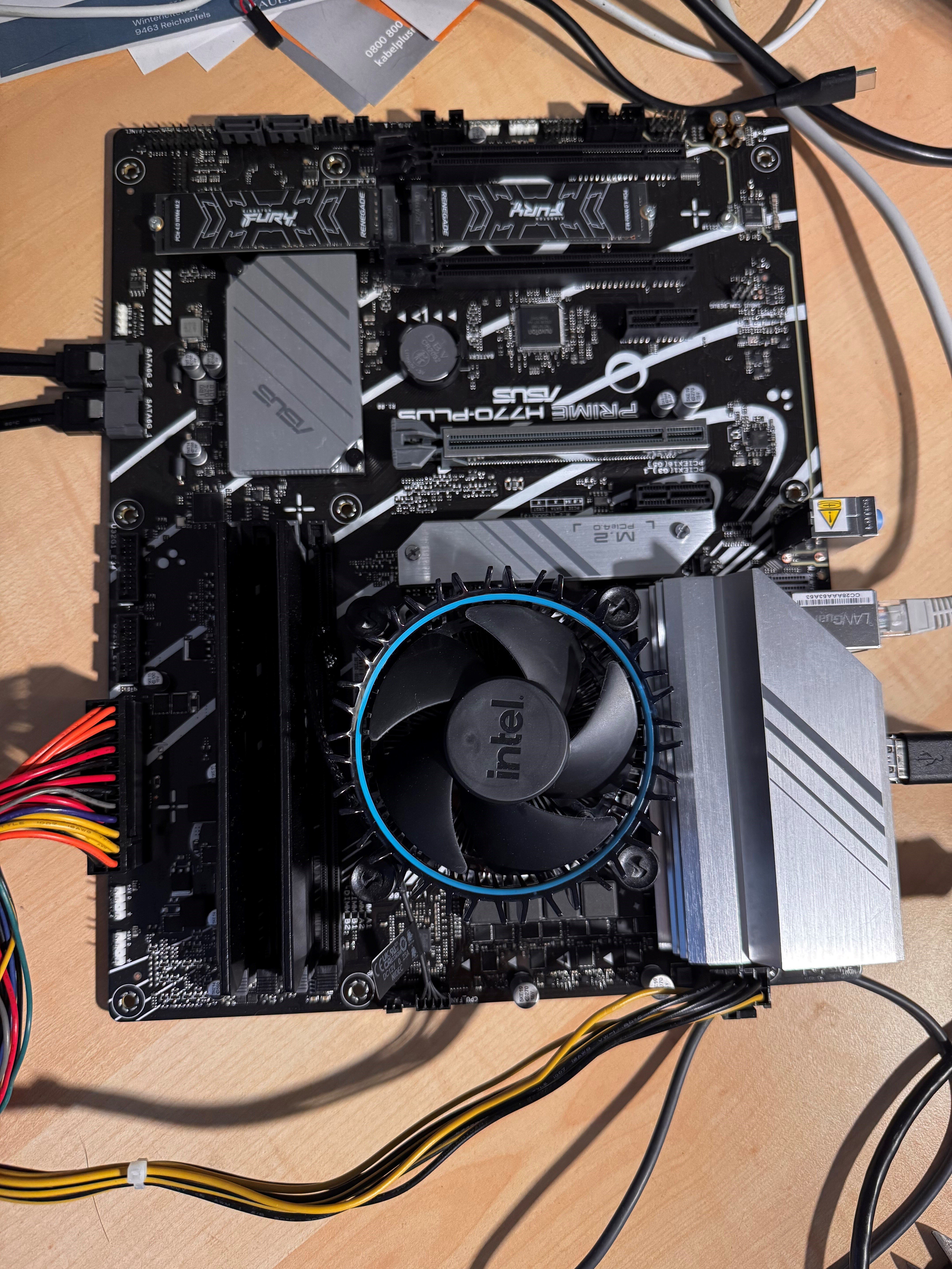

  10. Hello all! I'm pretty new into Unraid, but figured to use Unraid for my next NAS build. I built a new system and setup Unraid and I was confident to buy the license. I like the features and the apps and plug ins. I was almost ready to move all my data to the new build, when I found an issue with my NVMe's. First here is my hardware setup: Mainboard: ASUS Prime H770-Plus CPU: Intel Core i5-14400 RAM: Crucial Pro DIMM Kit 32GB, DDR5 NVMe: 2x Kingston FURY RENEGADE SSD 2TB, M.2 2280 PCIe 4.0 x4 HDD: 2x Western Digital WD Red Pro 16TB I installed the latest version of Unraid, used the two Kingston NVMe's for cache pool and the two WD HDDs for the array. The system was up and running for more than a week, everything stable and working. Than I wanted to take a look on power consumption and temperature. I found that the NVMe's were realy hot (around 75 Celsius) and also the power draw was hefty. I tried a lot of different things (see a post in the German Sub Forum). Long story short: For comparison I booted from a live linux (Ubuntu) with the exact same hardware setup. Here the NVMe's only reached 30 Clesius and the power draw was significantly lower. When I disconnect the SATA HDDs and boot Unraid, the temperature of the NVMe's was 30 Celsius too. But as soon as I connected the HDDs back, the temperature of the NVMe's rises to above 70 Celsius within minutes after booting. Another weird thing I noticed was the "Error Information Log Entries" value of the NVMe's. I retrieved that through smartctl on the cli. When I boot the system from my live linux (Ubuntu) this value does not increment at all. When I boot Unraid without the SATA HDDs connected, this value does not increment at all. Only when I boot Unraid with the SATA HDDs connected this value is incrementing continuosly. Increamenting roughly by 30 every minute. See the screenshot above. It apears to me as if the operating system is trying to repetively send varios commands the NVMe with an invalid field. Unfortunately I couldn't find any information what is doing that or what invalid field there could be. I am at my wit's end and have no idea what else I can do to get to the bottom of this. I can provide more information about the setup and the system if it would help anyone. Otherwise I am desperate for any tips. Especially since the Unraid license is about to expire and I would only buy Unraid if I can get my setup to work.

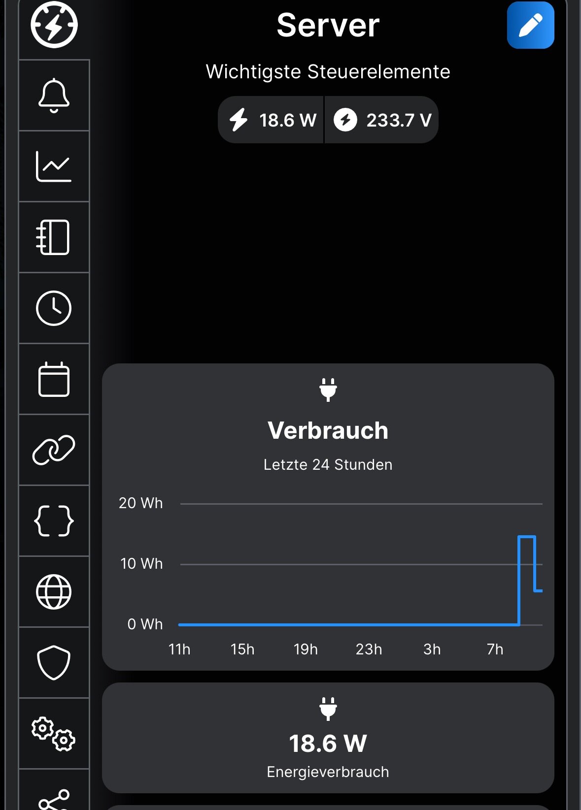

  15. So ich habe nun versuchsweise Ubuntu Server installiert. Bios Einstellungen unverändert zu vorigem Setup mit Unraid. Die Kingston NVMe fühlt sich kühl an. Kein Vergleich zum ersten Setup, da verbrannt ich mir die Finger. Ubuntu Server: smartctl zeigt mir eine Temperatur von 30 Grad Celsius an (siehe Screenshot 1) Temperatur sensor 2: 80Grad Celsius (bin mir nicht sicher was der Unterschied ist) Im Vergleich dazu ein Screenshot von meinem NUC14: Leistungsaufnahme hab ich übrigens auch gemessen (mit einem Shelly Plus Plus). Das Ubuntu Setup braucht im Leerlauf 18,6W. Ohne Monitor und Tastatur/Maus Die Unraid Installation mit HDD Spin down war bei über 33W. Das muss ich aber nochmal verifizieren. Irgendwelche Tipps wie ich weiter analysieren kann? mfg Thomas
