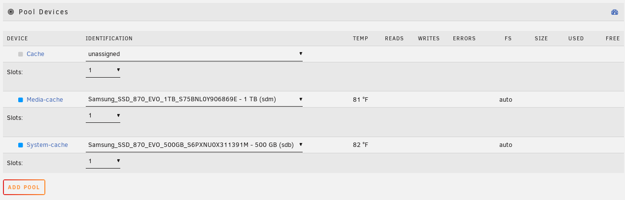

Haha well that ended up being a simple fix. Array started without issue. I've spot checked a few things and seem to have access to everything with no issues but let me know if you'd recommend checking anything else. Again I really appreciate the help you all are lifesavers! Below is the btrfs if show results if that is still helpful. root@TowerArchives:~# btrfs fi show Label: none uuid: 4ec52a98-d674-4da6-997e-0a4b9d027f30 Total devices 1 FS bytes used 144.00KiB devid 1 size 931.51GiB used 2.02GiB path /dev/sdm1 Label: none uuid: 1a45a4a6-246b-4f7c-83cf-9388f7c27b6c Total devices 1 FS bytes used 128.59GiB devid 1 size 465.76GiB used 160.02GiB path /dev/sdb1 Label: none uuid: f7effdea-9855-4791-831c-8501b27a9d69 Total devices 1 FS bytes used 9.34GiB devid 1 size 20.00GiB used 17.02GiB path /dev/loop2

Excellent, the assignments you listed match what I have from my notes so high confidence that they're correct. Unfortunately, when I tried to start the array (with drives assigned and Parity Valid box clicked) I still get the "Wrong Pool State Cache - missing devices" error. Unsure if this is related but my Pool Drives does list an unused Cache device with nothing assigned to it. I'm unsure what it is and can remove it if we think that may address the issue. Here is the output from btrfs fi show root@TowerArchives:~# btrfs fi show Label: none uuid: 1a45a4a6-246b-4f7c-83cf-9388f7c27b6c Total devices 1 FS bytes used 125.70GiB devid 1 size 465.76GiB used 159.02GiB path /dev/sdb1 Label: none uuid: 4ec52a98-d674-4da6-997e-0a4b9d027f30 Total devices 1 FS bytes used 144.00KiB devid 1 size 931.51GiB used 2.02GiB path /dev/sdm1- Missing Cache Pool and New Config Broke Array After 7.2.3 Update – Need Recovery Help
