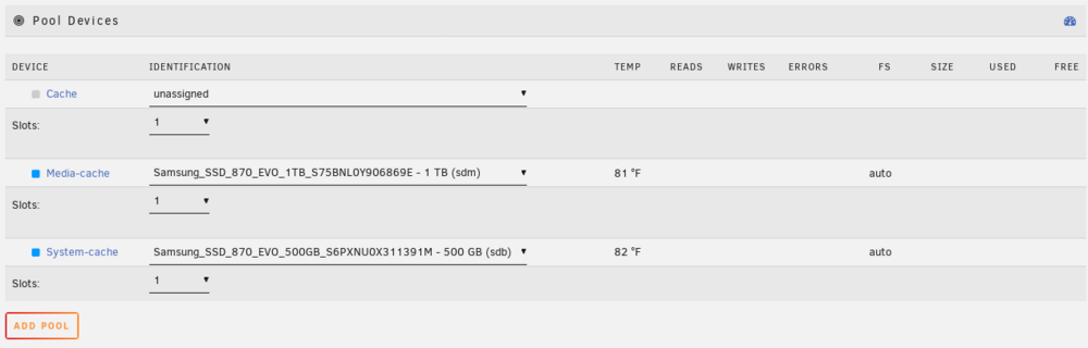

Post a screenshot of Main - Pool Devices
If nothing is supposed to be assigned as cache, change its slots to zero and see if you can start.
Haha well that ended up being a simple fix. Array started without issue. I've spot checked a few things and seem to have access to everything with no issues but let me know if you'd recommend checking anything else. Again I really appreciate the help you all are lifesavers!
