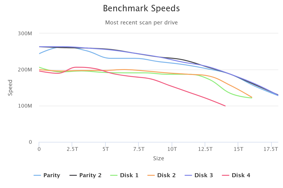

  4. Hello, Just looking for some advice and feedback. Have been running the wonderful DiskSpeed plugin from jbartlett777 and noticed that my Parity 1 disk doesn't have a smooth speed curve and is a little slower than the other parity drive and one of the data drives meaning it's a slight bottleneck to the array write speed. It's not critical, but given that I have two parity drives and Disk 4 will at some point fail and be swapped with a larger faster drive, I'm thinking to swap Parity 1 and Disk 3 now. Would love if someone more experienced than me with such things could sanity check this thought and confirm if they would do the same in this situation? If it is reasonable to do this, would an efficient (and safe) method be the following: Drop Parity 1 as a Parity drive and then add it back as a Data drive (would Parity 2 become Parity 1 automatically or could this be explicitly configured in some way that means there's always parity coverage?) Allow parity to fully rebuild Use Unbalanced to move (or copy?) all data on Disk 3 to the new data drive Remove Disk 3 as a data drive and re-add it as a Parity drive (either Parity 1 or Parity 2 depending on step 1) Allow parity to fully rebuild I'm not super experienced with this stuff, so any warning or insights appreciated.
