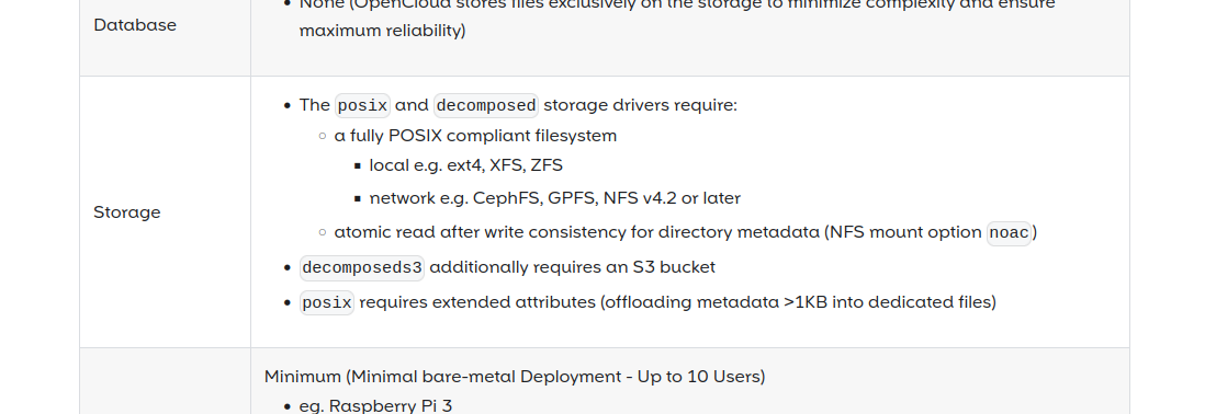

Honestly I did not try this because for my usecase the FS has to be POSIX compliant. SMB needs an extension to fullfill this. Native SMB is not (yet) supported. Requirements | OpenCloud DocsRuns on anything from a Raspberry Pi to a data center.

Hey, Yes and no. The No: Honestly I did not try to get this work since a couple of weeks (or months in the meantime), because this was so frustrating drove me nuts. I hoped that any unraid maintainer would be interested in this but obviously this issue is not that "relevant". I guess there is occurs an issue somewhere between the both OS (unraid and alpine). I found a couple of posts in several forums about this topic. There definitely was an issue in the Kernel which had an impact of xattr and NFS. But according to my investigation this issue was solved in the Kernel's which are used by unraid and the alpine version I used. But.... What I found out, that these problems occurs not only in the combination alpine <-> unraid. I ran into the same error using Debian (I think I took trixie). The Yes: If this is not strange enough, with Ubuntu Server 24.04 it worked as expected. So, in case you do not need a real tiny base OS, give Ubuntu Server a try. Only a few thoughts: According to the Opencloud manual it is important that NFS-Version 4.2 is supported and used. On Server- and Client-Side. Well, nice to know but this is no guarantee because according to the specs from Debian and Alpine, both should support this version. Maybe I am to dumb or naiv but that lets me think there is something wrong on the unraid side. But on the other hand, it is working with Ubuntu Server. Since NFS and xattr are (more or less) standardized, I am wondering if the behaviour of the OS's differ somehwhere (Kernel) how to deal with it. In case you have further information or thoughts, please share here. I appreciate that. Update: Regarding the part I mentioned, that Ubuntu Server fixed this issue: I can not confirm that Ubuntu brings a solution. For whatever reason I am not able to reproduce it.
