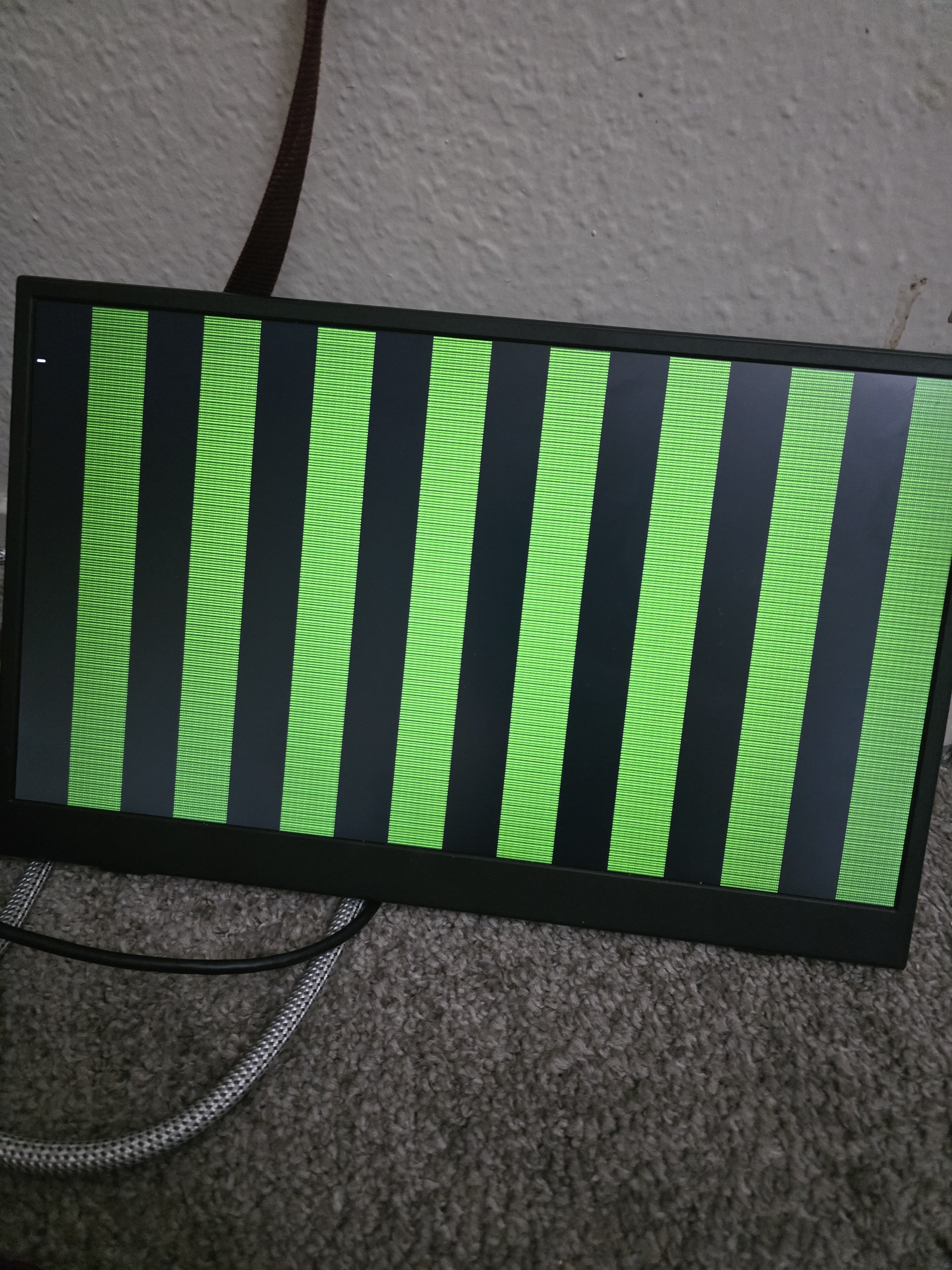

  2. I've attached the diagnostics, don't know how much it'll help with how sudden it seems to crash, but maybe it'll help. As I was hard rebooting it (again), it started and crashed again, but got this artifacting: Rebooted again, tried a quick memtest and the system rebooted without any errors being thrown. It's super unlikely two completely different kits of RAM are both bad (especially since the kit I threw in was in a working system until a few months ago with zero issues. There's no GPU in the system, either. So, it feels like this artifacting might be RAM related, but the RAM has already been replaced with a known working kit. Could it be the iGPU? Don't know if that could cause the system lock up like this, though. Maybe the ram slots on the motherboard? I'd really like to avoid taking this to a computer repair place (since I just took it there a month or so ago to confirm the drives were dead.), especially with this being such an inconsistent issue. I can go eight hours with constant transferring and no issues, and then another time go 2 hours with no transferring before getting a crash/freeze. mfnas-diagnostics-20250427-1911.zip
  3. Welp. Looks like it happened again. No idea what could be causing the NAS to lock up like this. Bad OS drive? Maybe CPU?
  4. Just a quick update: I managed to find a 32GB 3200mhz kit of T-Force RAM buried in my closet. Figured that was more than enough to just test with. I'm knocking on all the wood right now, but so far so good after a few hours straight of transferring files. Seems like it was a bad kit of RAM (as of right now.). Will update in a few days, assuming nothing happens.
