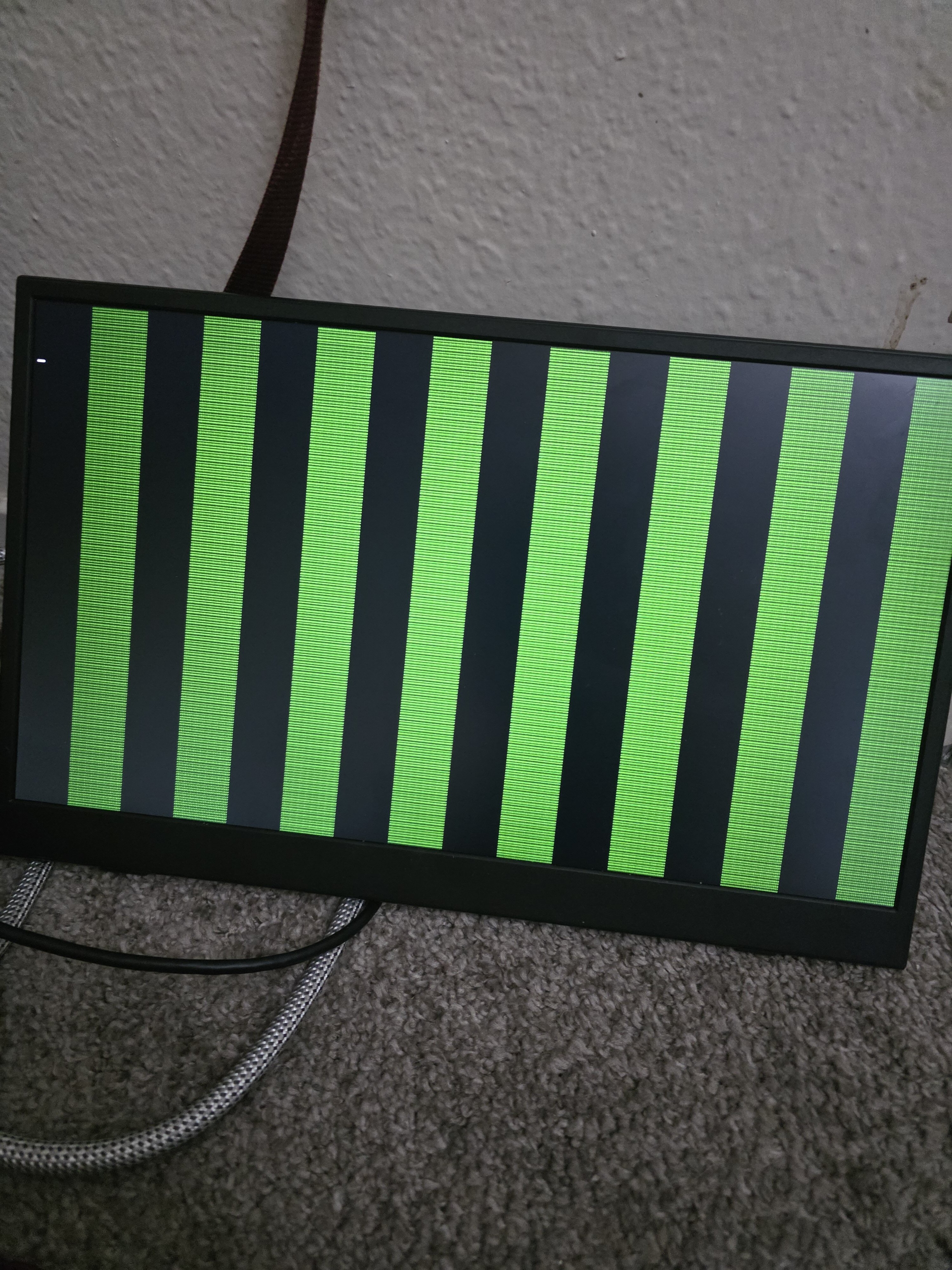

As I was hard rebooting it (again), it started and crashed again, but got this artifacting:
Rebooted again, tried a quick memtest and the system rebooted without any errors being thrown. It's super unlikely two completely different kits of RAM are both bad (especially since the kit I threw in was in a working system until a few months ago with zero issues.
There's no GPU in the system, either. So, it feels like this artifacting might be RAM related, but the RAM has already been replaced with a known working kit. Could it be the iGPU? Don't know if that could cause the system lock up like this, though. Maybe the ram slots on the motherboard?

It looks like the culprit was a bad/faulty/unstable CPU. One of the previously used parts I put in. I bought a new 5700G and put it in Monday night.
Ran a memtest for about 40 minutes (with C States off, along with PSU typical idle), and transferred a 100GB folder and then a 200GB folder, along with some 20GB-ish folders I had laying around. Just to test it a bit more. Still knocking on wood, but so far so good. May or may not put the 64GB of RAM back in, but will probably wait until either put in a cache drive or have to open it up again.
