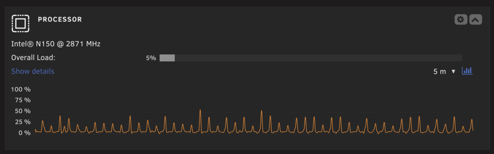

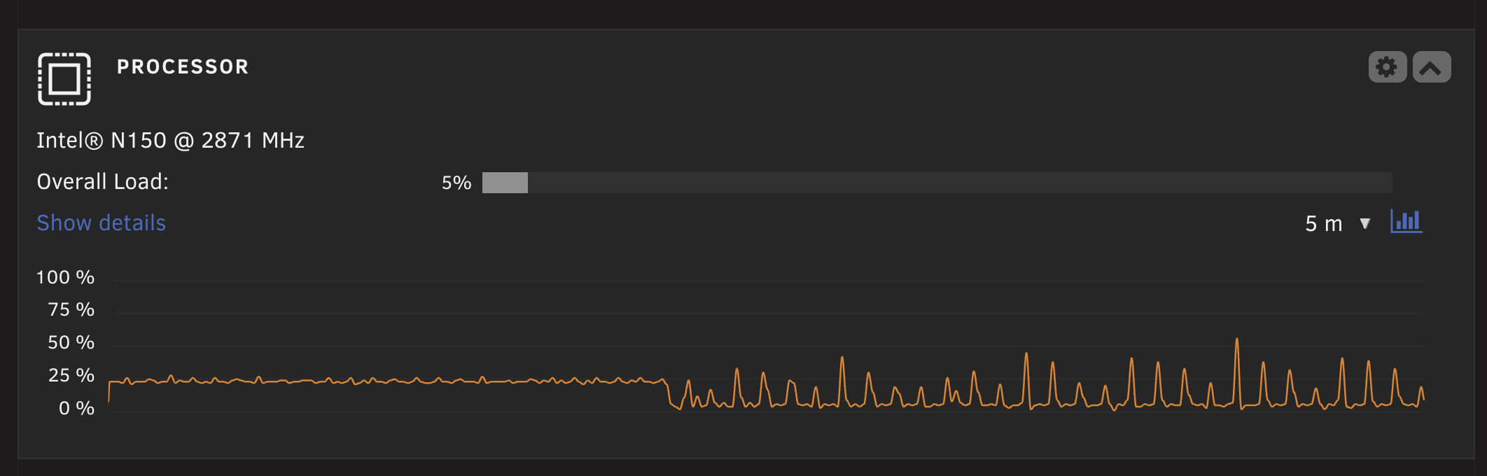

  3. Spikes hardly appear at all during a parity check, for example. And as soon as it's over, it starts all over again. At the beginning, the parity check was in progress and ended halfway through the graph.

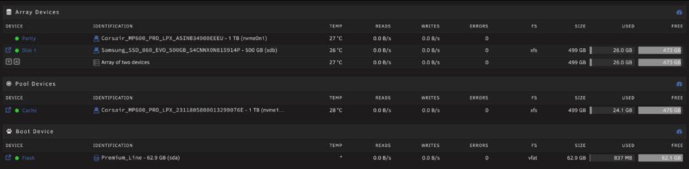

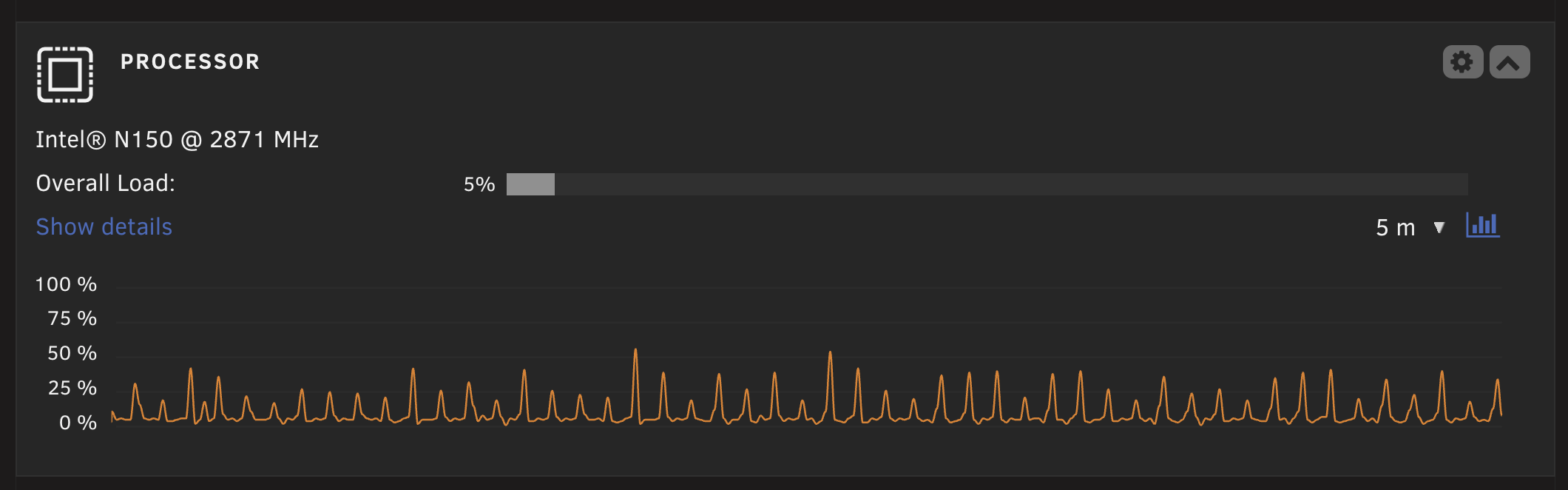

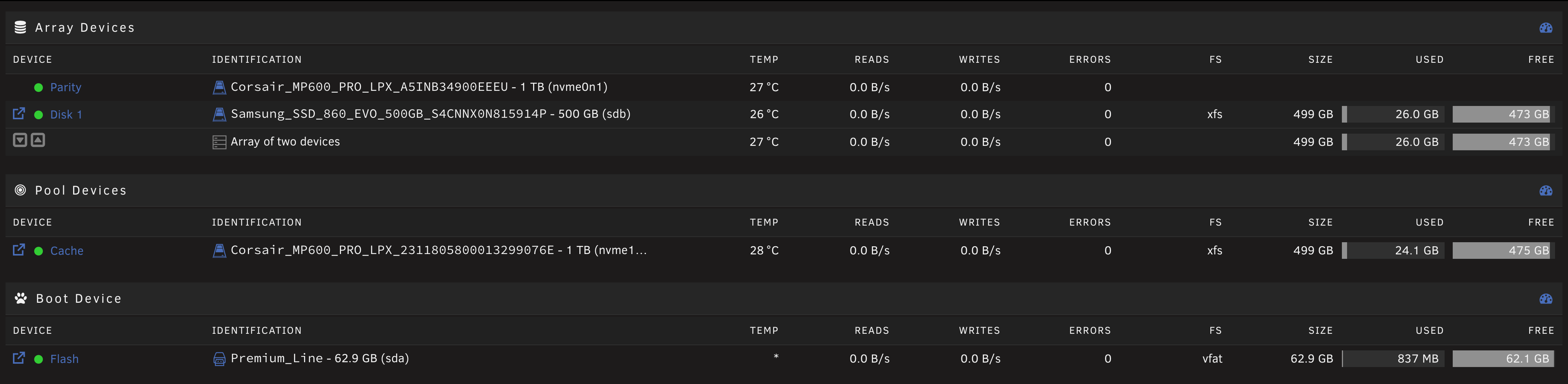

  4. Thanks for help. CPU pikes are visible in the GUI in safe mode too. If I disconnect from the GUI, everything is normal. cpu cores do not exceed 1%. If I log in, I have 2-3 cores that go up to 4-5% every 4-5 seconds...
