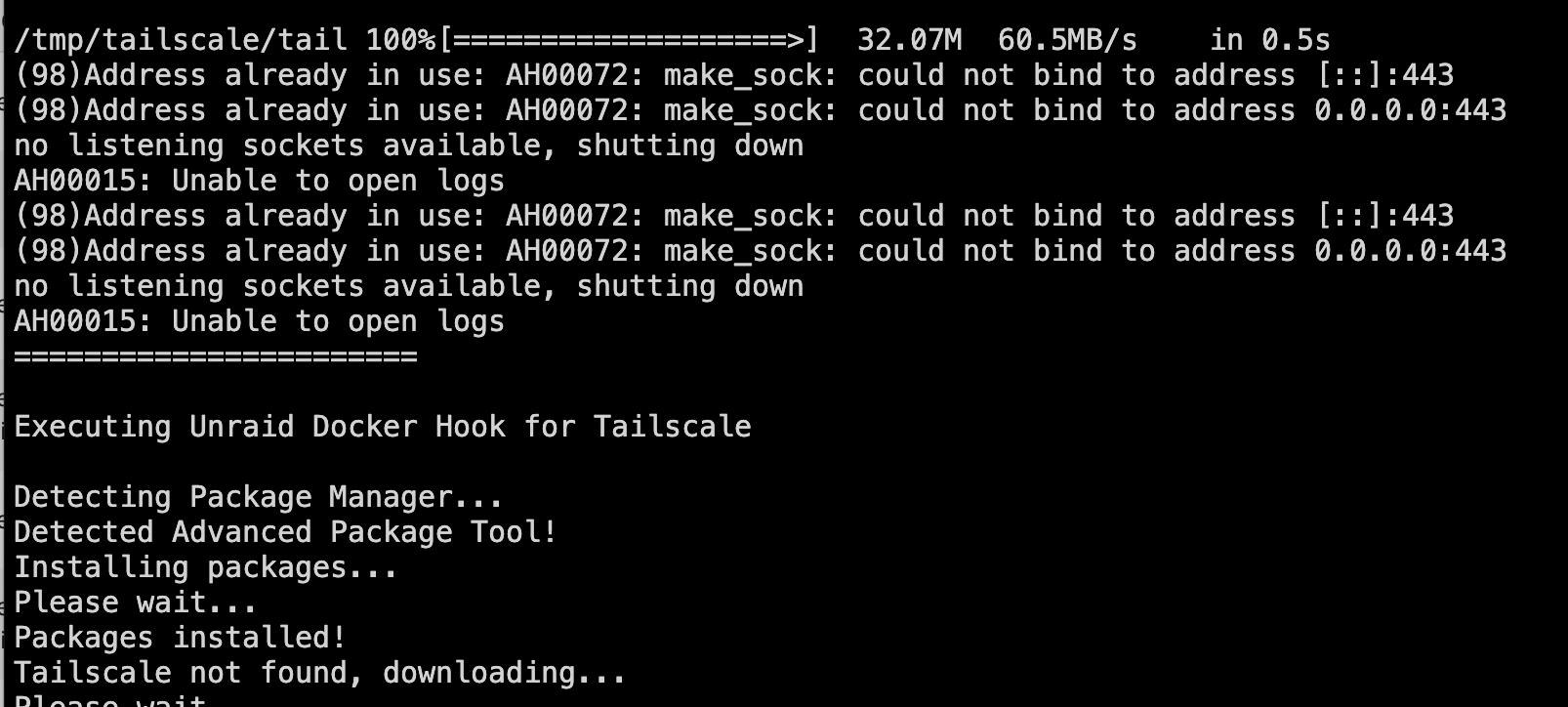

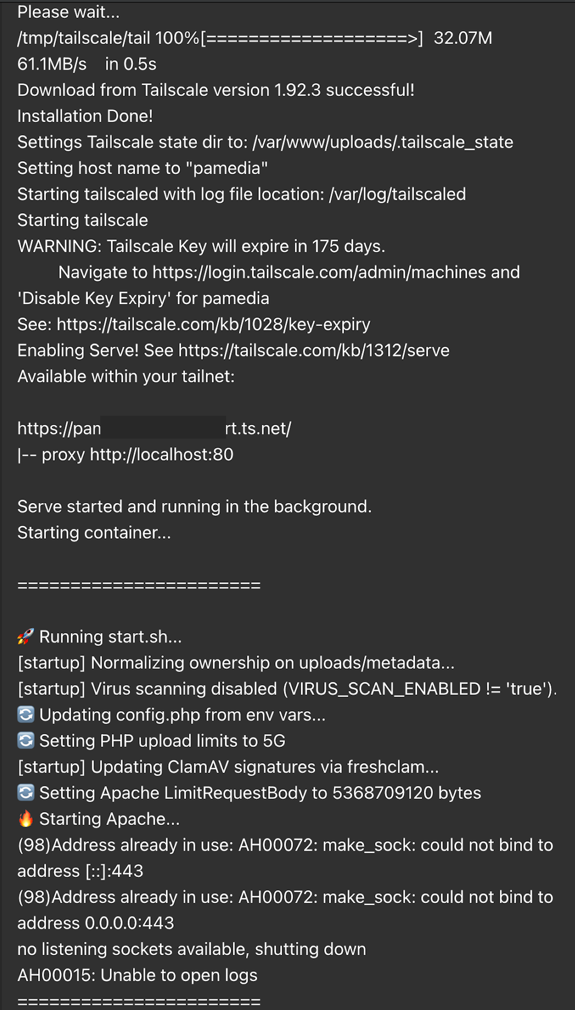

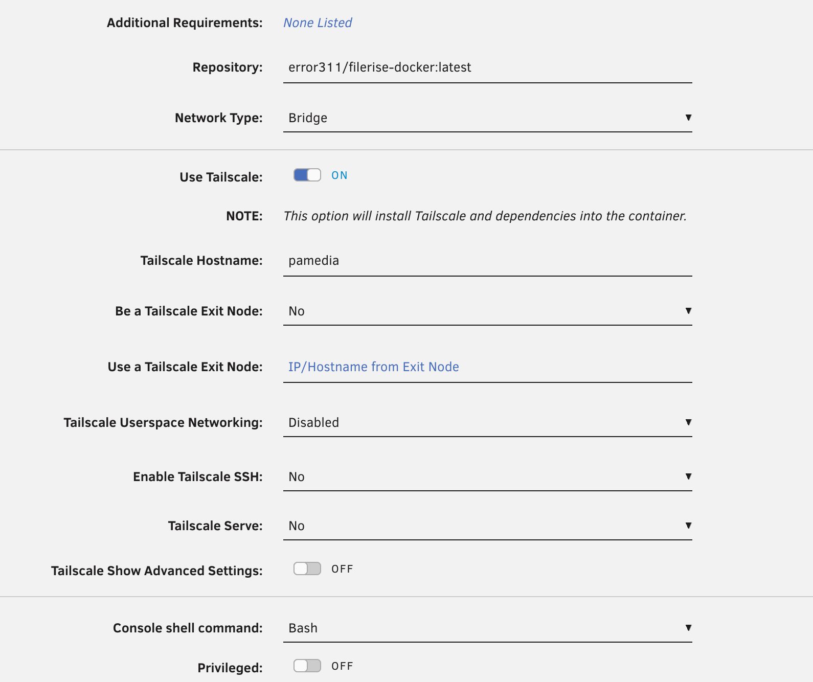

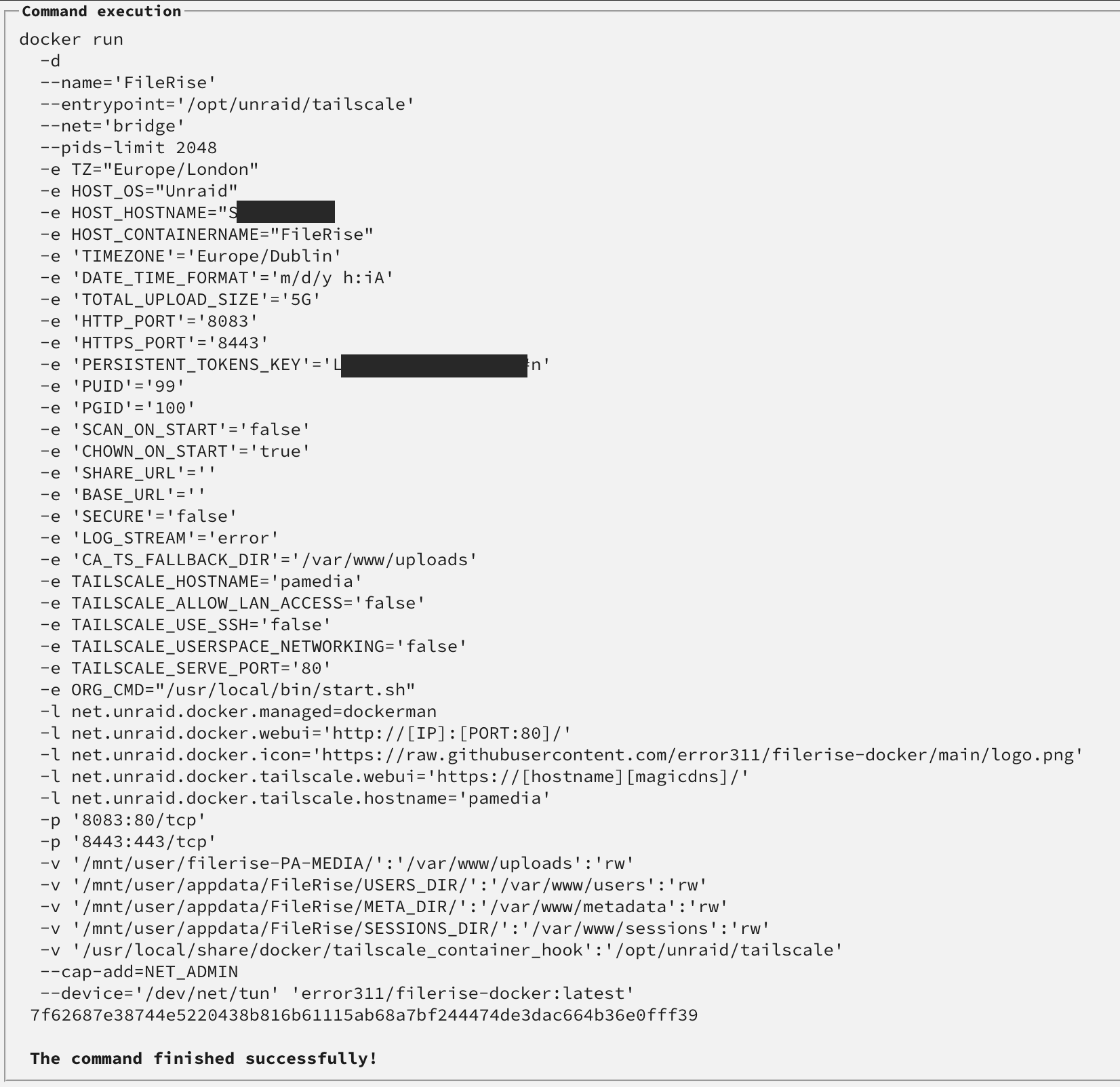

  1. Ok thanks. My problem is that the container doesn't start with any of the options I tried, including the fix options you mentioned. Or I did it wrong. It set Tailscale Serve to No. Is that what you mean by not using it?
  2. Thank you @error311 . I tried all combinations of port mapping, but it seems that even when HTTPS is left blank, Apache 443 still tries to connect. Since the Apache server is not starting for me at all, I have no way to access your link:port address suggestion. I tried to turn off Tailscale serve, hoping it would stop using port 443, but no luck. This is the Docker log: Docker run With Tailscale off, the container is running fine. Do you see any issues with my port setup?
  3. Nice app. Love the demo and excellent developer communication I have seen. Kudos! Looking for a new decent file manager for my media server, and this looks very promising. Unfortunately, I have trouble getting Tailscale to work, which I usually use for all my containers. With tailscale disabled, the container starts fine. (Since I'm doing it remotely, I wasn't able to check local access.) With tailscale turned on (serve) I'm running into the 443 conflict as shown in above screenshot. I tried a few things, including deleting the https port variable, but no luck so far. Any advice on getting Tailscale to work with Filerise? Or is there a better, more/same secure way to remote access?
