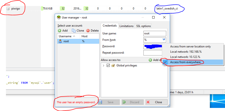

MariaDB doesn't know that piwigo is on the same LAN in effect as the 172...... ip address is a docker internal ip address.  You will need to use HeidiSQL to modify permissions to allow access
So internally the dockers communicate on a VLAN in the 172.* range? Essentially...
Awesome! How do I do that? It's been a mighty long time since I've done DBA type work - like Oracle 7.x was current... I've been doing some MSSQL work more recently, but not administering the server or dealing with permissions.

Thought you were using HeidiSQL?
I've edited out my username, assume it said root (it didn't)
Tools ==> User Manager
I am using HeidiSQL. If you'll note, my original post said "I got HeidiSQL installed" - i.e. I'm not 100% certain what I'm doing in there, but I am using it!  ;)
  • I checked the user settings, and it was set to "%" as you showed it. However, it says that my root user has an empty password despite there being a hashed value of some sort in the Password field - is that a concern?
  • I set "From Host:" to "localhost", saved it, then reset it to "Access from everywhere", and I'm still getting the same error.
  • I granted root access to the piwigo database (after I took the screen shot - realized what was different between yours and mine) - still couldn't get access.
  • Without any changes at HeidiSQL, I uninstalled piwigo, deleting the container, deleted the entire piwigo directory tree from the mapped /config location, then reinstalled. Still getting the same error.
Don't know what else to suggest other than wipe both the appdata of MariaDB and Piwigo and try again.  FWIW I've just got it up and running without issue.
