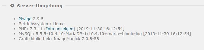

I have a running installation of Piwigo via docker. I stopped all containers, I even deleted all images, containers, btrfs-subvolumes and made a complete reinstall of docker with a cleaned /var/lib/docker directory and with newly pulled images. But after that Piwigo still shows me a version number of 2.9.5. I did not removed the config directory because I did not want to loose my setup of Piwigo.
So, what did I do wrong? Do I have to clean up my config directory in order to get 2.10.1? Or do I have to update via the webfrontend of Piwigo?
Edited by Major Tom
I'm having the same issue as Major Tom, my Piwigo is still showing 2.9.5 with the latest update and I'm not getting the new features that 2.10 is supposed to have.
I tried changing to the latest tag but doesn't seem to have done anything(not sure if I did it correctly)
Also, the Dockerhub page is giving a 404 error atm.

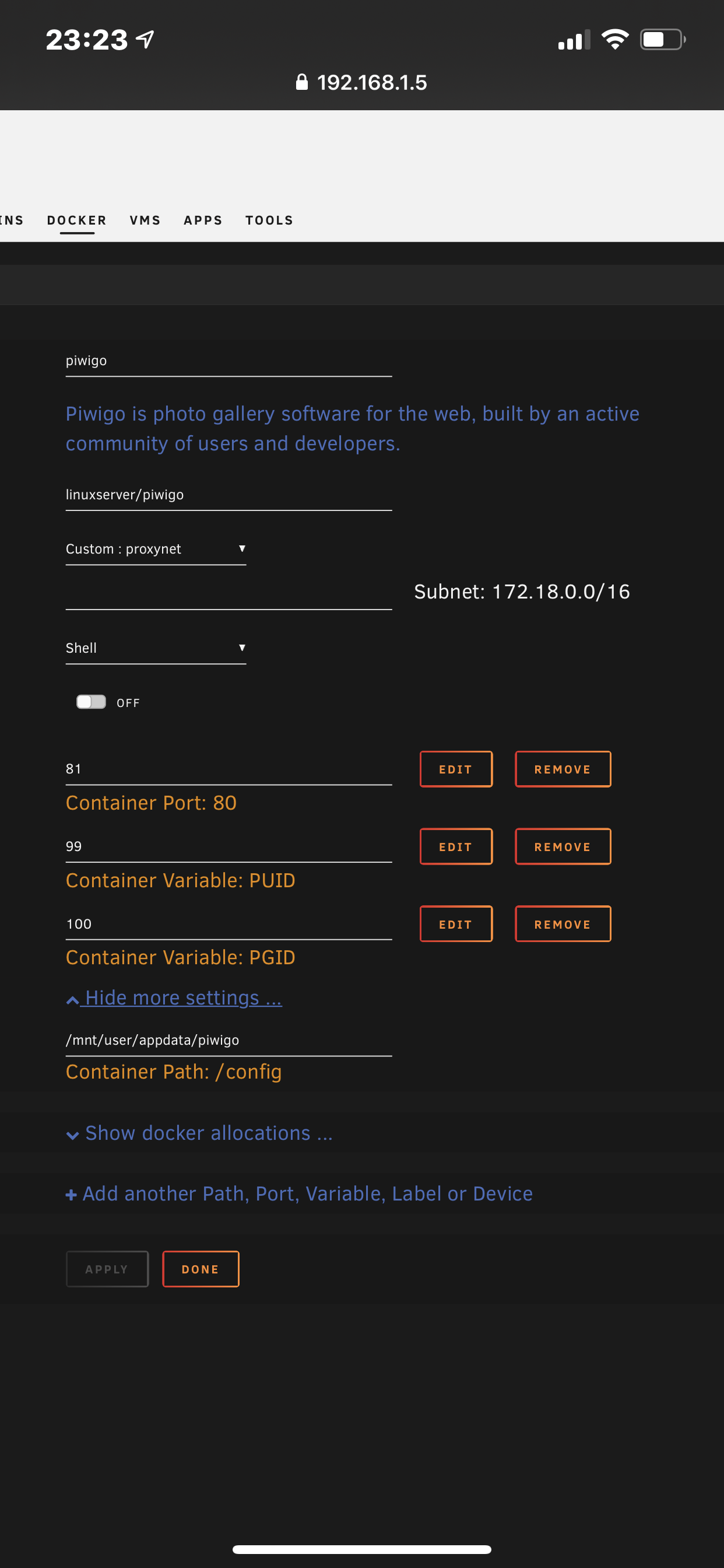

Excuse the newb here but...
Installed piwigo and got DB working and reverse proxy etc...
it appears it’s saving actual pics uploaded to appdata/piwigo/www/gallery/upload/2019/12/02
Is where this saving pics going to cause my docker.img to fill up? If it’s not saving pics in a good place now can I move just where it saves pics? Not sure if that directory is part of docked.img or not but I know I don’t want docker.img to fill up.
Any advice would be awesome?
Thanks!
I'm going to answer that with a question and you will hopefully understand where to images are stored.
Where is you appdata folder located?
