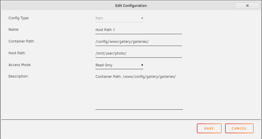

  • Since there doesn't seem to be an all-in-one  tutorial on the web.   Linking shares to container   Step 1 - permitted characters: Piwigo doesn't like spaces and non-englisch c
  • Even though I created a new "Path" Variable and set the Container Path to /config/www/gallery/galleries/ in the docker, this is still uploading photos.  I'm assuming this is making duplicate copies of
  • My recollection is the same. I used mariadb for the database, and it worked, but I didn't like having to import and using twice the storage space. I'm still looking for a photo solution.
Ok did a separate install and so far so good... pretty fast on my cache drive
One thing I think there need to be some seperate setup og write access to the config file?
Warning: mkdir(): Read-only file system in /config/www/gallery/plugins/piwigo-videojs/include/function_sync2.php on line 157
Any input on how to solve this?
Piwigo doesn't like spaces and non-englisch characters. Your filenames are probably filled with them. If not, skip.
Start Piwigo and go to plugins and install "Local files editor".
Open this editor and in "local configuration" find
$conf['sync_chars_regex'] = '/^[a-zA-Z0-9-_.]+$/';
You can add or remove chracter to fit your needs. As long as you mind the UTF-8 encoding.
Latin languages $conf['sync_chars_regex'] = '/^[(a-zA-Z0-9-_.+&áéíóúàãõ@ )]+$/';
Germans $conf['sync_chars_regex'] ='/^[(a-zA-Z0-9-_.ÄäÖöÜüß@ )]+$/';
Etc
Keep your filenames civil and don't anger the html guys. & # ' " can be troublesome.
Special characters are also dependant on your os.
You'll find out in step 3.
Step 2 - make the link in unraid:
Add a path in the docker config.
Step 3 - sync the files/folders inside Piwigo:
Go to admin > tools > synchronize
This part is self explanatory. Don't forget to turn of simulation.

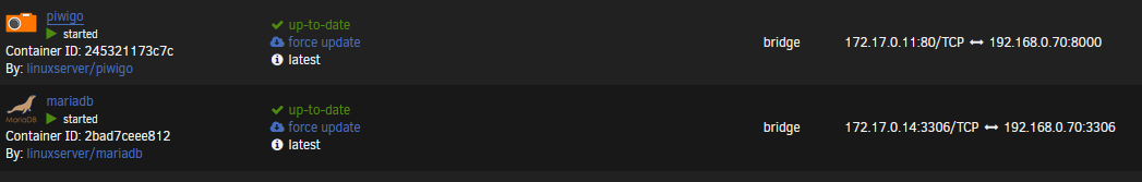

Hi There,
I cannot get Piwigo 2.10.2 working at all. I have tried a MySQL docker DB, and now a mariadb, it will not connect to the database. i've tried different IPs, Ports, created databases, users, tested a telnet to the db, no problems. but i am met with "Cannot connect to server" on every attempt. i am assuming that cannot connect to server means it cannot connect to the database.
tried  192.168.0.70:3306 or 192.168.0.70
Edit: Fixed it, it was a permission issue. I used the root user and pass and was able to install piwigo

Do you have a gallery directory in the /mnt/user/appdata/piwigo? Because I don't have it. There's a symbolic link in piwigo/www to /gallery but that doesn't of course work outside the container.
If I use the LocalFiles Editor plugin and save the edits, I can find the edited file under /gallery path, if I look for it inside the container. Aren't those files and edits lost when the container is restarted, because they exist only inside the container? What's the deal? Or are the edits also in the database?
Edit: Docker hub document instructs to expose /galley. I wonder why it's not included in the template. Pretty major thing to miss.

I have successfully installed the Piwigo docker from CA, but every time I edit the instance (to map a shared folder) I am presented with the Install.php configuration form again.
It doesn't look like any configuration files are being saved to appdata/piwigo which I guess means the docker drives are being blown away each restart.
Edit: has anyone else had this issue and managed to solve it?

I think you have the same issue as me. You need to add another path mapping in the container's configuration. See my post above.
That did the trick. Thank you!
