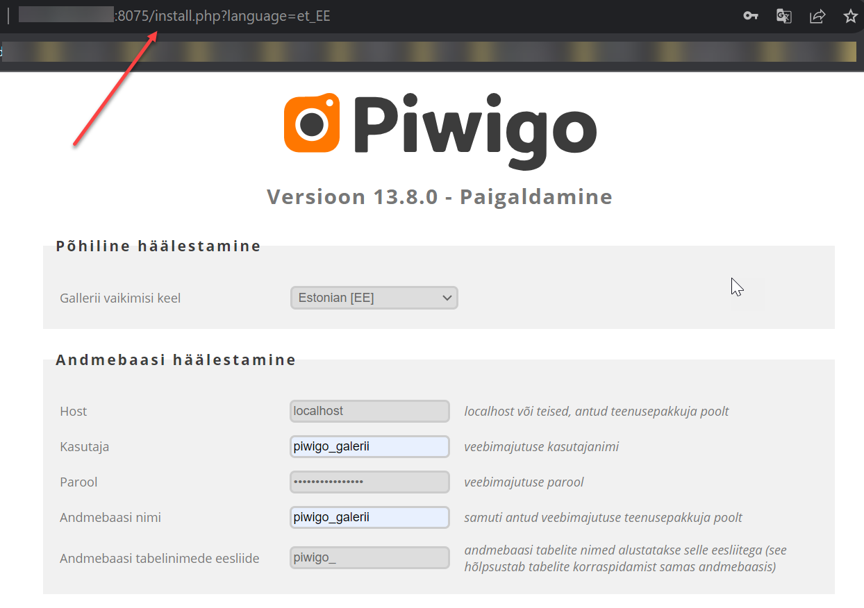

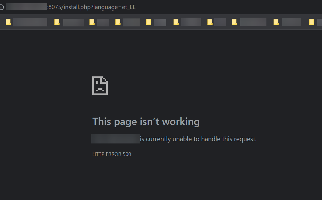

Problem with Piwigo installation. You can get the install page, but lose the server. What am I missing?
