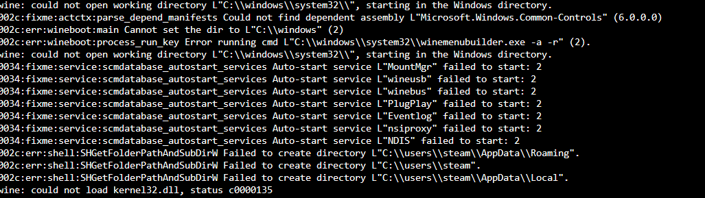

  8. Suddenly having issues with my Conan servers. Last thing i see in the log is Running on Unraid only mod is Savage Wilds. cache is set to preferred for appdata exiles and siptah maps also giving the same issue. Server/container just sits an a restart loop over and over.

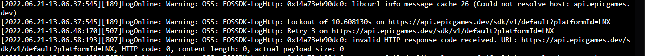

  9. And the only ports you are forwarding for Satisfactory are UDP 7777, 15777, and 15000 ?
  10. Issues with Satisfactory server - Seeing the below image in the logs I am able to reach https://api.epicgames.dev/sdk/v1/default?platformId=LNX, from a browser with no issues and nothing showing up odd in the firewall logs 3 other game servers running perfectly 2 conan and 1 Valheim. Satisfactory is using default ports other servers have been moved to other ports with no issues. unraid 6.10.2
  11. OK this is annoying - So its working now. Data populated to the folders and the server is showing in the game server list. Sorry to have bugged you!

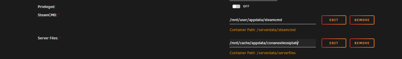

  12. To load the alternate map one would just have to edit the engine.ini file with the following text [/Script/EngineSettings.GameMapsSettings] ServerDefaultMap=/Game/DLC_EXT/DLC_Siptah/Maps/DLC_Isle_of_Siptah I saw the allow install of second instance option but when i tried but when i tried the following It created the server files folder but didn't populate any data to it. The default in your container was /mnt/cache/appdata/conanexiles/
  13. My config currently is a working docker from your repo for the exiles map. I am not sure how to create a second container that will load the siptah map to run side by side with the existing container. I understand how to adjust the ports but not sure how to establish a second database/docker container? My current container is working perfectly and shows in the server list in game. I just want to create a second one that loads a different map.
  14. That may be where my issue is coming in. How did you establish the second instance. Ports I can deal with no problem.
