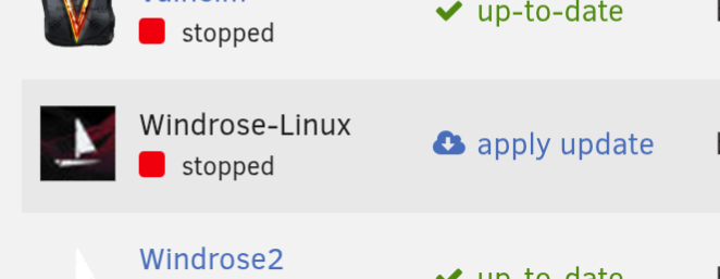

Updating the server
These docker doesn't contain any steam file or any game file. When a new update is release, the docker container is not updated since that only thing it contain is a script that download the steam client and launch it. Restarting the docker normally update the game just like the steam client does on your computer. BUT, it does happen that the client doesn't see the update for many reason. A quick fix in those time is to backup your config and save file, start a new container from scratch with empty appdata and then migrate your data back.
New version of a game server doesn't require a new version of the docker container.
