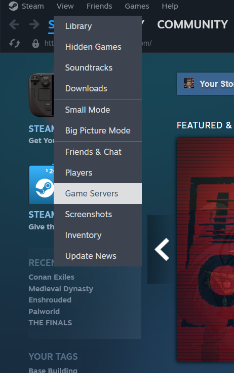

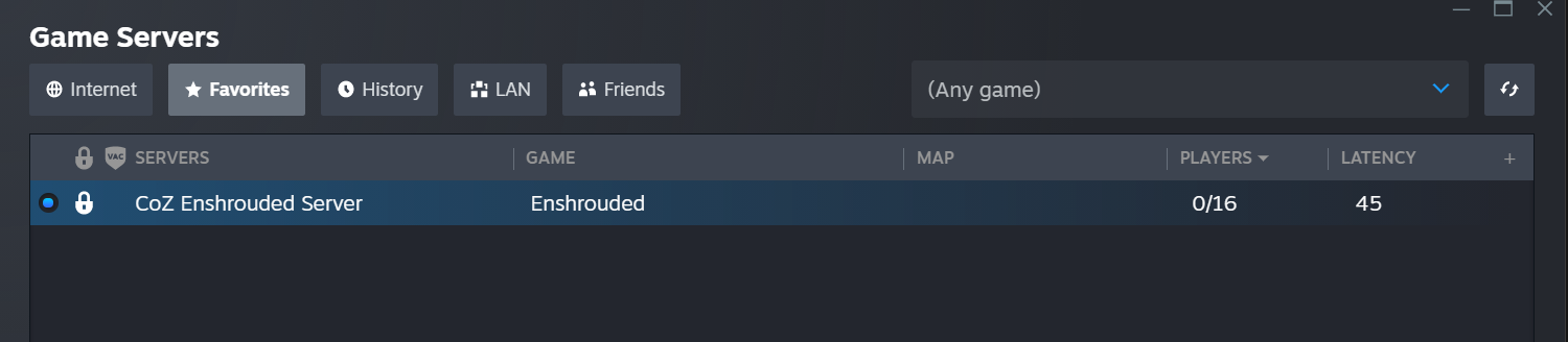

Open Steam.  Go to view at the top.  Then look for Game Servers on the drop down box.
Click on Favorites on the new window that pops up and look for the + sign on the bottom right of the screen.  This will allow you to manually enter in your WAN or LAN server's IP address.
This way you can see if it "resolves".  If it doesn't show up here, then there is something configured incorrectly.

Hey, thanks for the advise and SS's, but no joy still. It's saying "Did not find any servers at that address" and have the ports open on the FW. Even the LAN option in steam does not show the game.  I've not setup a dedicated game server in a long time, so i'm a bit rusty. Just cant seem to shake this last cobweb lose ><.
