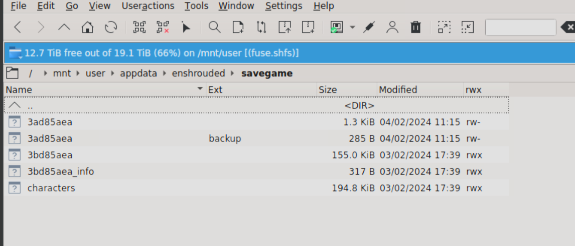

I have a similar issue. I copied my save files over, and they are replaced with new game files every time.  (the date is currently not correct, ignore it)

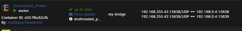

Just checked and there's 2, 1 for gameport and 1 for query port.
There's 2 of each entry, 1 is for the config file, the other is for the port forwarding.
Where did you see dual port allocation?
I'm using 2 container hence the different ports

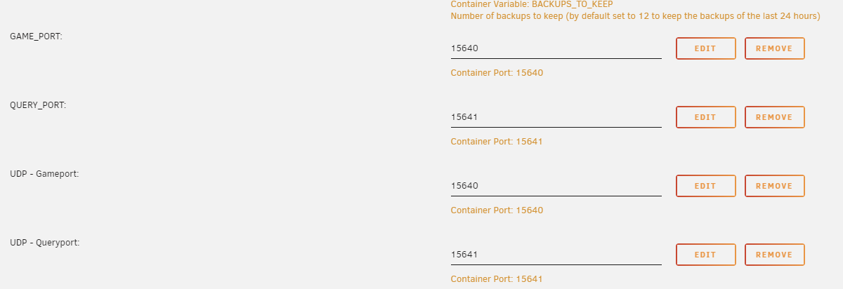

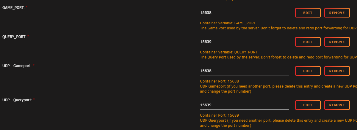

When I started the docker it tossed an error saying port already allocated and the docker cmd had 4 ports being mapped.. two dupes
*edit
I had to delete all four and readd them since I use different ports so perhaps that causes it?
Edited by melmurp
Weird didn't get that
This happens if I remove and readd them
It's because you create 4 port forward. You are deleting 2 that you must NOT delete that are variables and crucial for it to work. Restart from the template
Yeah, I just realized two are vars not ports :(

It's not the backup function. The new game files are not created until I exit the game after finding that the world is at the  starting state.  Permissions  were matched just in case, but that made no difference. It just refuses to use the original game file for some reason.  I just don't get it.
I really can't say, I have nothing that write to that folder, only read. All the rest are up to steam and the game. Unless you have something externally that change the permission of the folder and the game can't write anymore.
