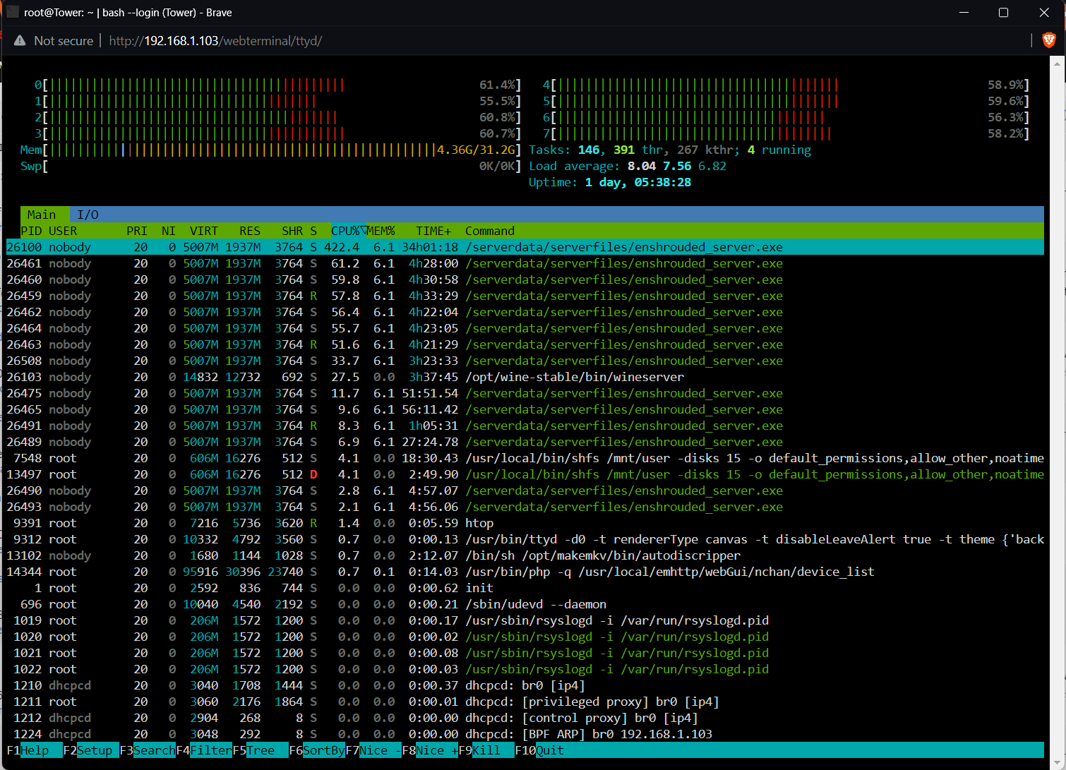

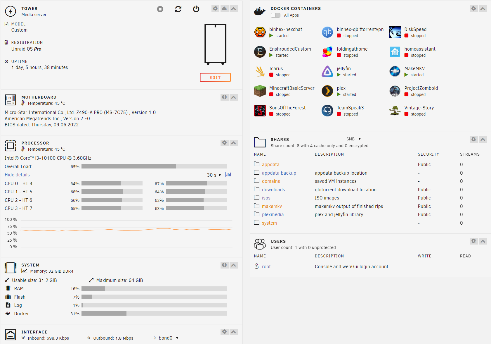

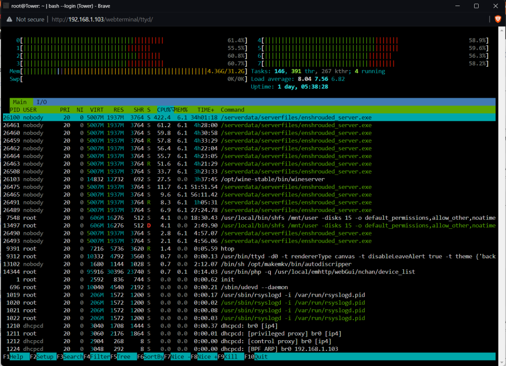

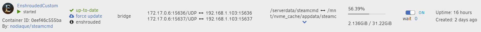

I'm going on a tangent here, but has anyone else noticed extremely high CPU usage when running this server? I have an i3 10100, nothing else is using significant amounts of power (plex, jellyfin, IRC client, qbitorrent, etc all barely use any CPU), and I'm reaching 10% CPU usage at idle, and 55-60% with just 3 players on the server. top/htop seems to confirm this isn't some IOwait "fake" CPU usage.
  1. Can anyone else confirm this high CPU usage behaviour? That way I'll know if it's just me or a global issue.
  2. Is it the server app itself causing the CPU usage, or the Wine overhead? I have a dozen game servers running, many through Wine, and none go this high with so few players.
  3. Depending on the cause of the issue, any idea if this can be fixed? It pretty much doubles my power consumption (45W -> 85W).
Seescreenshots for info.
Yeah the utilization is crazy. Almost tempted to load up pterodactyl and try the egg i found for Enshrouded running proton instead of wine.  Supposedly its much easier on the hardware. I cant get more than 2 people on this server without major lag.
From what I've read, the dedicated server stuff hasn't been optimized as yet by the DEVs
I don't have pterodactyl set up, so I'd be very interested to hear your results if you do test it!
It could help narrow down the performance issue to the server itself (if it's as much of a resource hog with Proton) or the Wine overhead (if it runs better with Proton).

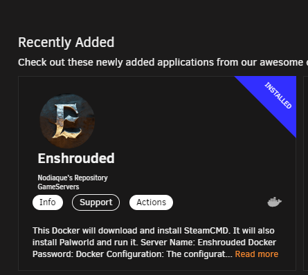

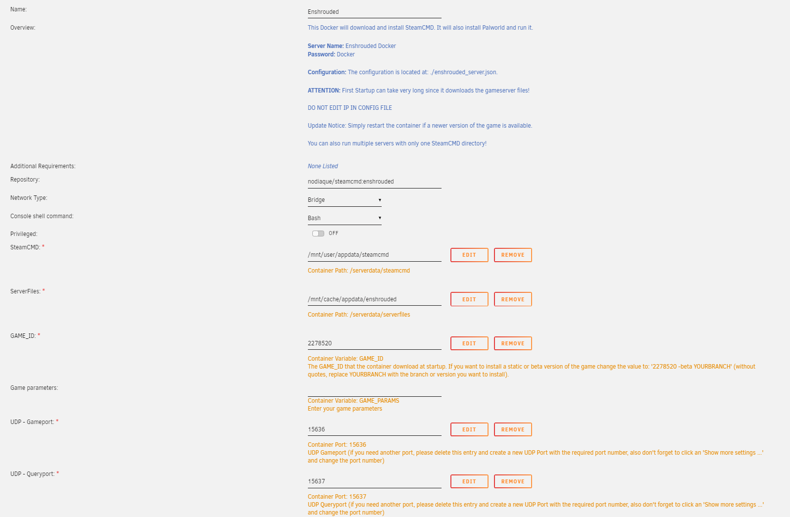

Imported the XML and just saw a minor typo at the top after you import the XML:
This Docker will download and install SteamCMD. It will also install Palworld and run it.
Sorry, I don't see the typo?

@Nodiaque It's a minor thing and maybe now that it's in C.A. it won't show anymore?  Right after creating the my-enshrouded.xml file and then importing off of github and then adding the container from the templates.  On that screen that follows it's right at the very top.  I should have taken a screenshot but I was so excited about finally getting it up and running that I just continued forward figuring that was a leftover remnant from a Palword game server docker template that must have been used to build this one.
Edited by CoZ
I mean, what is the typo? I've checked what you typed vs the xml and I don't see any difference.
@Nodiaque At least for me it's talking specifically about Palworld, where it should be talking about Enshrouded (or something more common)
OHHH!!! THat's the problem... I have both server setup in the same hours so I didn't catch that, that's what need to be fixed. Fixing it right now
Thank you for explaining it better than I did.  Sorry I couldn't elaborate more.  I was in the middle of finally getting Fiber internet installed.

On my side, i got the conf right. But can't find it either. I had to wait like 2 H then restarted the server. Now it's working fine. Well, beside the high CPU usage.

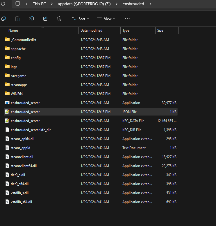

I went back and uninstalled and re--installed the docker. let the docker run for a few hours before i updated the .json and it seems to be still not connecting. is there any console commands i can use to confirm information.  screen shot of the docker install.
json is located at \\appdata\enshrouded\ .. i do see wine installed.
enshrouded_server.json Enshrouded Docker Logs.txt
