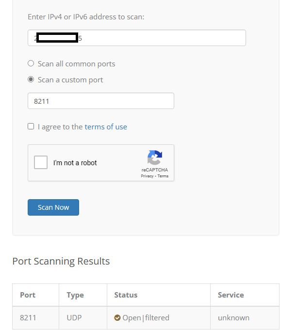

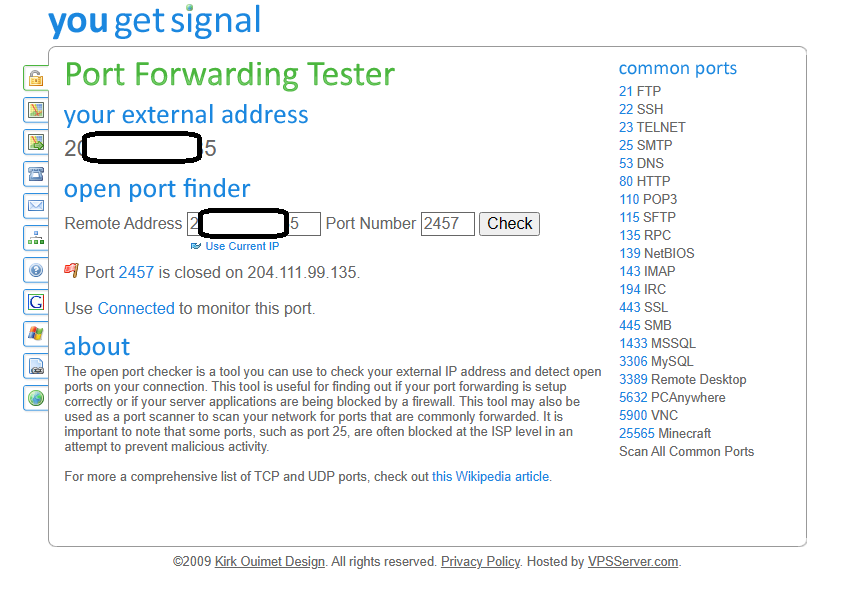

  5. Sorry for the delay was distracted by palworld.... but back to troubleshooting. here is a list of my ports. I am able to successfully ping my public ip address and ran some tests to see if any ports are blocked. I am not able to locate the server locally or public. I tried Bridge and Custom b0 with a an ip address 192.168.1 .181 as an example. I was able to configure a palworld server and connect to it. I feel Like I am missing something silly. configstore_log.txt connection_log.txt connection_log_15636.txt content_log.txt enshrouded_server.log service_log.txt systemaudiomanager.txt systemdisplaymanager.txt systemdockmanager.txt systemmanager.txt systemperfmanager.txt

  9. It looks like my isp had it locked out. contacted them and they have the ports open but they are going to provide me a dedicated ip address which should resolve the issue. I will follow up once all the updates have been made

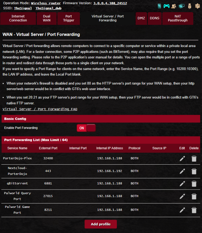

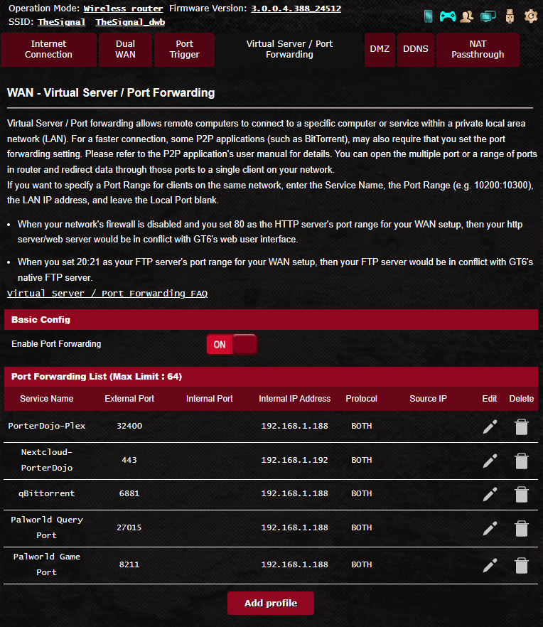

  10. I will be honest I am looking into Hair Pin NAT and I am not sure I know this process. I have an Asus GT6 on stock OS. I have not been able to connect to the container from outside my lan since I am a homebody. I have been able to confirm that my plex server is working.
  11. I do have it flagged as true for update public ip

  13. nubbz1992 changed their profile photo
