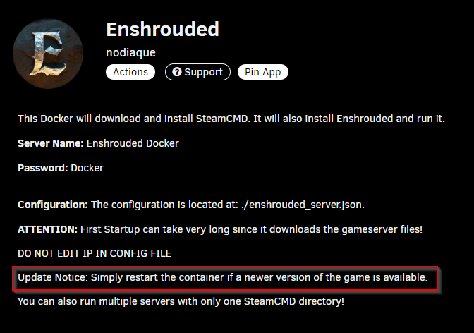

A new patch for the game was pushed out today.  I'm assuming a restart of the docker container will pull down the new patch and apply it automatically?

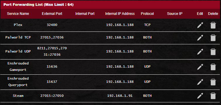

Sorry for the delay was distracted by palworld.... but back to troubleshooting.
here is a list of my ports. I am able to successfully ping my public ip address and ran some tests to see if any ports are blocked. I am not able to locate the server locally or public. I tried Bridge and Custom b0 with a an ip address 192.168.1 .181 as an example.  I was able to configure a palworld server and connect to it. I feel Like I am missing something silly.
configstore_log.txt connection_log.txt connection_log_15636.txt content_log.txt enshrouded_server.log service_log.txt systemaudiomanager.txt systemdisplaymanager.txt systemdockmanager.txt systemmanager.txt systemperfmanager.txt
Update I am able to connect via steam settings>servers and direct connect with the custom bridge ip hopefully my homie can connect to me when i am logged in via friends and add it as a fave.

Hello everyone, I'm hosting a server for myself and my friends. We have the problem that you can't find the server, only I can find it in the server overview. But as soon as I join the server, they find the server. Does anyone have an idea or is there a suggested solution?
Server browser is depending on the game dev, I have no control over it. IF you can see them in steam server browser and can join, there's not much else that can be done.
In-Game server browser is still part of the EA. It has it's own quirk much like palworld and there's nothing we can do unfortunatly.
According to your log, everything is running like it should. In fact, you wouldn't have an enshrouded_server.log if the server wasn't running.

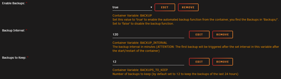

Update everyone.
Enshrouded container now support backup. It is not enable by default in the docker so if you just update the container without adding field in the template, backup won't work. I have updated the xml template if you want to update from CA directly and get the new template (there might be a slight delay before CA sees the update).
To enable, add the following 3 Variable:
BACKUP value true
BACKUP_INTERVAL value x in min (i.e. 120 for each 2 hours)
BACKUPS_TO_KEEP value x for number of backup to keep
In the log file, you will see this entry only if it's enabled:
You will also see a new folder called "Backups" with timestamped backup
Edited by Nodiaque
