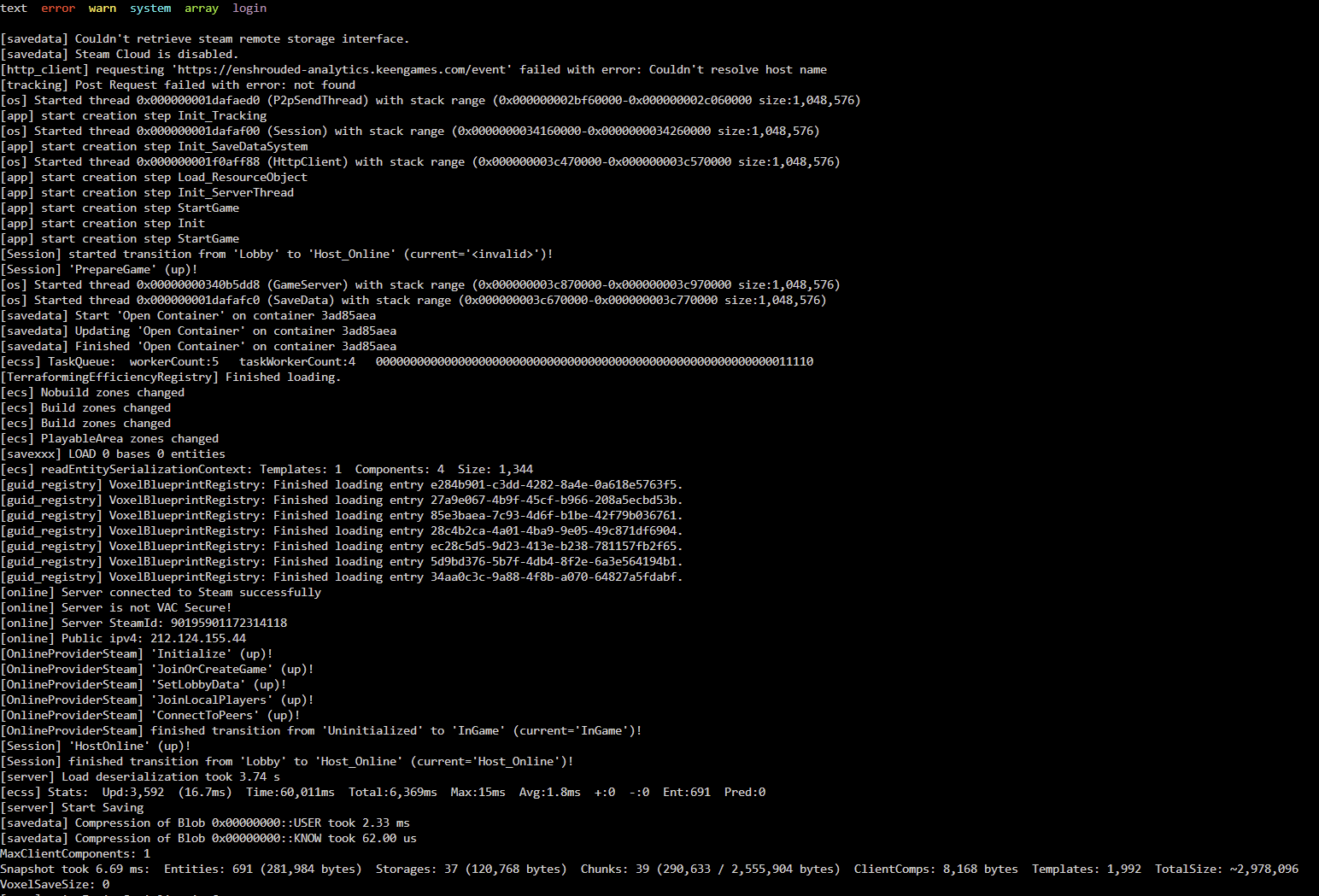

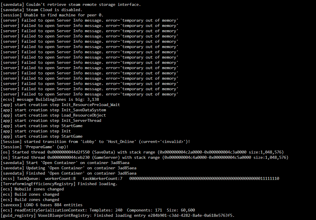

server crashed/restarted almost 10+ in 6 hours
says temporary out of memory but Enshourded server is only using 1.7gb ram out of 128GB available
I have
--oom-kill-disable
and
--restart=unless-stopped
as container parameters
16 Cores 32 threads 128Gb ram all for Enshrouded, nothing running on my unraid Except Enshrouded
here are some screenshots when it happens:
another one here too
I Have attached the log file too.
enshrouded_server_2024-03-09T19-02-15.log
Edited by Kesra
I honestly never saw that. Could it be out of memory from docker itself? Do you see something else like docker image full? Maybe corrupted memory? Could also have corrupted data, maybe try saving your data and starting from scratch. Just some idea to see if it help. Didn't get any other report about that
