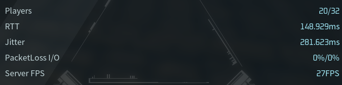

  3. @Nodiaque server crashed/restarted almost 10+ in 6 hours says temporary out of memory but Enshourded server is only using 1.7gb ram out of 128GB available I have --oom-kill-disable and --restart=unless-stopped as container parameters 16 Cores 32 threads 128Gb ram all for Enshrouded, nothing running on my unraid Except Enshrouded here are some screenshots when it happens: another one here too I Have attached the log file too. enshrouded_server_2024-03-09T19-02-15.log

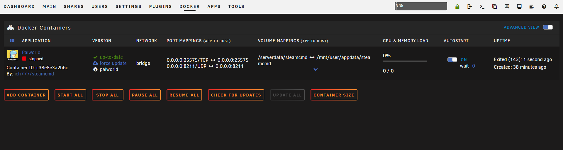

  15. I am having a very stressful day trying to figure out the issue here, my server keeps crashing like 10 times a day maybe even more, with those With those paths in an unraid server very weird and I cant just fine the issue.. server didn't crash down all the palboxes that belonged to people just disappeared here what GPT4 answered after analyzing the crashlog: The crash is caused by a "Segmentation fault" (signal 11). This typically occurs when a program tries to access memory that it's not allowed to, which could be due to a bug like a null pointer dereference, buffer overflow, or incorrect memory handling. The call stack in the crash report can help identify the specific code causing the issue. CrashContext.runtime-xml

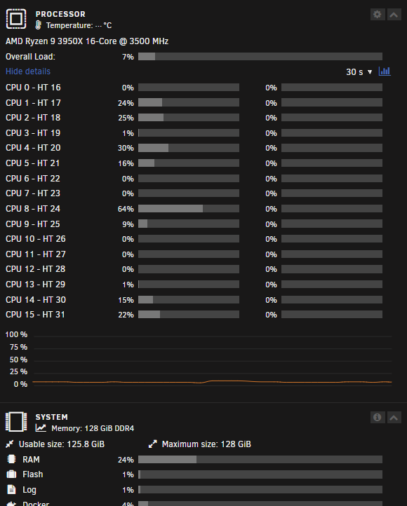

  16. @ich777 anyway around pushing the palworld docker container to use all cores and threads simultaneously instead of only 4 ? I got all these threads only for palworld later I got surprised that people say that it only uses 4 here is my weird statistics:

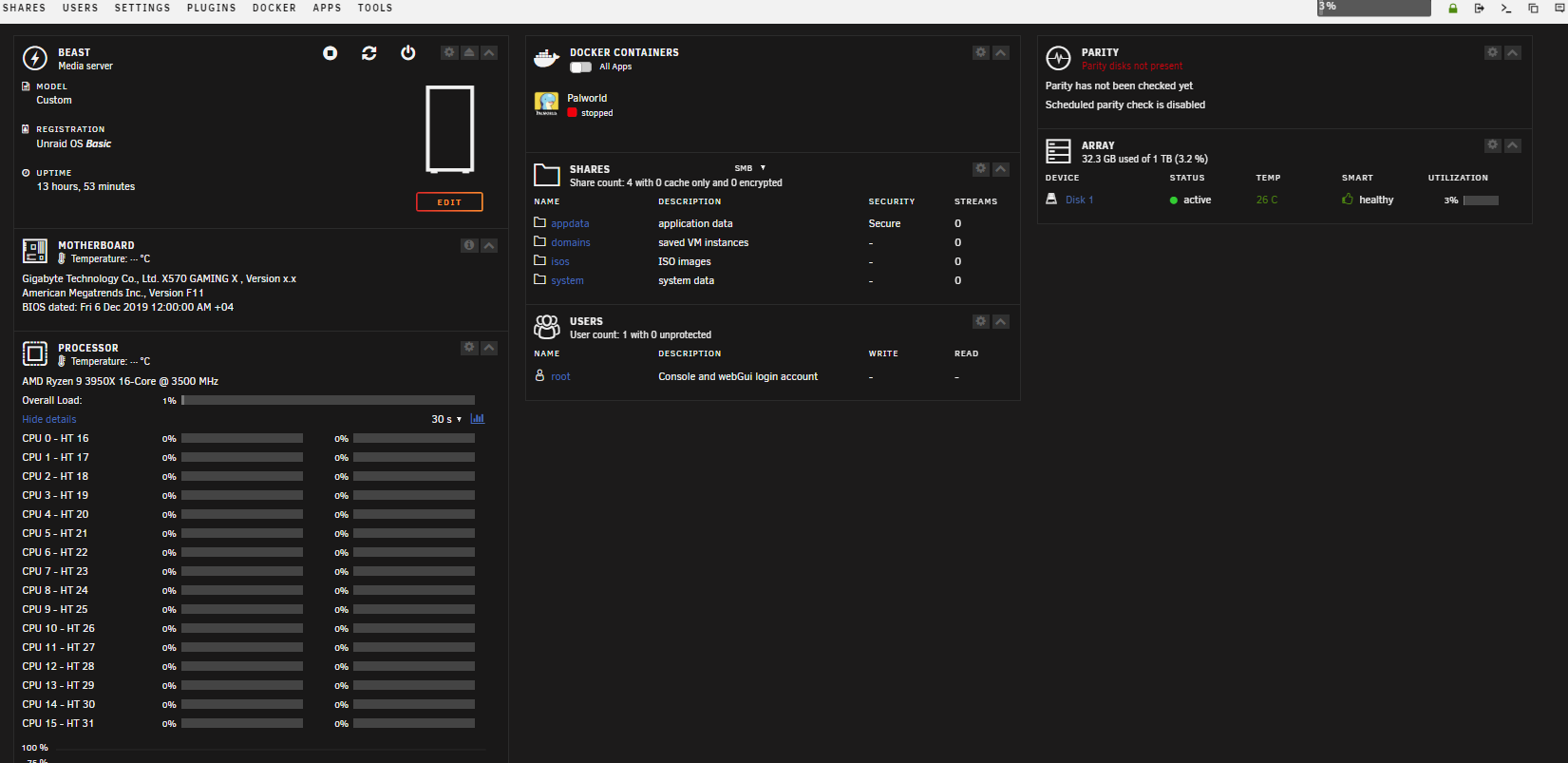

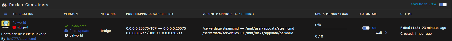

  19. I dont have cache. my new unraid is a 1 array 1TB SSD just for plaworld. My main unraid had so many issues crashes and resets, its follow me again in my new unraid just for palworld I am upgrading from 32 gbram to 128, but my main issue is that the back up proccess is hard as SMB wont let me extract or drop the backc up folders while I have all the permissions it says Access Denied
