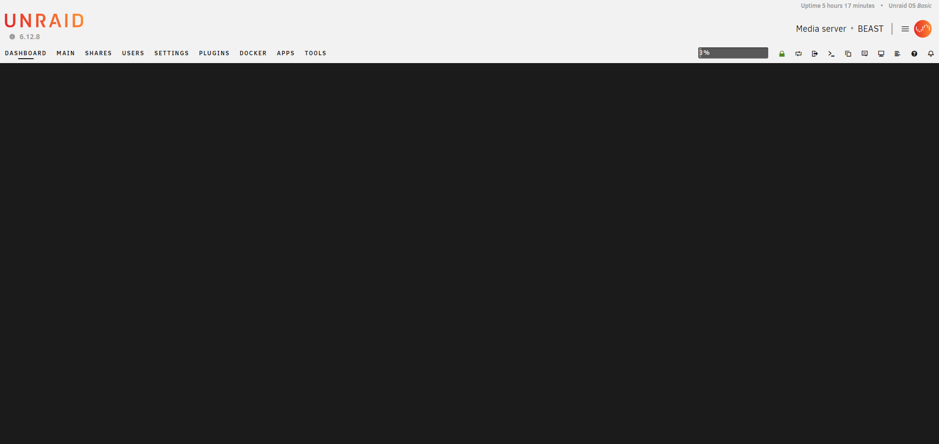

  1. yes the issue presist even in safe mode. sorry for the mistake in the original post I meant remotely. could it be that I am 2 Unraid servers ? both are to the same IP provided by ISP but they each have separate port...
  2. I have two unraid servers, Main and Secondary one, the main one is working flawlessly, the secondary server works okay and after couple of hours when I try to access it remotely it takes me to the page after login but all is blank, stays like this untill I restart: I run couple of game servers, both are working fine and people can access them outside and inside the network normally, but I can access any thing in the gui, stays just like that.

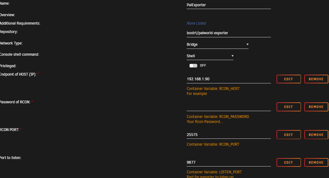

  6. I fixed instead of LISTEN_PORT to Container port, working fine now thanks @ich777
  7. I really dont understand why its doing this I copied your way exact
  8. wow really could you please tell me how you managed to install it and run it ?? pls @ich777 i spent 6 hours straight trying my head gonna blow up, you got it up and running in no time It shows me this but I am sure i installed it wrong way maybe:

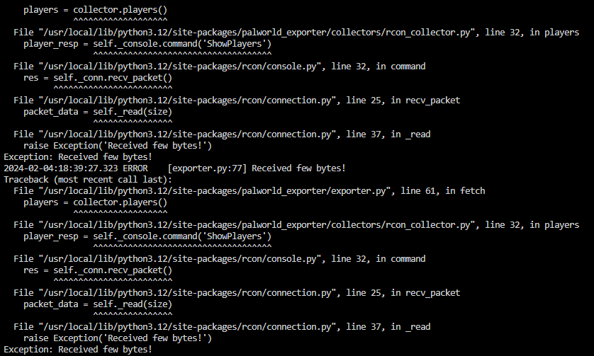

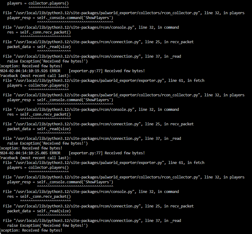

  9. connecting this https://github.com/palworldlol/palworld-exporter to server RCON Working absolutely fine
  10. I am already using RCON since server installed and the server is up too.
  11. I am trying to use https://github.com/palworldlol/palworld-exporter cant make the palworld-exporter to connect via rcon with "ich777/steamcmd:palworld" but it works fine with "thijsvanloef/palworld-server-docker:latest" so there might be some rcon flag difference in "ich777/steamcmd:palworld"
